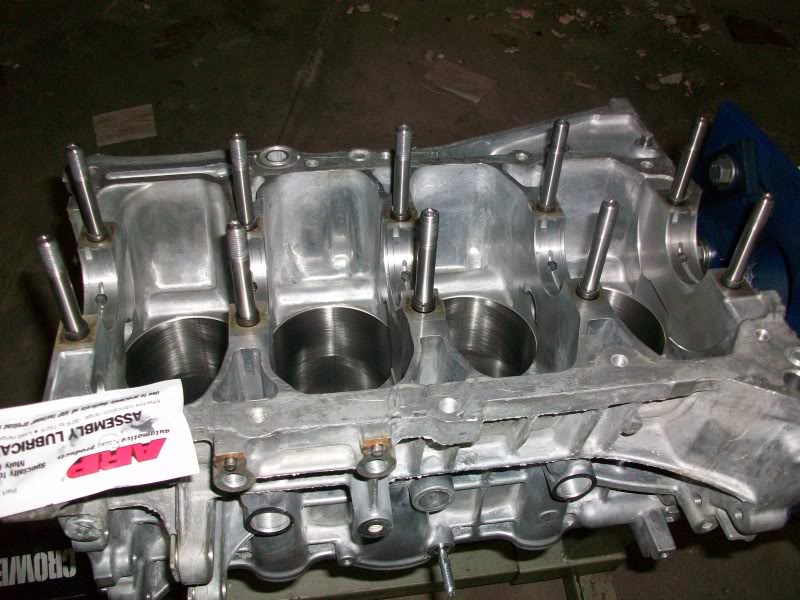

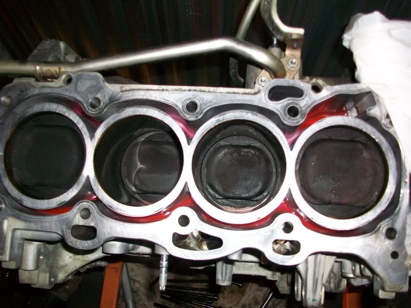

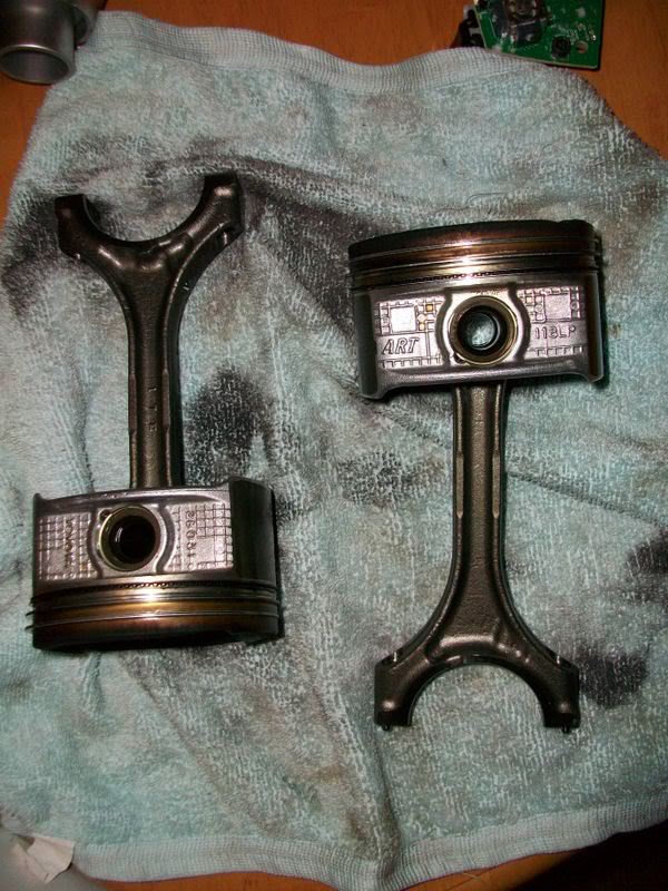

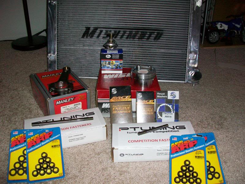

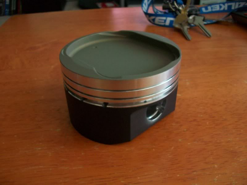

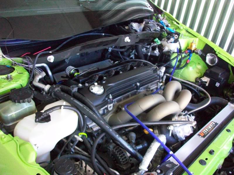

Hey everyone, As some of you know I've been building up my tC since Feb.
Well I didnt want the SL curse to get me which is why I kept quite but she started today so I'll share some pics and info with you guys
We'll start up the parts used....Wiseco 9.0 89mm pistons, Manley rods, ACL bearings, ARP studs....

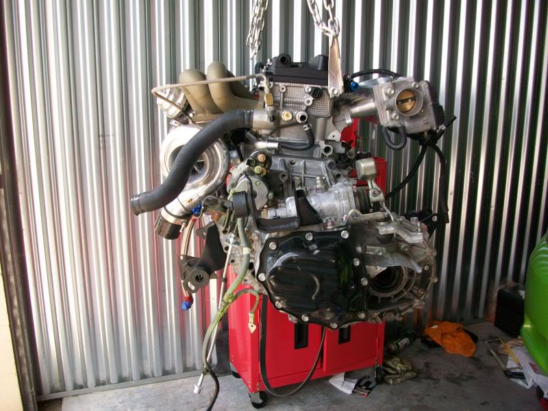

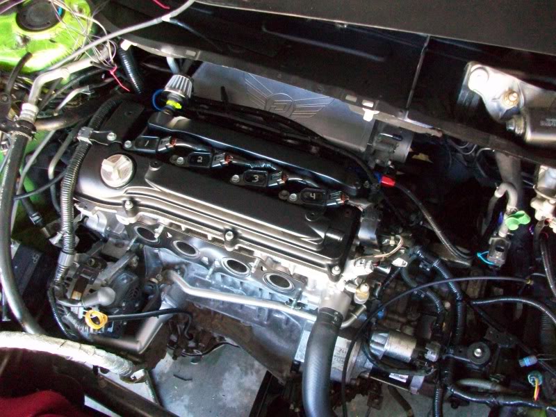

taking the motor out....

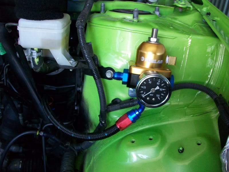

Fuelab Reg.

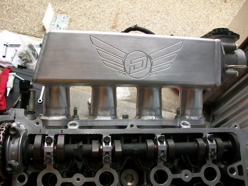

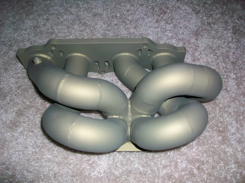

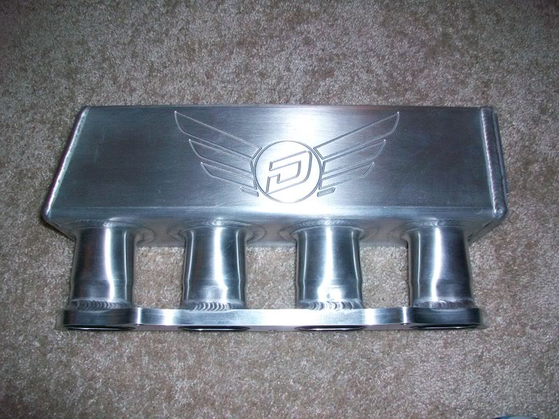

Fresh coat on the Manifold

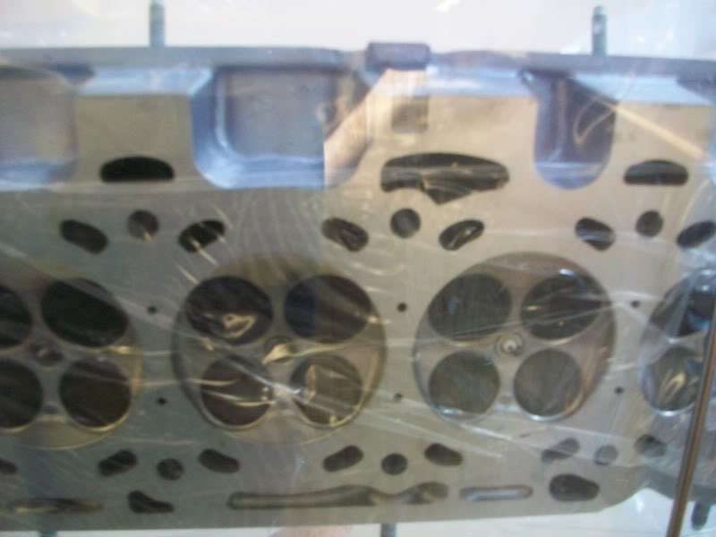

Head back from the machine shop for a clean...

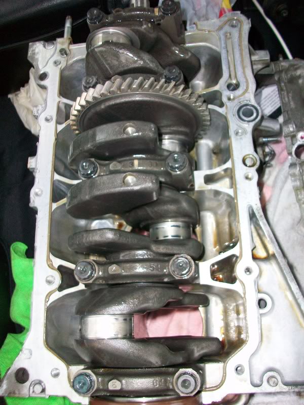

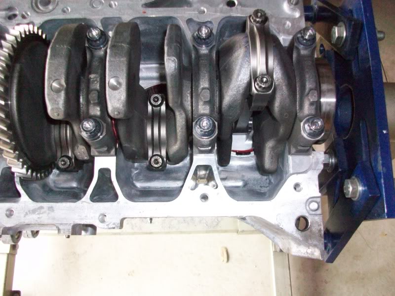

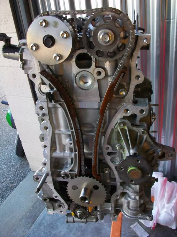

Motor back from mahcine shop....

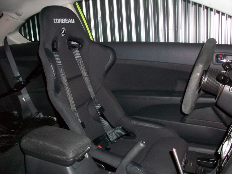

New seats....

i officially hate you! lol car looks great nad set up looks killer! man i should have gotten those manley rods! they looks like beast! your set up is reallly nice man! hope you man crazy power! i want to hear how those cams are! how come you got n/a cams and not the turbo ones? upload the video already jeez!

well i did the NA cams simple to avoid doing the whole head.....which at the time I didnt have the money for.
And I built it myself.
