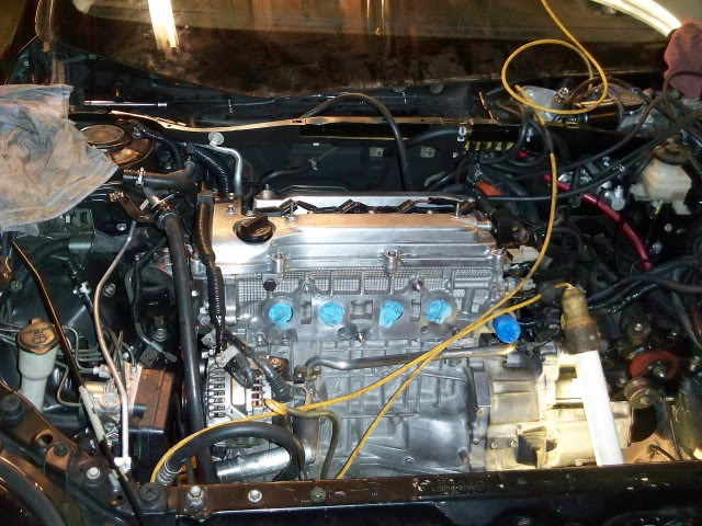

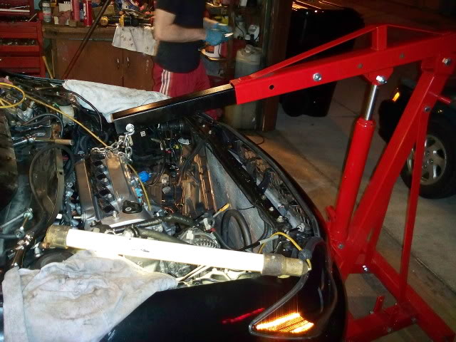

The engine lift with load balancer really helped when it came to maneuvering the engine around in the engine bay.

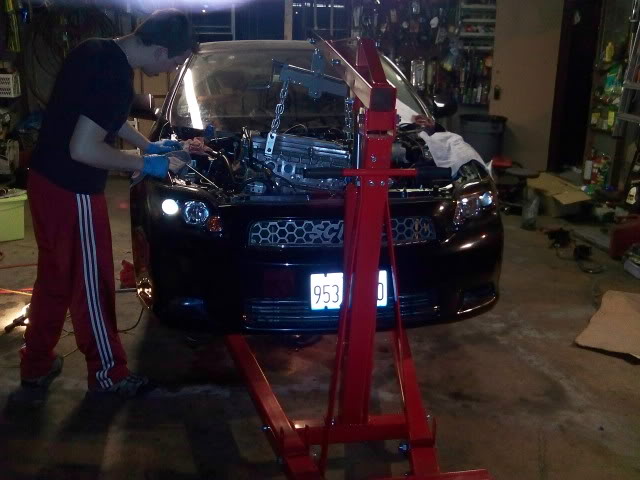

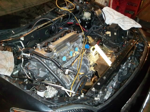

Worked on the car into the night for 2 days to get everything in, had a problem with remembering how the damn wiring harness went. The new engine already had some of the brackets on it, and i had the brackets from the old engine and it confused me.
Overall the install went well, didn't break anything! I did loose a bolt, but i picked up a spare at the dealership last week. Also, stock throwout bearing for the win!! My act bearing was making noise, even though it was only a month old, changed to stock and no more noise. The extended slave cylinder pushrod for the clutch is also very nice, no more clutch engaging at the floor.
