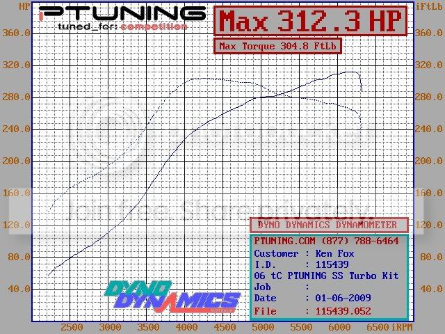

The numbers that i see above seem pretty accurate for 12.5 psi with the work done on the engine and using the dyno you were on. The 460hp or whatever it was at 12.5 psi is a LONG shot. With the PTUNING turbo kit on a Dyno Dynamics dyno and a stock motor turned out 312WHP at 12psi.
Boost: 12 PSI
Fuel: 93 octane pump (No Water/Meth)
Dyno Dynamics WHP/TQ: 312.3 whp/ 304.8 ft/lb
~Dynojet WHP/TQ: 349.8 whp/ 341.4 ft/lb
~Dynpack WHP/TQ: 359.1 whp/ 350.5 ft/lb
I'm not douting the numbers i see above given the information i see. I just don't see how it's possible that you got around 460HP?

It was 426 BTW not 460. The motor isnt stock by anymeans either. The 60-1 is an efficent turbo as long as it is not on this Engine.
