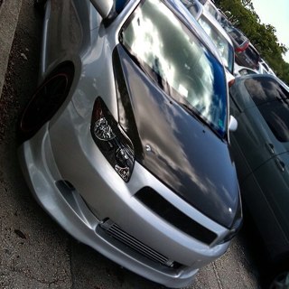

being certified at a facility with a chassis dyno means I've spent more time on one than you. for conversation purposes that is the closed position, moron. Just because the car doesn't have an IAC valve doesn't mean the plate is even open enough for you fit your little wenis in there. They are designed to seep air around the plate at idle, that's why you have to make sure there's no carbon build up on there. What's sad is you have 3k + posts, really dude? get a life. I'd imagine trying to match wits with a post ***** like you is about like beating my head against the wall. Enjoy your cyberlife, I'll stick to getting more education and not dealing with the true ignorant people such as yourself who have never actually gotten any real education dealing with vehicles.
also your car looks ___ with that hood
Lol see did I hurt the little baby. Lol your right my ***** doesn't fit in the lil opening of the plate. Maybe yours does and that's sad. Lol ase certified is education? Are you serious you don't even need a diploma for that lmao. Damn I didn't even know I had that Many post but thanks for the information. Lol so cause I have post on here means I have no life lmao ok bud go study your oil change manuals and think it's a education poor guy. Lol ye my car looks ugly with a carbon fiber hood. Your right silly me. So since you work in a dyno facility your ase ertified for timig is why your dying hahahaha stfu you fail at life. Oh no wait you don't case yor ase certified. What a idiot. Oh no I dot have education cause I'm not ase certified hahahhaaha. Lol my cyberlife is great that's How I met your mom. Nice woman just a tad over weight. Please stfu already ad let blue_Tc_man have his thread back. I'm done talking to you cause obviously your to ignorant.

From: Miami
Your right so ugly. Silly me.
