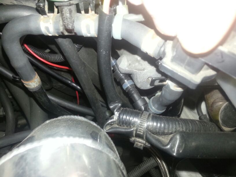

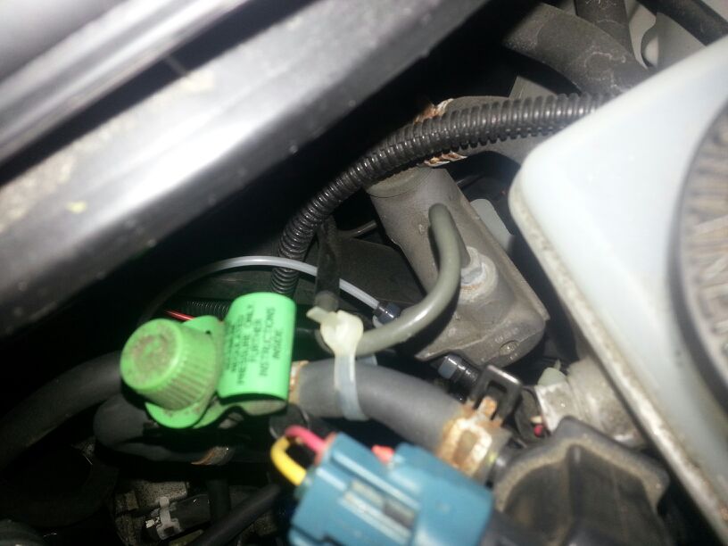

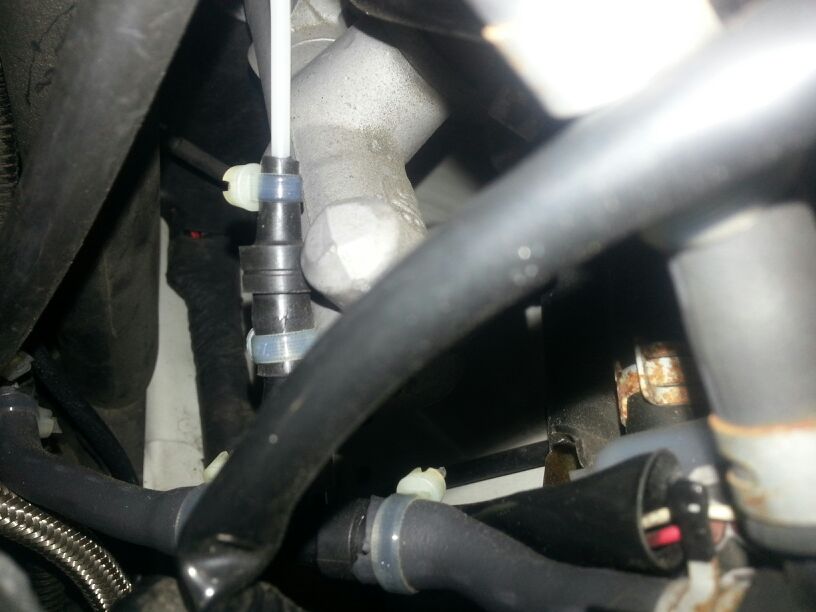

Here's a pic I seen this post a lil late I'll take a better one if you still need it. The t I got isn't good I have to look for a new one. And do you have a wideband??

oh ok, i see it now... no actually im trying to get a wideband because this was my first time actually buying a a/f ratio gauge so my friend said just get any but comes to find out i need a wideband instead of a narrowband.
did you connect your wideband yet? hows the reading on your boost gauge with that connection?
i read on a forum that we would get the best readings from the brake booster vacuum line (but not to sure yet)

I'm installing the bung for AFR today. And the readings are good on my boost gauge it reads the full 9psi.. But driving normal speed the neddle on the gauge kinda shakes a little but could just be my gauge. Its old lol

the place that you hooked up the vacuum line for the gauge seems to be upside down compare to mine or i am just not being able to find it lol
did you know that if your needle shakes that mean there is a chance of a vacuum leak some where. i happened to me several times.
the first time it happen was because of the connection to my gauge there was a leak and the second time it was the connection off of my
T... my vacuum line split causing my needle to jump and shake at normal driving....
oh yeah, for the T invest in a brass T, it tends to work a lot better and dont get all messed up like the plastic ones
and the third time was because my T was too big causing my needle to to go crazy
