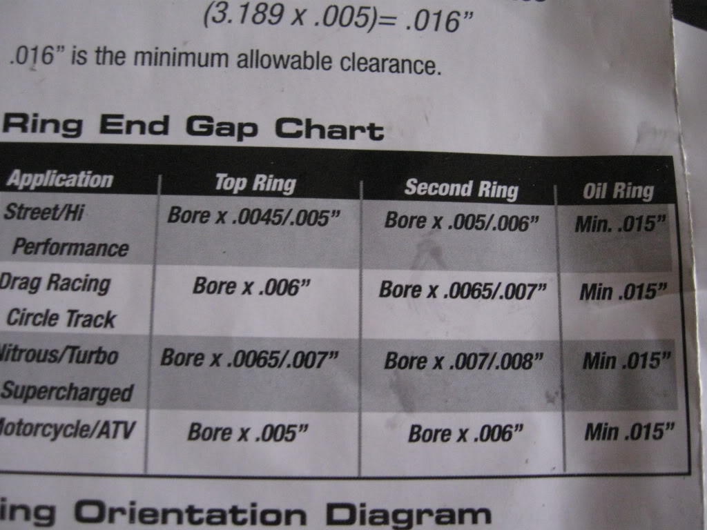

didnt feel like taking pics of the pistons installed in the block...lazy strikes again..lol
just for reference the reason i go with such a large ring gap...(im sure my post before about what i set the end gaps at caused some dialogue). Other pistons will vary.

What did you gap em at?
Old Jan 13, 2011 | 02:17 AM
  #2290
crush02342002's Avatar
Posts: 11,271
same spec as i set yours at
Old Jan 13, 2011 | 02:18 AM
  #2291
Posts: 11,271
black jack on the top comp ring
25 on the second
oil rings were good

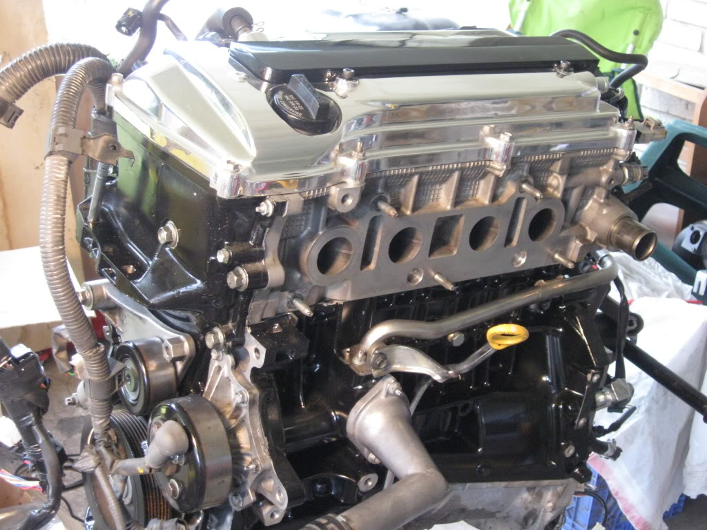

well the engine is almost all togather...Iv had to rush things a bit...upcomeing projects along with my HOA being d-bags iv had to skip things i really wanted to do. Ill have some pics in tha morn.
Old Jan 17, 2011 | 06:29 PM
  #2295
Posts: 11,271
as promised...though a little late...oh well...enjoy
I wanted to paint the whole engine and not just the block and timeing cover but of course poop happens when your rushed. I didnt even get a chance to degrease the upper oil pan or the head. I did however clean the combustion chamber. May try to install this week...not sure.

Shoulda brought it to my shop instead of dealing with them... Looks good either way, kinda reminds me of an old chevy with the parts being different colors. A redneck 4-banger.

btw kyle your right..it does look like ace...I wanted to do much better than this, hell i can do much better than this. It is what it is.

It doesn't look like le poop. Nobody will ever be able to deny that the engine was pulled and rebuilt though... Don't see many black engine tCs. Plus the VC is ****
