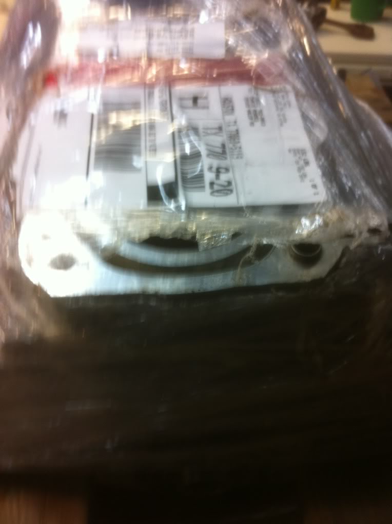

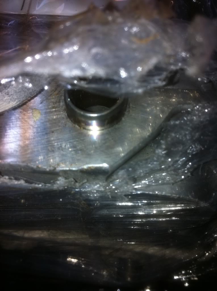

well I was going to do a diy engine pull and install but since this build has been such a fiasco I nixed that idea and just stay focused on the project at hand...to the owner I hope you dont mind I post these pics..I wont post up the vid or pics of the car itself without permission from the owner.
so here we go
ups fail #1 (or shipper fail if you ask ups...you be the judge)
the ding in the pic caused a raised edge on the deck surface .52mm high. to those who arnt up to date, the owner placed a claim with ups on the damage. Ups picked up the engine to inspect the damage, the next thing I know the engine is being shipped to Cali back to the og shipper and they denied the claim. Well the og shipper sent it back and this is the nice surprise I get (btw the shipper had ups package the engine this time)

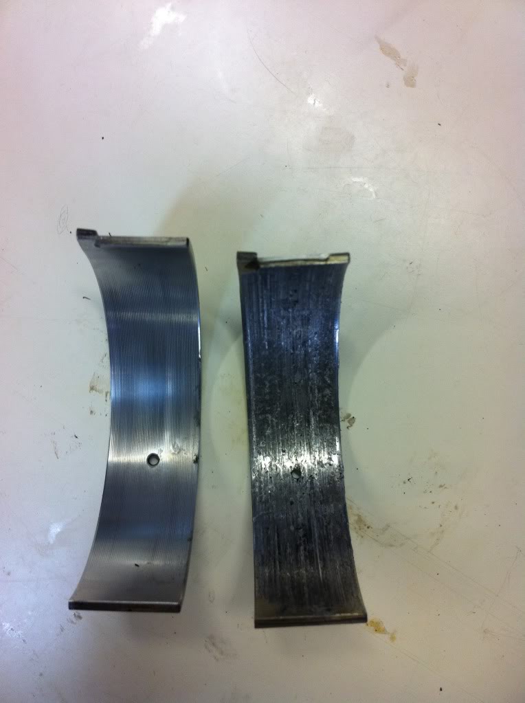

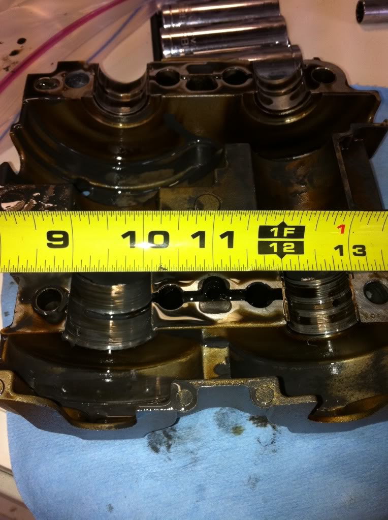

pics of old engine in all its glory (incase someone doesnt see what went wrong it was the balance shaft bearings went out...literally..they took a stroll out of there homes and into the bottom of the oil pan.
now all that metal "mud" ruined every single bearing in the engine along with some head damage.
bearing on the left shows normal wear on a similar engine...bearing on the right is from this engine
