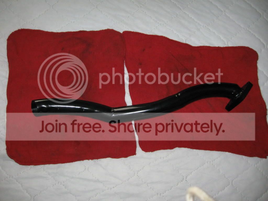

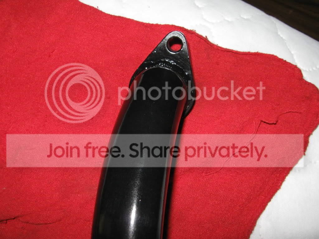

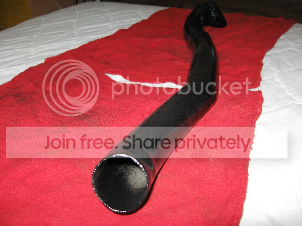

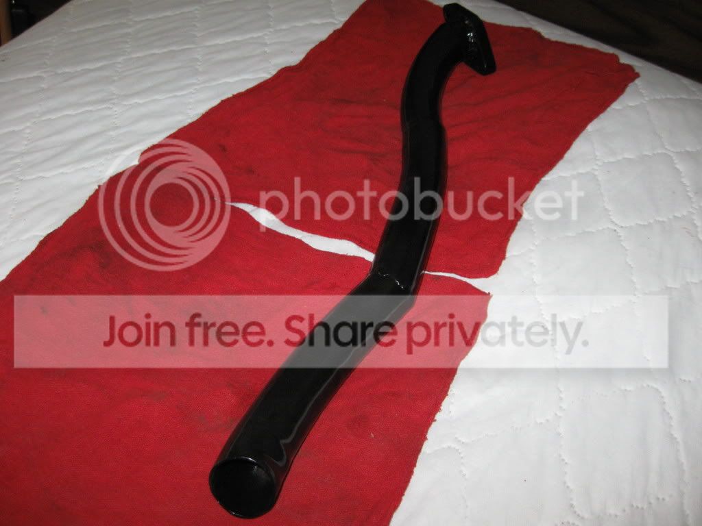

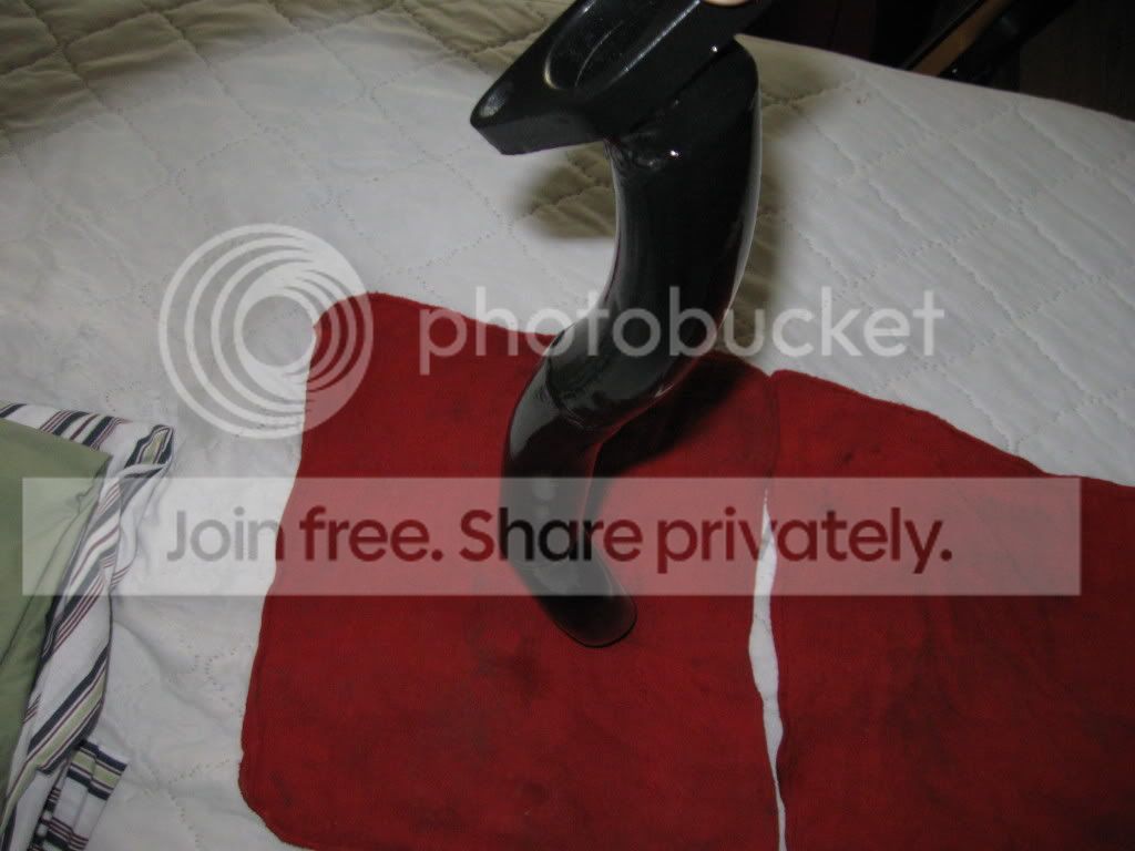

here it is (the java special)

btw its high temp engine enamel, not bad for a little rattle can action....

I wonder if that enamel, can contain some heat, similar to a ceramic coat (obviously not as well though)....???

I think the paint is rated 500C

the paint contains ceramic thats how it resists higher temps

they have 500f and 1500f paint to choose from, i used 500 on mine and seemed to hold up except for the fact that i forgot to sand the pipe and scuff it before i coated it so it chipped in one spot
i made sure though that i sanded the shiznit out of the one i made for cessblood and java.

500C is approx 932F, which is low EGTs like cruising around town on light throttle and being 7% at 45mph.

I see what your saying and i could be wrong on the temp but I dont think your going to see the same kinds of abuse on the dump tube as you would on the manifold. just checked the can i used and it just said 500f so its not 932f(which would most def be better) but i repainted mine AFTER sanding it first....lol and everythings good to go. Ill keep the peeps updated on that and if thers anyproblems ima switch to a higher temp paint.
hey paul im curious about dupli-colors 1500f exhaust paint and the hei 1500f high temp header paint, are they really good for exhaust? what i mean is will they hold up between say on a header for an n/a and the turbo mani on an f/i car. oh and what should i look for in a powder coater (not diy) to do my future projects.
Thanks paul for your imput its greatly appreciated!!!
so if anyone that has the dump that has problems let me know asap and ill fix it.

DEI makes a 2000 degree paint if your looking for higher temps the paint can handle
