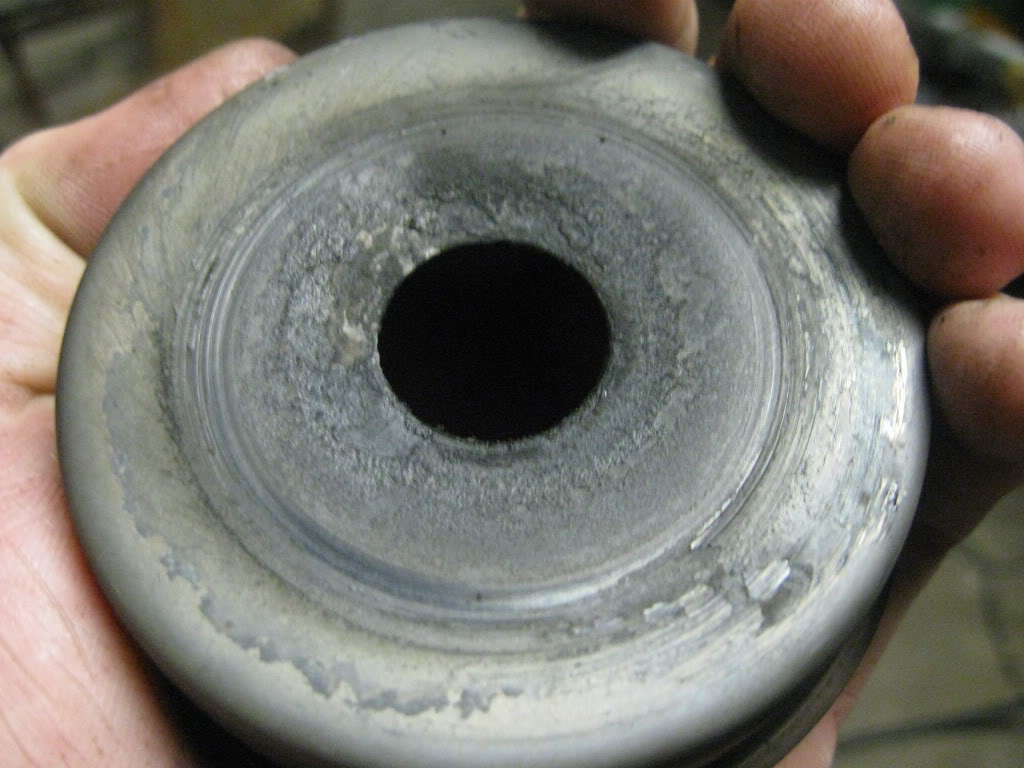

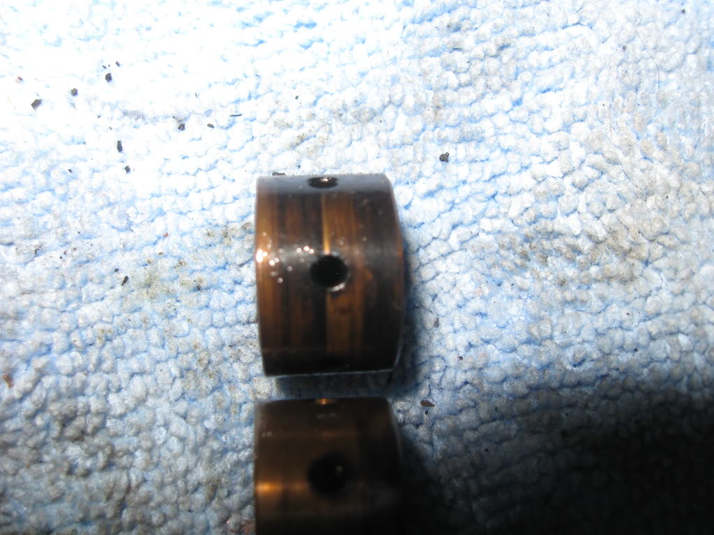

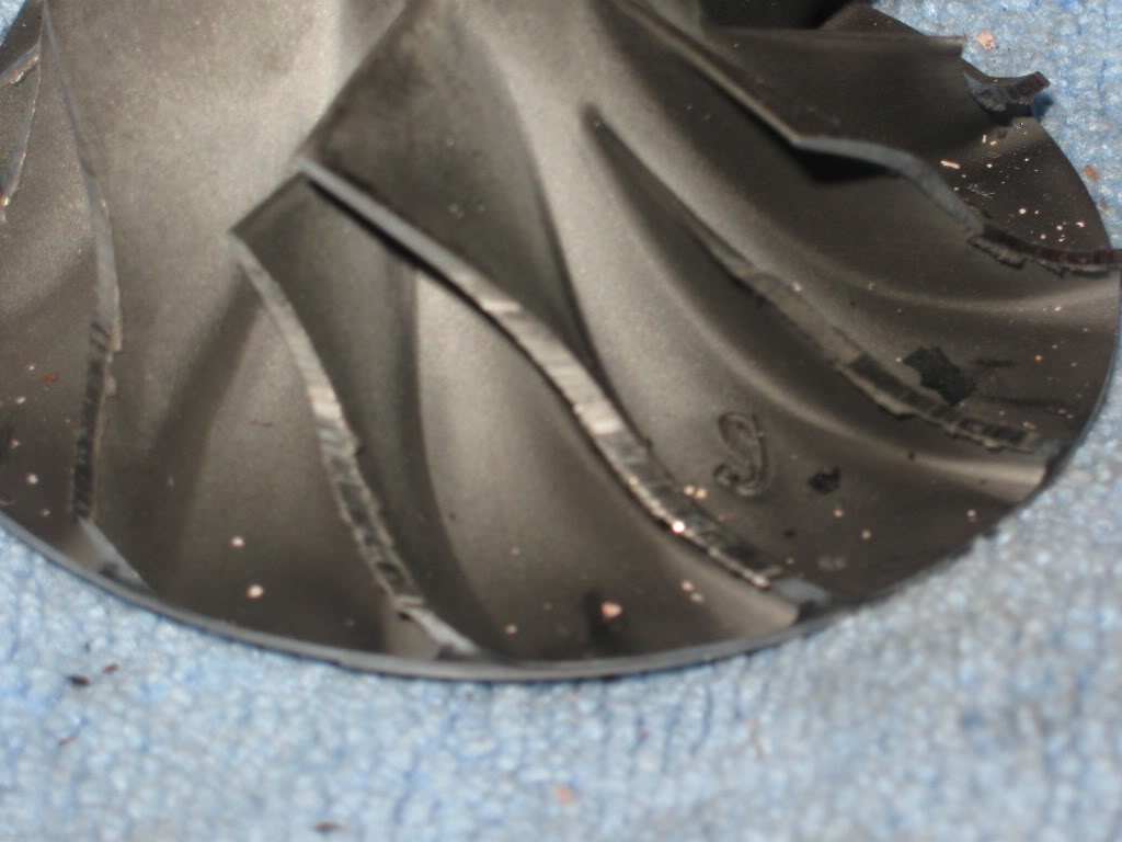

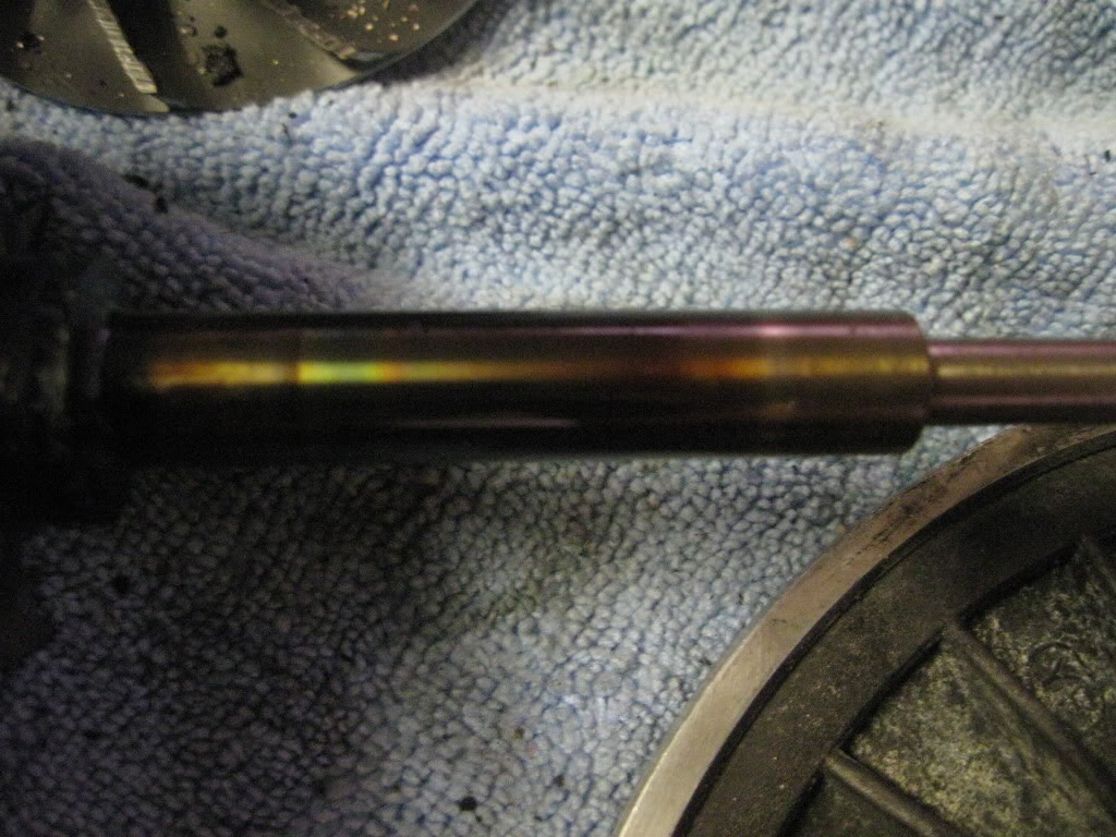

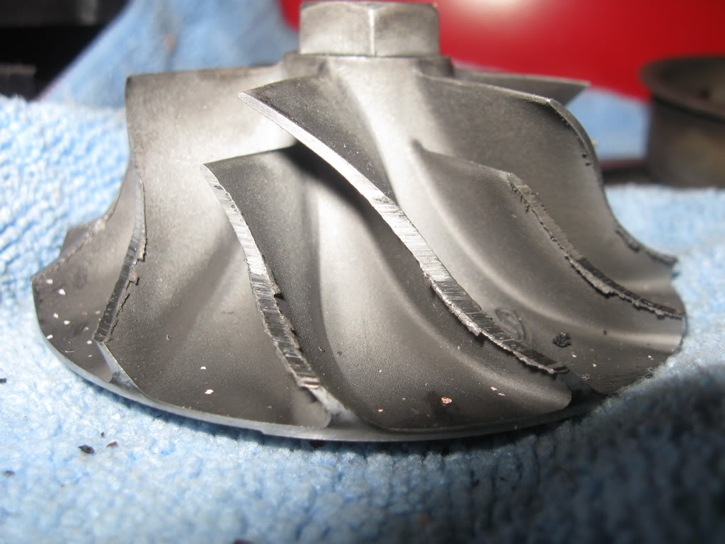

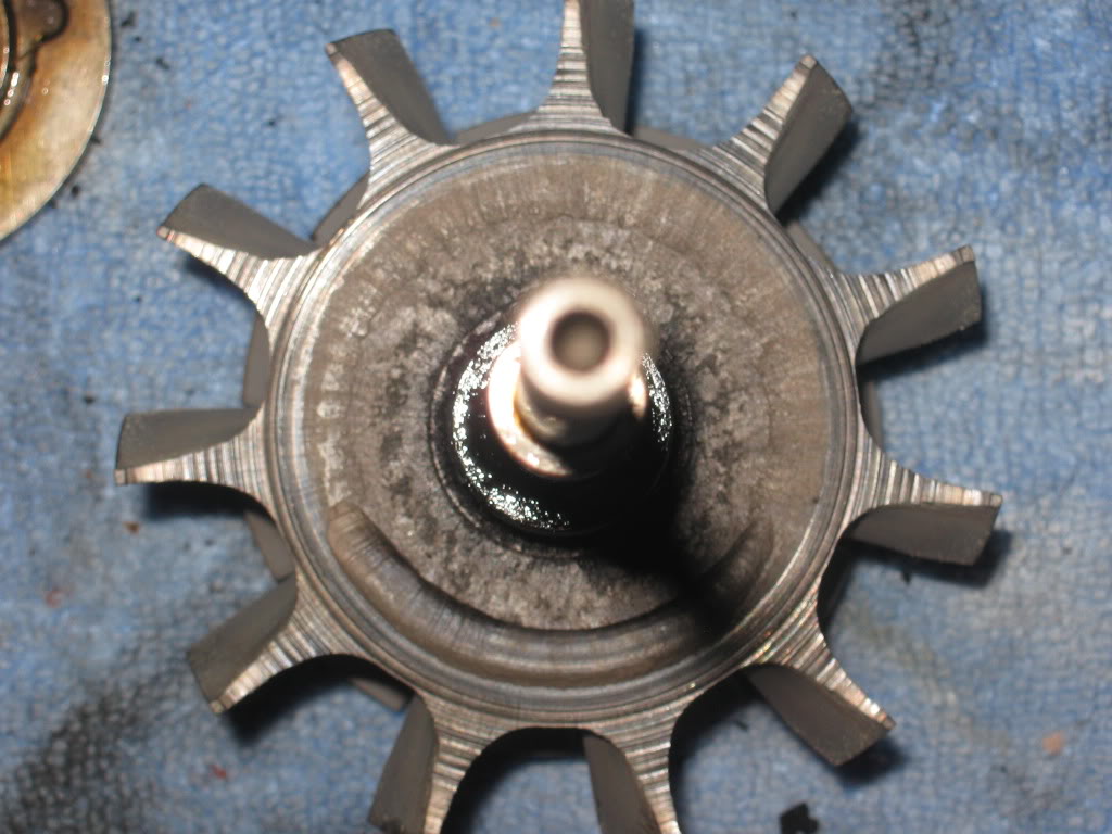

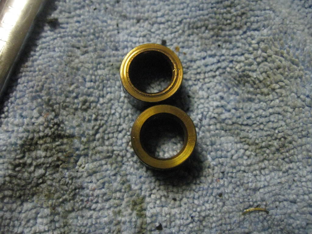

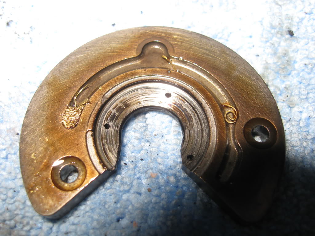

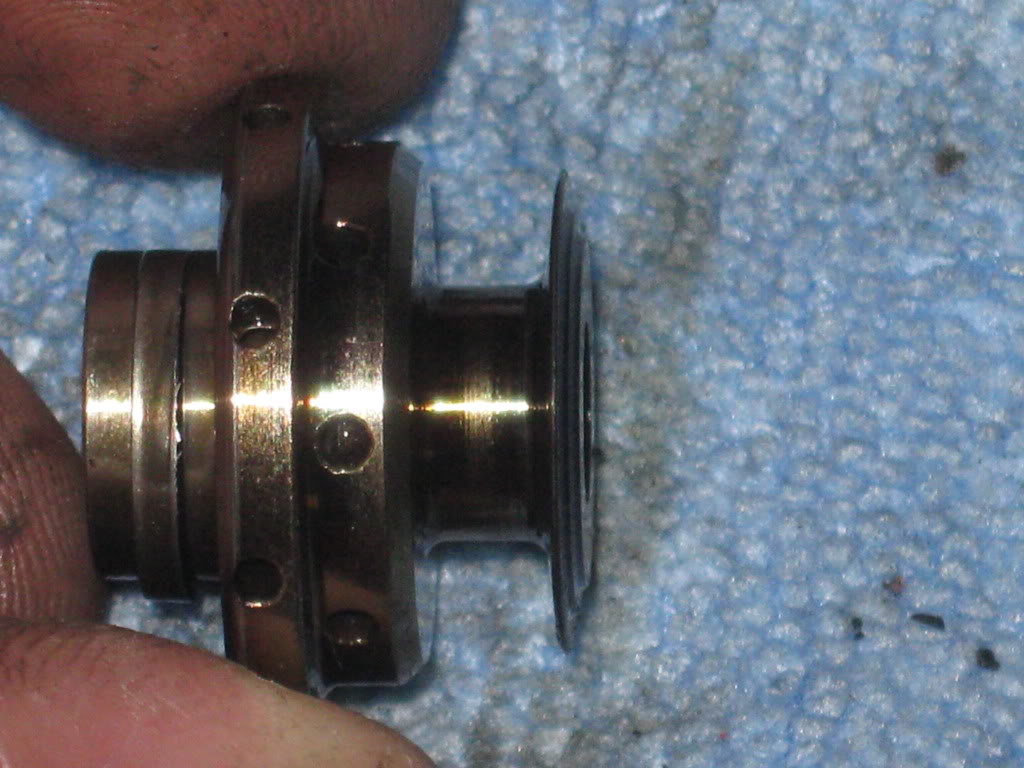

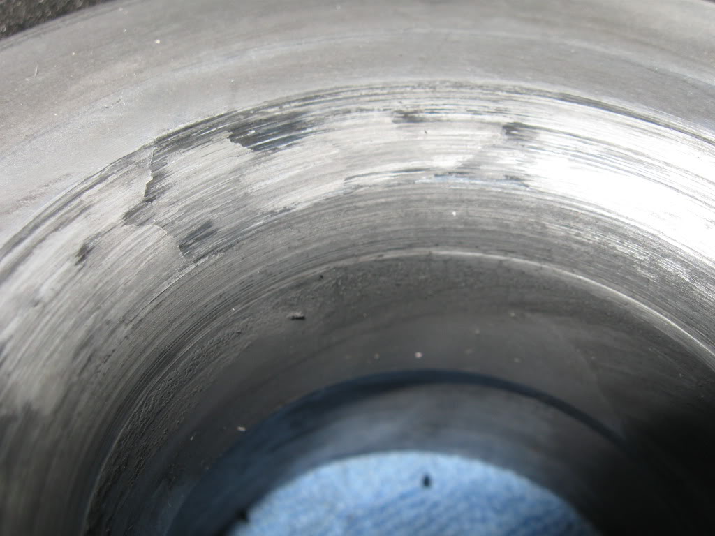

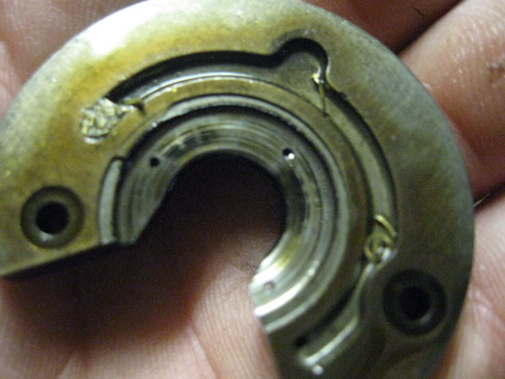

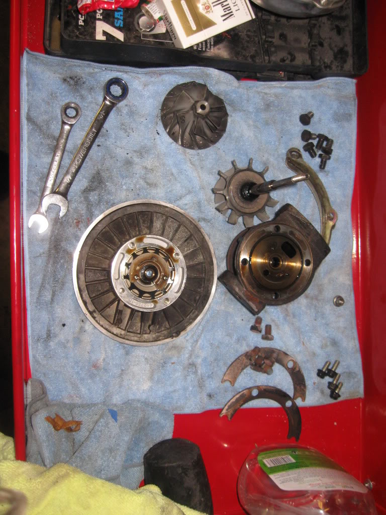

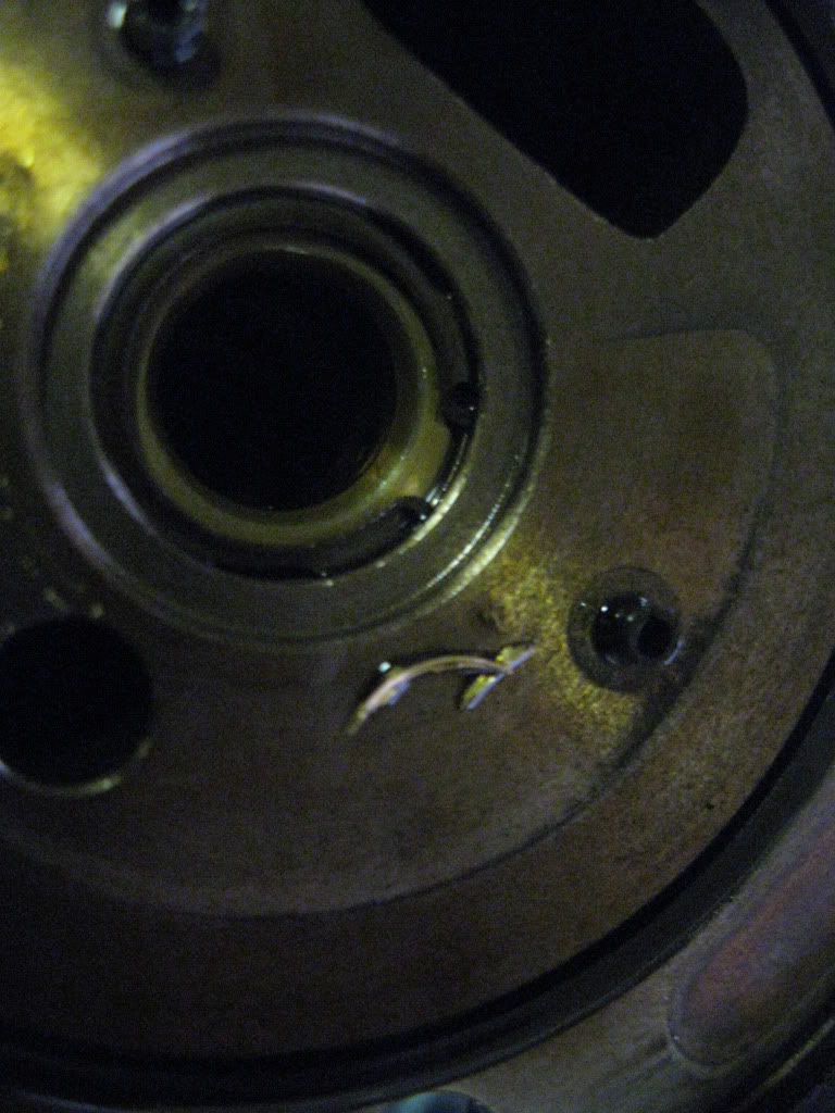

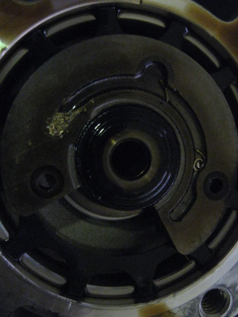

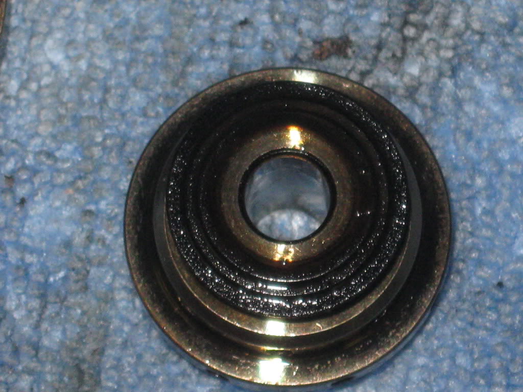

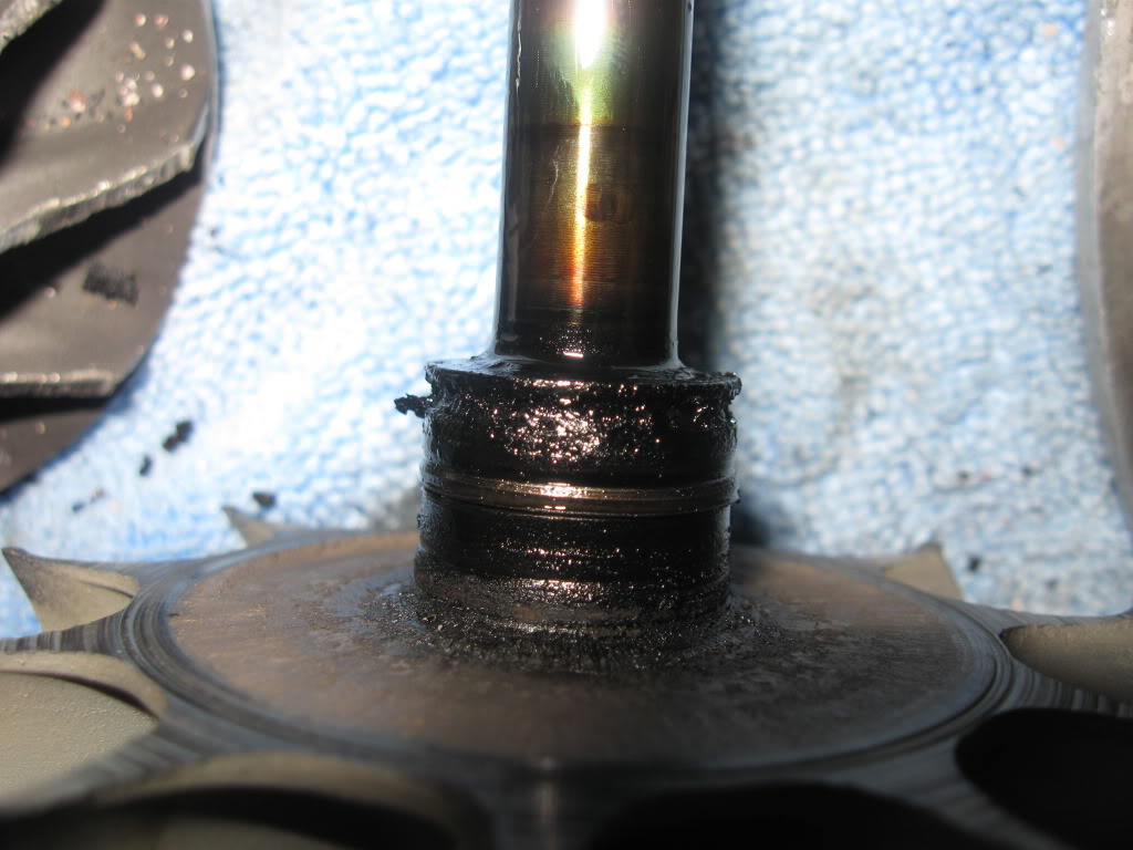

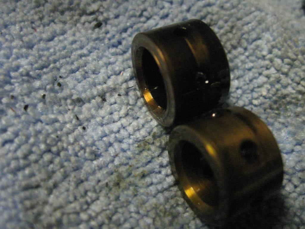

ok i take that back...the turbo i dont think is worth trying to rebuild, too much damage to the wheels and compressor housing. turbine housing is good to go though but its a .48 a/r so pretty much the only thing thats anygood is the center section. it ran too long with shaft play, it didnt have much vertical play but had alot of horizontal play which was jamming the compressor wheel into the cover and was eating away at the wheel. ill post pics in a min

thanks anyways curtis for taking the time and money to send it out to me, it was worth a shot.

anyways here are the pics

Old Jan 24, 2010 | 02:23 AM
  #1619
ecko04's Avatar
Posts: 2,243
From: Atlanta/Charlotte/Auburn
Yikes, I didn't think it was that bad. I never even noticed the blades at all. Oh well, I guess it was worth a try.
Old Jan 24, 2010 | 02:36 AM
  #1620
crush02342002's Avatar
Posts: 11,271
yeah it was worth taking a look atleast
