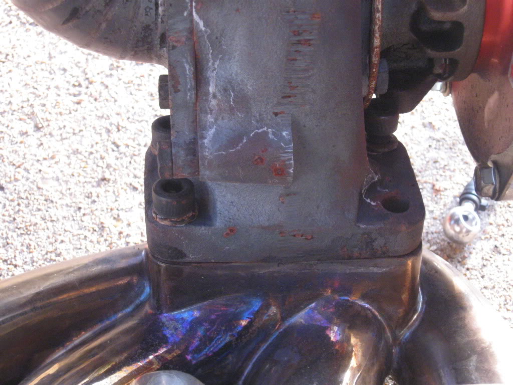

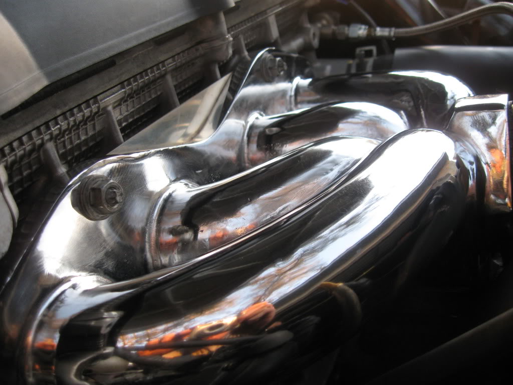

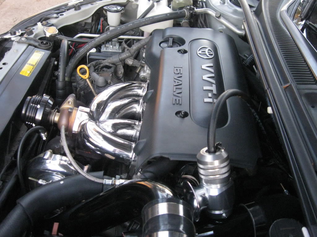

also have a customer that has the ss cast mani..
and it will discolor just like any other ss mani
(best shot i had of the mani before i repolished it)
its fairly easy to repolish, get mothers power cone and rubbing compound. unless the discoloration is pretty bad like in the pic then you want to start with barkeepers friend (cleaning powder much like comet) and the power cone.

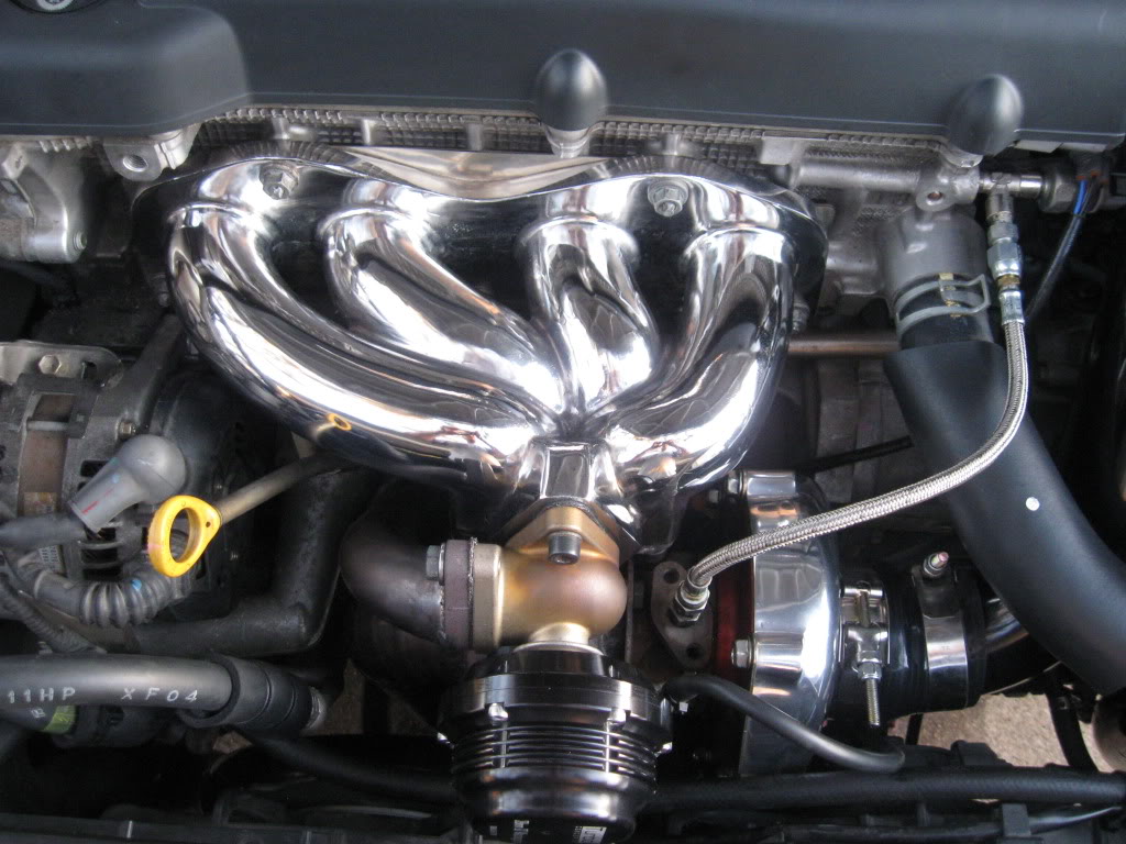

Well I just got my cast SS manifold today and I'm a little disappointed. The casting has a lot of small voids and the "polished" finish is only 1/2 done. It's still got lots of scratches, swirl marks, dull areas and the mounting holes are drilled for 10mm studs instead of the 8mm studs used in the head.
It doesn't look nearly as good as the photos Crush posted above. Is this normal or should I return it?

I got it from EMUSA. See the photo I added above. It's not horrible but I didn't expect to have to do so much polishing to make it look acceptable.
I checked turbochargers.com but they don't even have a photo of it. They do charge over $500 though vs the $260 I paid. Maybe they finish polishing it for the extra money?

idk...but your mani doesnt look that bad...just a little 2k grit and polishing compound you should be set.

Yeah, I guess you're right. It looks a lot worse up close than in the photo and similarly I imagine your customer's mani has flaws that don't show up in those low res photos. It is cast after all. I will say that the runners are a LOT smoother than the cast iron version. Thanks Crush.

yeah there are some dimples and flaws here and there, just look close enough and you can spot atleast 3 pits.
