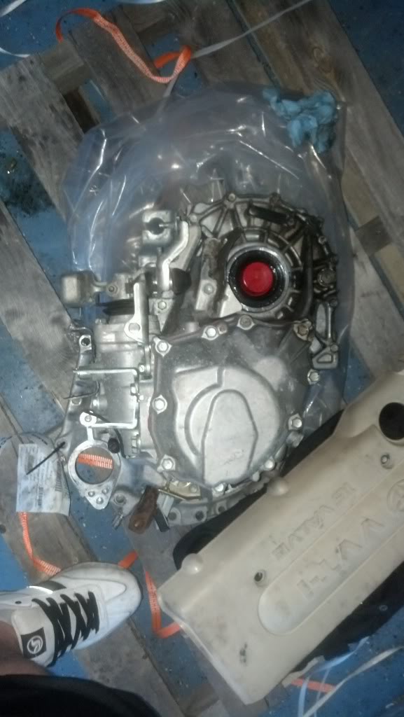

Is the back housing on that trans black stamped steel or cast aluminum like the rest of the trans? Every e351 ive ever seen its cast aluminum, every e350 ive ever seen its black stamped steel.
I'm going to have to double check but I'm pretty sure there identical the little components for shifting and the fork are a little different but that's it. I'll upload moar pictures

I bought a e351 transmission from a used auto parts place, it has e350(a)2 stamped on it. Best way to see what you have is just to google the vin number that's on the transmission housing. Mine ended up being just another tC transmission, I've been trying to get it straightened out with the place I ordered it from and its been 2 weeks now. (NEVER do business with General Auto Recycling out of rhode island) This is holding my build up. Good luck with yours
This is it. Hopefully.
Cant wait to finish this new build. I bought a motor mount and cherry picker off craigslist. I guess i'm going with one of Dezods pre-built engines. So i'll let you know how that goes.
