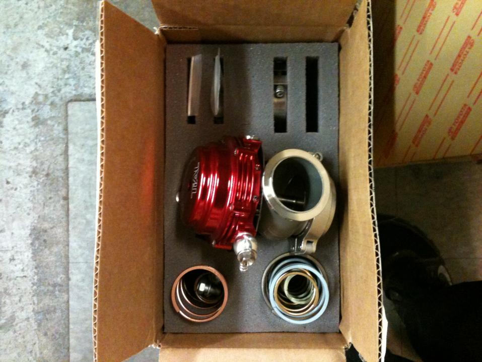

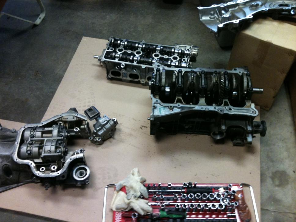

i know i still have a very long way to go but i figured ill start my new build thread a tad early. so here we go....
already in my possession
first is a boost flow t3/t4 manifold
precision 5431 t3/t4 (i may go bigger depending on finances during the build)
tial 44mm vband wastgate
im not 100% sure if im going to build my block myself or order a dezod short block but heres the plans if i build it myself
coming soon...
BLOCK:
08 camry block (needs to be machined so im prolly gonna go w 89-90 mm bore. it all depends on how much the cylinders need to be machined)
wiseco 9:1 pistons
wiseco rings
wiseco wrist pins
k1 h-beam rods
acl main bearings & thrust bearing
arp main studs
arp head studs
HEAD:
BC stage 2 turbo cams
REV valve guides
BC valve springs & retainers
REV +1mm intake & exhaust valves
head will also be ported for optimal flow, as we all know this is crucial.
FUEL/MANAGEMENT:
DEZOD return fuel system
Injector Dynamics 1000cc injectors (may go smaller depending on how crazy i want to go)
(not sure if i wanna go full standalone or stay piggyback. this depends on my power goal)
DRIVETRAIN:
DEZOD SS clutch line
CLUTCH(still undecided as to which one to go with)
lightweight flywheel (still undecided as to which one to go with)
i do know that i still have a long road ahead of me, but isnt that the purpose of a build thread? these are the items that i have planned for the near future and they purchasing has already started. im not looking for rediculous power out of my tc as i still want to be able to get in and drive if a few times a week. my main thing is that i dont want to lose driveability and reliability, so this may limit me as far as my power goal, but who knows, i may change my mind while im in the process. most, if not, all parts will be ordered with Paul @ DEZOD with the exception of any oem parts. its gonna be a long road ahead but in the long run itll be worth it.
new pics will be added as the parts come in and progress is made.

now here is a question i have in regards to bearing clearances. ive noticed that the acl race bearings dont have different thicknesses on dezod's site. is there in fact diff clearances? there were no spun bearings in the block i have, so in turn the crank should be fine. also when doing the balance shaft delete, does the crank have to be balanced to the pistons and rods? imho i think they would have to be considering its being changed from factory size,tolerances and clearances.
Old Oct 26, 2011 | 05:24 PM
paul_dezod's Avatar
Scionetics
KAD
Posts: 11,936
From: Western NY
There are undersized bearings available however we do not recommend running them hence not selling them. Why? If the crank has to be cut enough to undersize the bearing, you're just asking for probs. Just get a new crank for a few extra bucks used.
The crank should ALWAYS be rebalanced after a new piston/rod combo is added.
