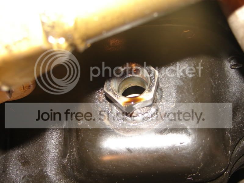

Originally Posted by BrownDogg
I took some pics outside when it was dark... hope this helps!
Hmm....My return line is larger than yours, and I have less wiggle room.

Pics of yours travis? And are you using the oil pan from zpi? It is also important that the fitting is tapped as high as possible to the oil pan for better drain and prevent back flow.. I just bought a pretapped zpi oil pan and it think its tapped in the middle, just wondering if its the same as your tap or if you had some issues

The pan that was on the car is the one that was tapped. I didn't buy an extra one or anything like that. My tap is "sorta" in the middle, but it's slightly above where "middle" is. Hard to tell from the camera angle.

That hole is mounted somewhat low. Do you get any smoke at idle or when the car is downhill? That's almost at the oil level line on level ground...
I would definitiely point the line straight in regardless. The 90 degree fitting will not work well for an oil return. Keep it as straight and as cold as possible.

^^I will take a side pic today to show a better view of where the tap is.
But to answer the question, I got smoke at idle every once in a blue moon, and only after oil changes.

I might just drive over to the Pull-a-part place and pick up another Oil pan, and have it re-tapped a little higher.

Yeah man I'd reccommend mounting the hole as high as possible. The cost of the oil pan is much less than a new turbo or a even a rebuild kit.
Royal Purple is the ISH! I love that stuff. I went from Mobile 1 full syn 10W-30 to the Royal Purple 10W-30 could actually hear a smoother running engine. I added the Royal Purple syncro shift and it helped a lot as well.
I can tell from that pic exactly how the hole is tapped. It's right up front which is great, as that's the best spot it could be. I would just get as close to that top lip as possible, as long as you can still thead it in and rotate it.
Let us know how it goes! Moving it will definitely fix that smoke problem.

Yeah, I switched from Mobile 1 to Royal Purple, but I'm running the 5w 30 RP stuff. I love it though. From research I found out that you should not only prime the turbo during a new turbine install, but after oil changes too. I never primed after oil changes, so I think that is what was causing my smoke after oil changes. It would go away after a while of driving after oil changes.
Hey, I pulled this pic off of Kaeon's DIY for the Stage 0. This is what my setup USE to look like, thus my tap is pretty much the same place. Same L (90 degree) fitting I ran.

Yeah it seemed about there.
I guess it's good you learned about priming the turbo, because that would also cause the problem. I think the tap is a little on the low side, but if it's not smoking then I guess you're fine. I wouldn't use the elbow though. Keeping the flow as smooth as possible will perform best. Every little bit counts!
