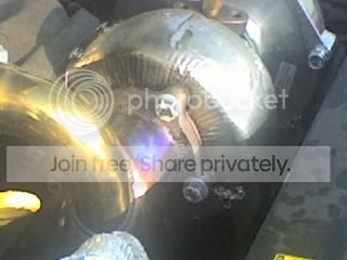

-Another problem is that exhaust is leaking on the turbo. It's hard to see in this pic, the leak near the center on the upper left.

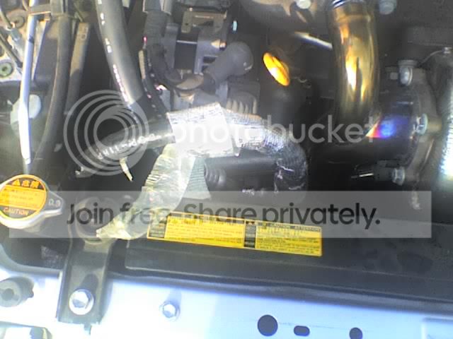

In This pic you can see that my heat tape has come off the ac line.. Again I wasnt the one who installed it.. But i'm working on getting some new tape from thermotec. Anyways the black exhaust smoke can be seen on the heat wrap of the turbine.

Common sense: You just need to retighten the bolts so the exhaust won't leak out. And the A/C line heat wrap, you need to put a wire around it at the end, twist the wire so it'll lock it in place.

For that exhaust leak I would take out the turbo and re-apply high temp silicone because it looks like you didnt get a good seal. The heat tape that came with the kit is cheap imo. Just get new tape. As for the white smoke, you may wanna do what Nu_ERA did and get a compression check. How hard did you push your motor for the first few 100 miles? I didnt hit boost for about the first 300miles, prolly even more. I'm close to 2,000 miles now with no problems.
