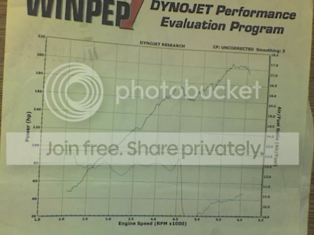

Here's a real rough photo of one dyno run i had to measure the air/fuel :
The X-axis is the rpm's measured from 1.5-6.5 in increments of 0.5
The left Y-axis is the HP measured from 20-220 in increments of 20
The right Y-axis is the Air/fuel Ratio from 10.0-18.0 in increments of 0.5

Yes you definately need to be retuned. This isn't what's affecting all your issues but it's still nice to do later.

It really seems that you have a leak somewhere after the maf. It looks like the car runs a bit lean while in vacuum, and then pig rich after a certain boost level, which would equate to air leaking out under boost after it has been metered by the maf. Retighten all clamps on the turbo piping. You could also try spraying a can of carb cleaner at every connection of the piping while the car is idleing. Listen for changes in idle. If you hear something then you likely have found a leak.
This is just my guess from seeing your afr's

that dyno looks a lot like mines too, where did you get dynoed at? Ill find my dyno real quick to compare, i think i got those numbers too...

I can't even tell what the numbers are... is that 220ish whp?

try 205 .. ouch

the car needs to be retuned - i small retune on something that already was tuned cost around $150 here. At that cost its worth spending to get the car to run better and prob gain another 40hp(ish).

Definately get a new tune, or send your Unichip back to Turbonetics and get a new one.. Call Reggie ASAP.

since you have a dyno i would call them and talk to whoever ...then ask what their email is and email them the dyno while you are on the phone w/ them so you have proof of a bad tune.. You spent $5k - either ask how they can make your day better or go to a shop and talk to guys that know their stuff. If you get it tuned on a dyno thats whats going to get yout he most power for your car setup ....but I dont know what your in the market for since you just put out a few $$ for the turbo setup.

For right now there are no cels. Basically the previous chart the air fuel is an issue, with stalling out.. After hitting the boost and pressing down the clutch the car may stall. On page 1 there is a picture of an exhuast leak on the turbo that is another issue but i'm not to sure that is really affecting the setup a great deal. Last issue was when it was smoking, but I havent noticed it recently, I check everytime i start the car. Then all I need is an oil change..
