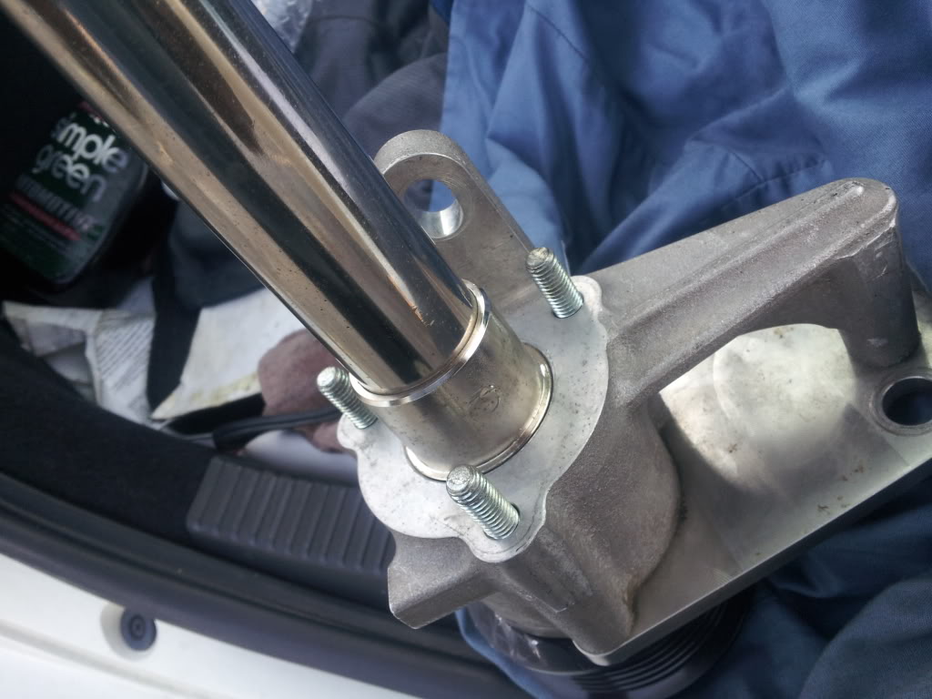

Some weeks ago I decided to do a s/c build. Well i got one for a good deal on CL. The guy i bought it from told me "has everything but some fittings". Well he lied.....and Idk where to find this stuff and toyota prices for stuff is silly. There is alot missing including whatever goes here.

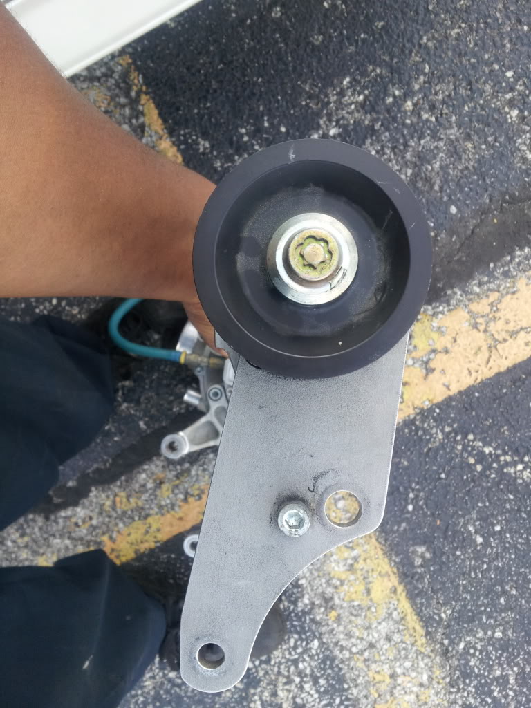

Im also missing the idler pulley mounted to the s/c bracket.

I have my old BPV I can sell u and the idler pulley hit up NST they made some for our s/c.

You are missing the horse shoe plate, you can just make one yourself that lines up with the bolt holes and holds the tube in place. Get some plate steel and a jigsaw with a steel blade and go to town. If you need I could trace the outline of my plate and send it to you.
For the idler pulley you could also get one from Vortech.

Looks like you're missing the bolt that sits between the shaft and the mounting plate. The bolt only comes out when you take the shaft cover off though, so I'm not sure if you did this, if so don't forget to put it back. It would be a PITA to take everything back apart for that one bolt.

Not true on my SC, I can take that bolt out without removing the shaft housing.
