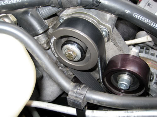

Here is a pic of the tools i use to remove the bolt.
I used: sandpaper, oil filter remover (the strap type) and my 1/2 inch belt remover to hold the pulley from spinning
(i don't recommend using the belt remover, because they are really weak, I broke 2 of them)
Now i got myself a nice 1/2 breaker bar .
Took me like 4 tries to loosen the bolt the first time,
When u install it, just warp the pulley the reverse direction.
done
