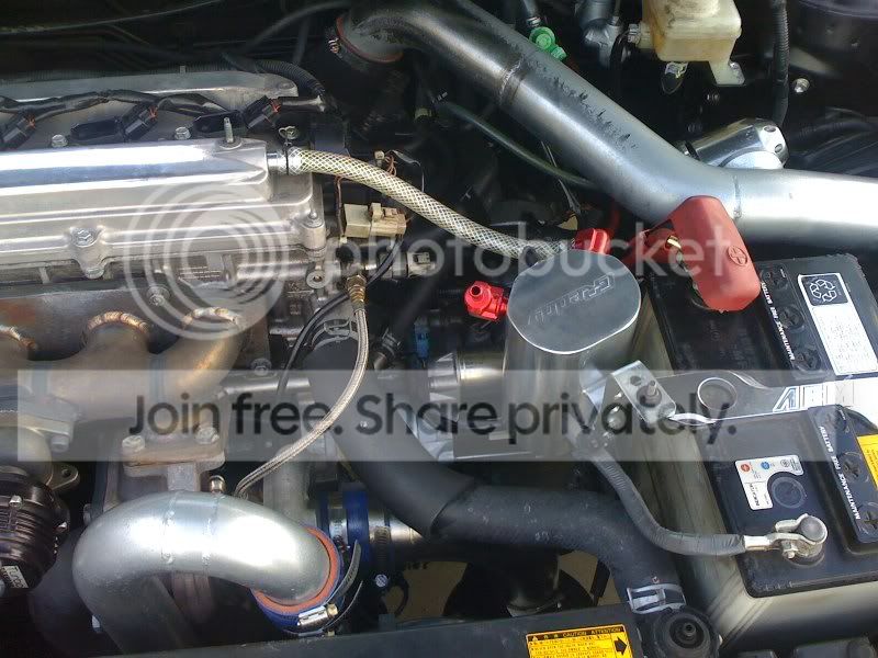

Ok, bought the oil catch tank, but I'm still getting oil coming out from the other side of tank. One of the tubes is connected to the PCV, but I'm not sure where the other hose should be connected to.
Also, how do I perform a Compression/leakdown test?

^^You know what, I was just about to do a DIY on how to do a Compression/Leakdown Test. I think I will do a video DIY on it, instead of write-up.
In the mean time, you can go buy a pressure tester ($30 at O'Riely's Autoparts).
PS.....Nice Catch can setup. Is that a 20G turbine?

Yep that's the 20G.
