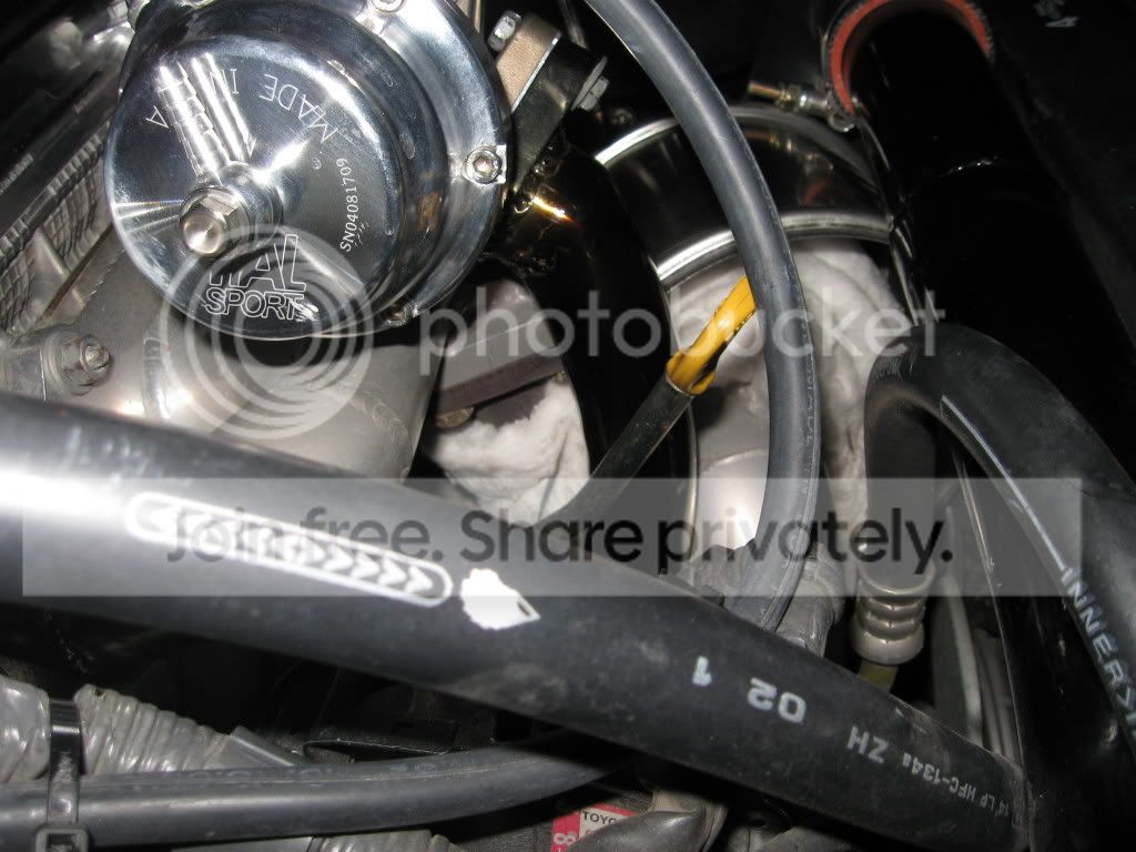

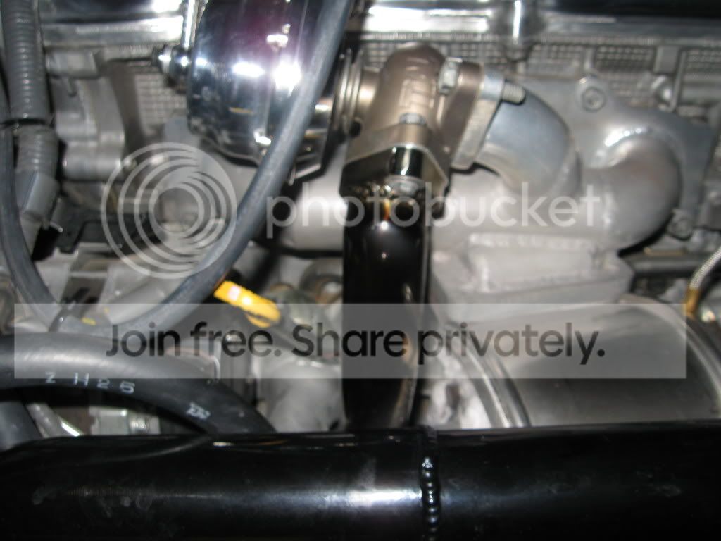

When your wrong your wrong and ima person that will admit it. I dont know if you remember but we had a discussion about painting dump tubes with 500f engine enamel, well today at the track i found out the truth...lol

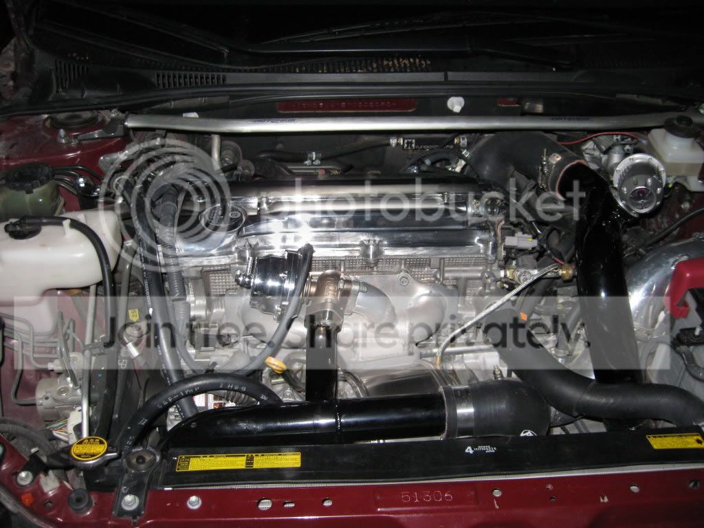

I recently painted my dumptube that i had fabbed a couple of months ago with 500f clear engine enamel. The first dumptube that i had made i painted it black and never noticed any issues with the paint (500f engine enamel), but after a few runs with the new dumptube freshly painted it turned a deep dark brown. Now it didnt crack, chip, or peal but it does look toasty...lol Now it didnt smoke or any smell what so ever and the paint surface is still real smooth but yeah it does look kinda burnt.
so Paul i concede
I made this thread to apologize and to warn any one from using 500f paint on anything that has exhoust gases going through it, at least dont use clear engine enamel

the point i was making before was that exhoust isnt constantly going through the dump tube, only momentarily while in boost. Hence the reason i thought you could get away with 500f paint. and yes i know that exhoust gases get hotter than that but i honestly didnt think that the dump tube would see those high temps long enough to do any harm to the paint. btw i had done it before but with black paint (500f) and nothing happend to the paint.

its funny how it looks more like the paint was "caramelized"
