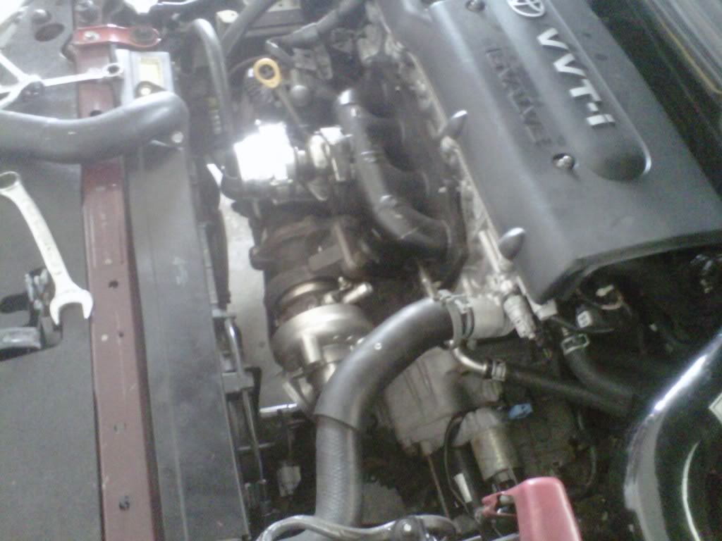

This was just the mock up, still trying to decide what i want to do with the hot side of the ic piping...i have a zpi mani, turbo toyotas ic piping, blouch 20gxt,cxracing intercooler, tial wg, Siemens 630cc injectors,hks ssqv,and a welded pan...not the complete set up yet still looking for an fic and a 05-06 pnp harness.Name:  IMG00068-20110409-1245.jpg

^^your turbo is clocked the wrong way. You have the oil return facing up.

i know. like i said it was for mock up and im tryin to figure out if i want to run the ic pipe up top like its clocked on the compressor side or if i want to re clock it and run down below and not have to worry about any custom fab. i was trying to see how it fit and just had it sitting that way when i snapped the pic

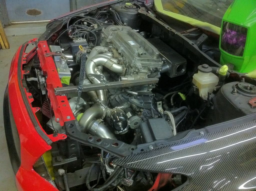

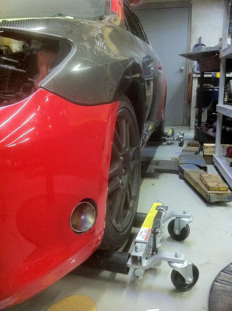

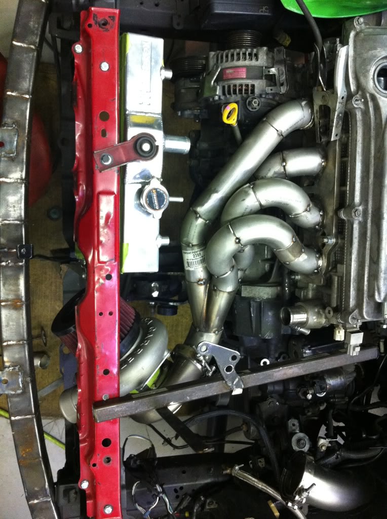

^^oh my. what a sick build. are those the regular or 10mm wider seibon fenders?

Thanks man it's a work in progress parts coming in one after another! And they are the 10mm wider and fit great! And the doors fit amazing as well

Where are you bracing that manifold?

There are some on it now these were befor all that one to the trans mount and another off the the trans an the exhaust is bolted to the frame with a flex pipe.
