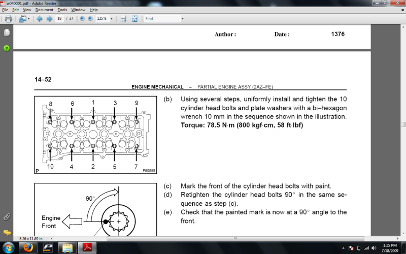

the arrows point toward the gears......the 12mm bolts are torqued to 22 FOOT lbs and the 10mm are torqued to 80 INCH pounds
head studs i torqued to 20, 40, 60.....ive been told to torque em to 80ft lbs though

If you have ARP, you do not follow the OE TQ specs. You follow ARP's specs that came with the studs
