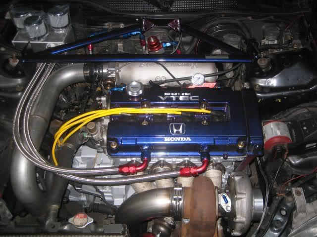

I see what your saying I like that vacuum idea alot and makes perfect sense. I planed on venting both like in the picture above to the atmosphere but I think I like the idea of putting it back into the charge pipe better due to the vacuum is better

If you look at rados engine and look at his setup you'll see how I wanna set mine up. He uses a vac pump like on full race cars. I wanna use the turbo suction to get the same effect. Its not like the honda pic which just vent to open air.
do it!! i just vent mine to atmosphere. crankcase pressure has always been high in my car. i think thats why the front main seal has leaked oil for the past 2 years. and change the thread title from pvc to pcv.
