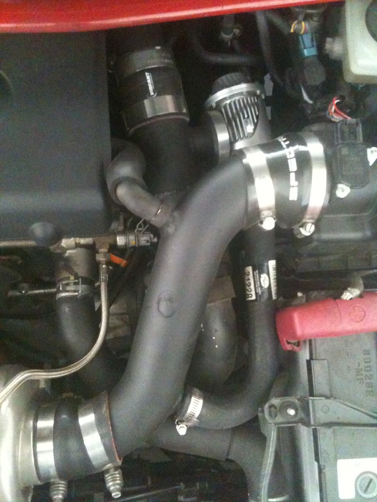

Well to answer your question, i would say yes, i think that a recirc'd bov helps with drivability.
Here is my setup
HKS SSQv3 Recirc'd to draw thru intake pipe after the MAF

Thanks for the pic man, I will see how I feel when I get everything installed. IF it runs like crap I will definately do the recirculating. How does it affect the sound of the BOV?
