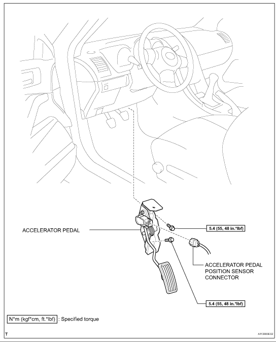

It could be your Accelerator Pedal Position Sensor:
P/N: 7801021020 Est. cost: $380
Might be a pricey thing to just go out and buy for a trial and error way of troubleshooting. But if you think everything is straight with the car ie: air filter, MAF, clean injectors, proper tune / reflash, good plugs..... then i would say try it.
