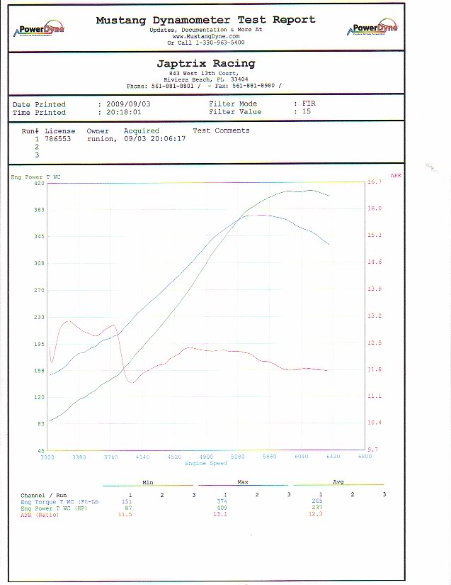

brett ur dynograph shows ur power droppin off pretty quickly and getting up there slowly, mike would probably be able to get a better powerband for ya
im not quite sure that you know what you are talking about chad, or that you know how different a/r's and tuned manifolds can affect spool time. maybe you should go back and take another look at my dyno. my hp drops less than 10 whp from peak to redline. nothing against mike. im sure he's a skilled tuner. but i only let one person tune at wot on my tc. (no offense mike). if i wanted a full on power tune i would be running more than 19 degrees of timing. but since i only have 650 cc injectors and am using meth to aid in fueling, i think im fine where im at.

post ur dyno
Old Nov 23, 2009 | 10:23 PM
  #55
brett561tc's Avatar
Posts: 3,773
From: West Palm Beach, FL
Originally Posted by SoFloTC
post ur dyno
ok.

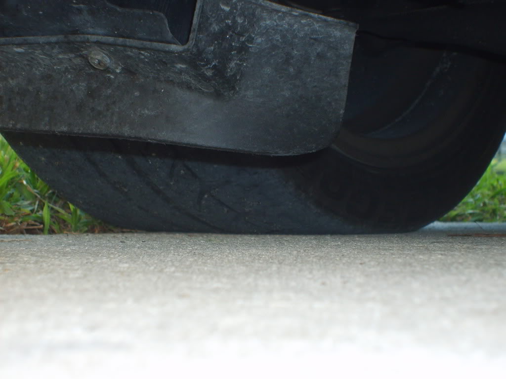

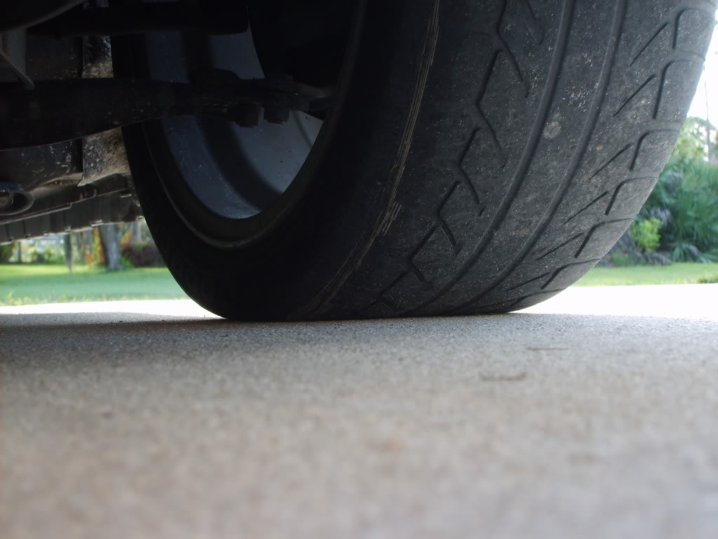

what i guess i meant to say is its not a large power band.. ur only maknig above 400whp for 1000 rpm's because u make about 400 at like 5400 and then it cuts at 6420 but it starts going down at 6k pretty fast
im reving to 7k. tires slip pretty bad. so it doesnt really show what the car is actualy making. heres some pics of the tires i dynoed on.

not to mention the fact that im at 16.68 psi on a mustang dyno, not a dyno jet. and i still cant grasp your concept of "going down at 6k pretty fast"???? my horsepower barely falls ANY.

u need an alignment!
