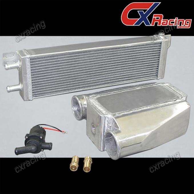

After reading you post I started thinking a little more there has to be a better way to do this and keep the coast donw i ran a cross this kit. Want to know what u think??? It Water to Air so there wouldnt need to change the hood, even though im doing it any way.

Ok I agree with you on the top mount part. But i have really be doing a lot of reading and looking around and searching. I think Water to air is going to be the best rout. It not that exspansive only going to run me $300 after it said and done.
But I would have to disagree about it not being worth it. im going to be running 12psi, with that much of hot air really seems dumb to me not to have any type of cooling at all lol. If you going to force that much air or any air for that matter the colder the better!!!

You could use the one I linked with a vented hood, you would need to fab something to the bottom of the hood to channel the air into the core. You would most likely have to do the same for the sti top mount though since it is made to fit a certain layout. With the sti cooler I'm not sure if the piping under the cooler would fit.

The w2a coolers you posted are a couple of the mock-ups I made when looking into that type of system. There are pros/cons of each set up, so hopefully you have done your homework.
From what I've learned here, cooling your intake is necessary above 10psi.

I dont think im going to lose that much boost the guys running frontmount say that they lose 2-3 psi in there piping. What i kinda came up with im thinking ill lose .5-1 psi of boost 1.5 at the max im ok with that. The intercoolers I was looking at earlyer wont work even with the plastic cover removed, all intercoolers i saw are 4.5 high the car has 3.5 of room form the valve cover to the hood witch is tapering down.

I totally agree with the W2A I/C idea, I am working at www.frozenboost.com to figure out how to put together a good kit that will not only fit under the hood but also provide enough cooling to manage my system now and in the future.
I've found that if you either move your battery to the back of the car or get a braille type battery there is a nice cubby area in the front drivers side of the engine bay that will house the W2A unit which will allow for an easy front mount for the radiator.
Using a W2A will minimize boost lag and loss, plus it can be a much more stable cooling system vs A2A cooling.
