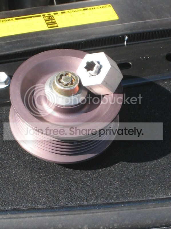

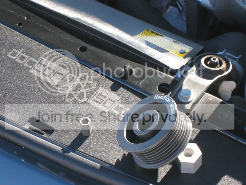

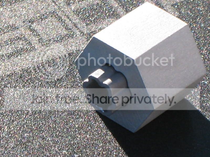

I had planned to make one of these for awhile but just recently had a change to get it done. It involved some company equipment only companies could afford.
I have epoxied the two parts together and will have my belt to install my pulley tomorrow. Thought it was pretty cool, have my very own key tool.

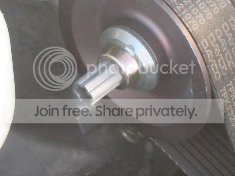

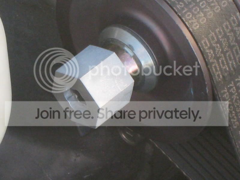

That being said some pictures of it installed. Worked perfectly but the new belt was a _____ going on.

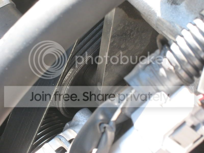

Question: For those with a supercharger does you idler pulley have the belt this close to the inside edge? I think the dealership still didn't shim the idler properly and I am thinking of reshimming it myself. The way it sits looks like it is causing a torsional force on the idler pulleys bearrings.
Old Jan 30, 2009 | 08:28 PM
hotwheelsrs1's Avatar
Posts: 661
yeah im having issues with how my belt is lined up too... the belt is about a whole 1/8" off the passenger side
Old Feb 8, 2009 | 10:30 PM
DUANYS's Avatar
Joined: Oct 2008
Posts: 79
The same thing happened to mine when i put the 12psi pulley on, after a while it adjusted. even when i put the stock on back on it happened until i bought a gates belt. Great job on the key btw.
