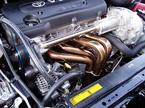

wow.... I know that engine from someplace....

what header is that?

Megan header.
