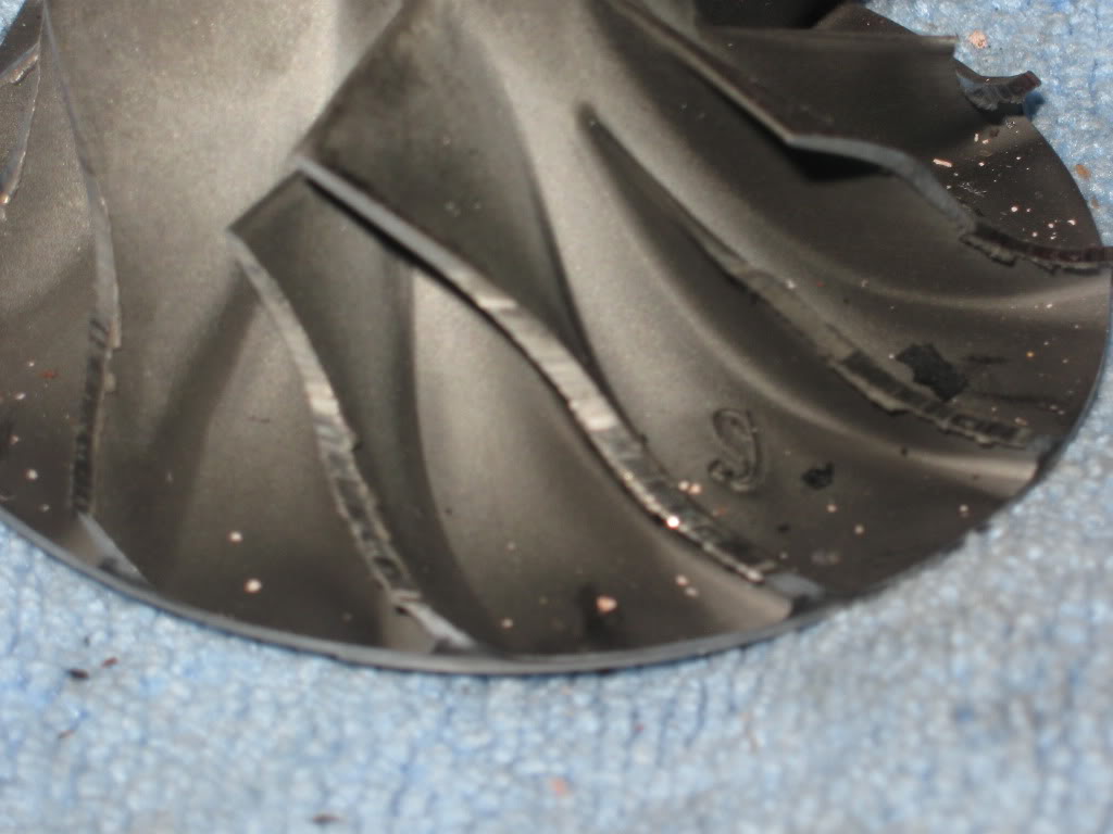

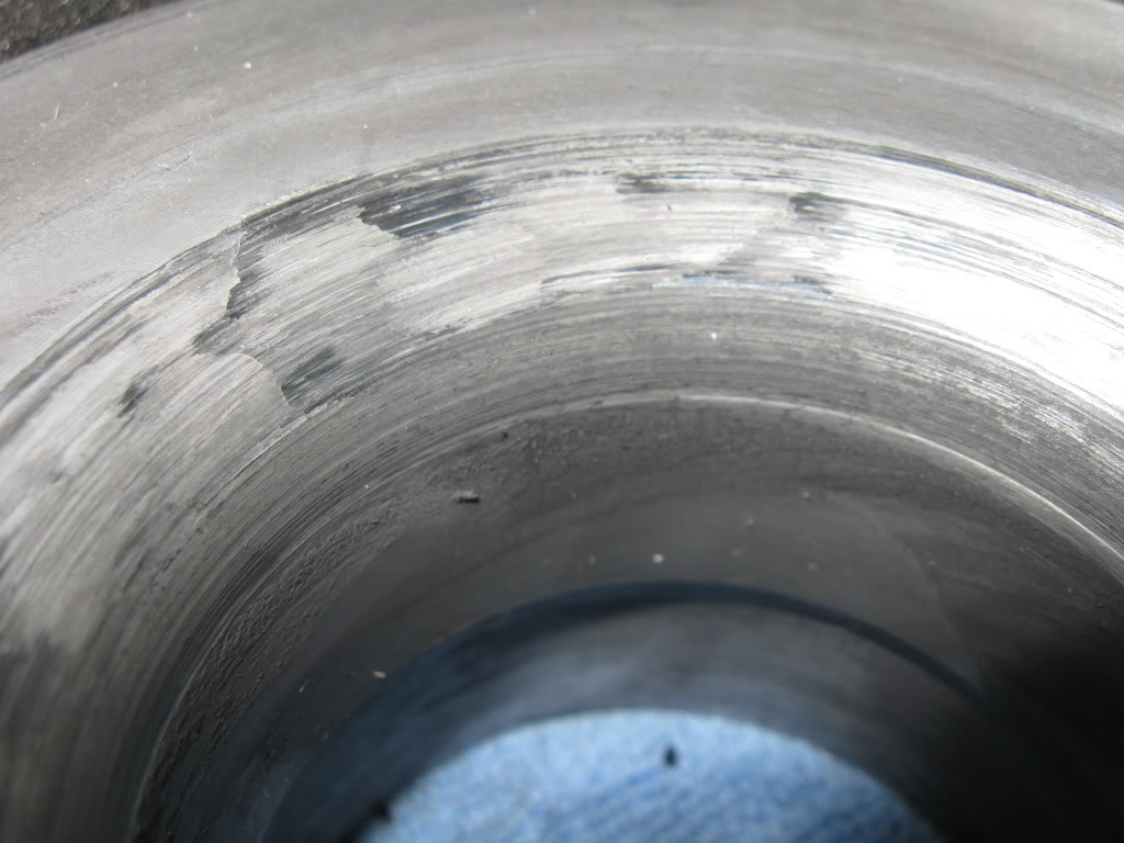

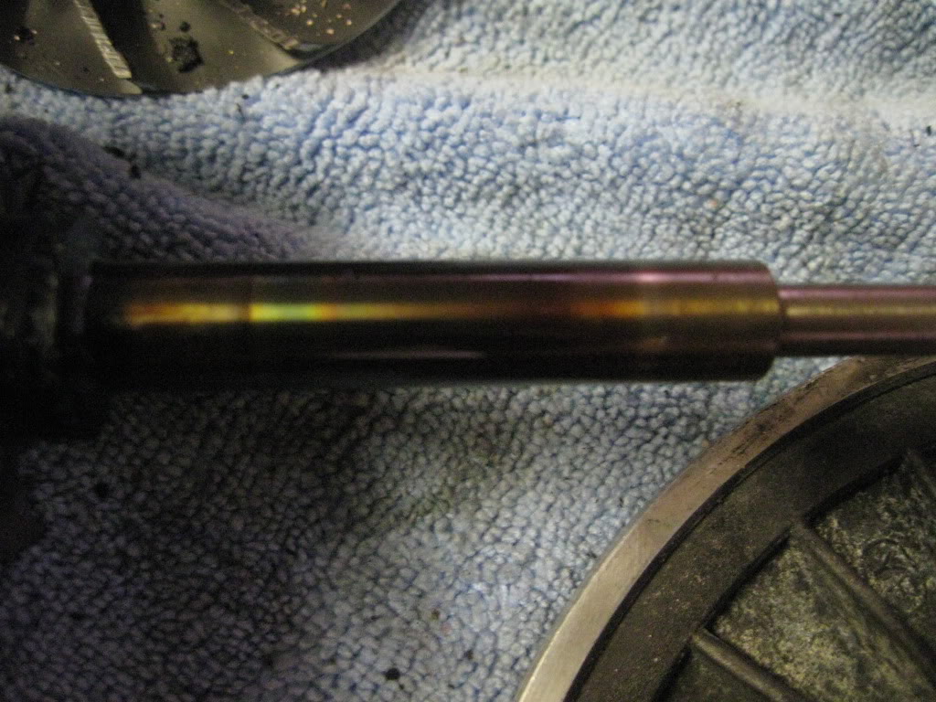

Old Jan 16, 2011 | 01:39 AM
crush02342002's Avatar
Posts: 11,271

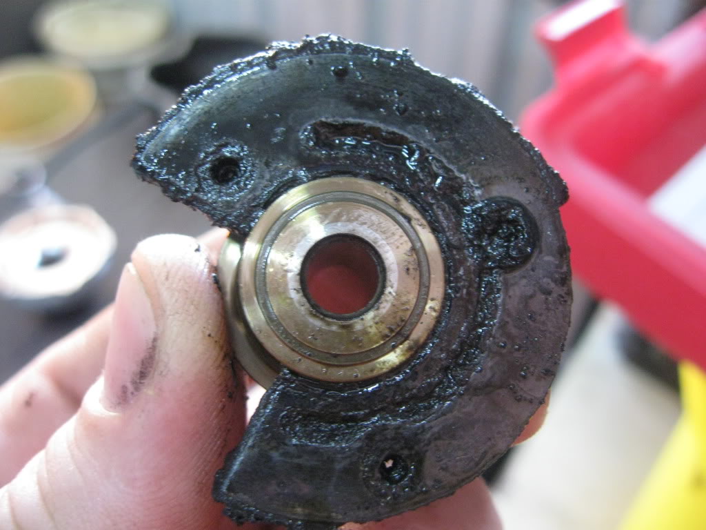

this is what a blown turbo looks like
shavings from the bearings

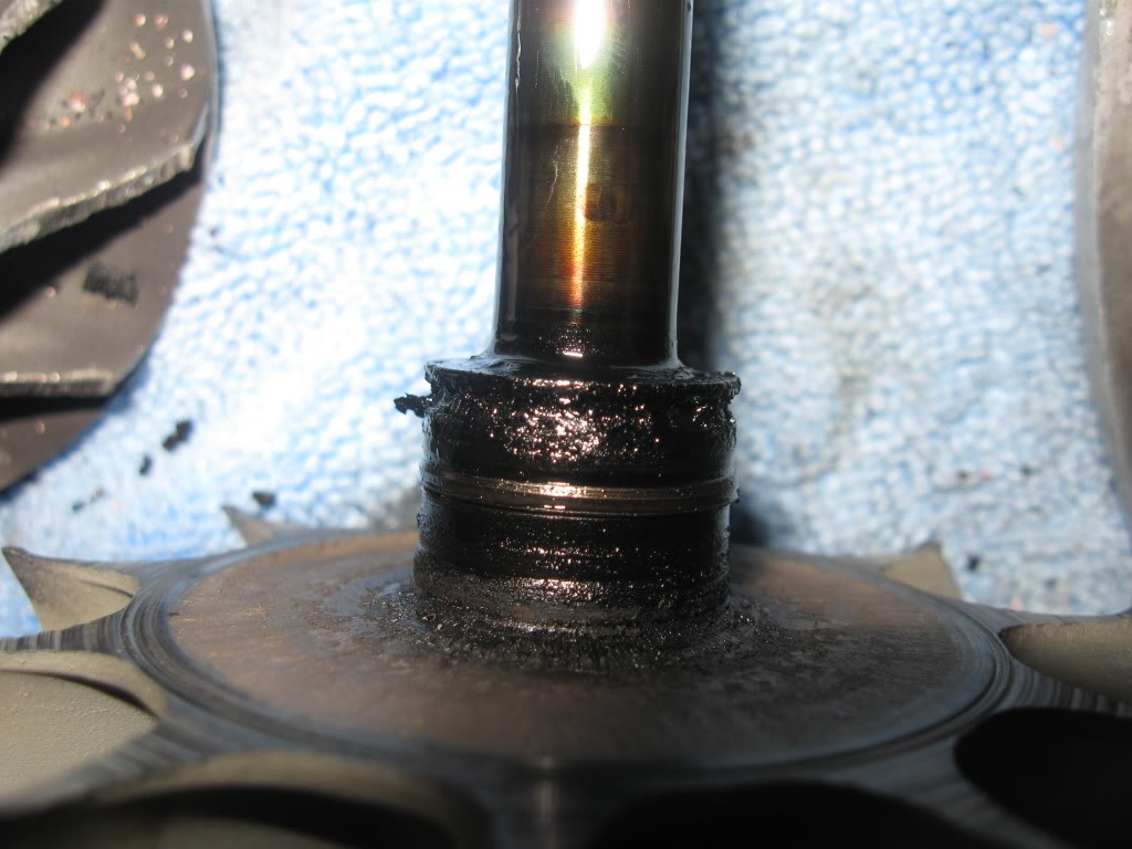

shaft
seal
thrust collar

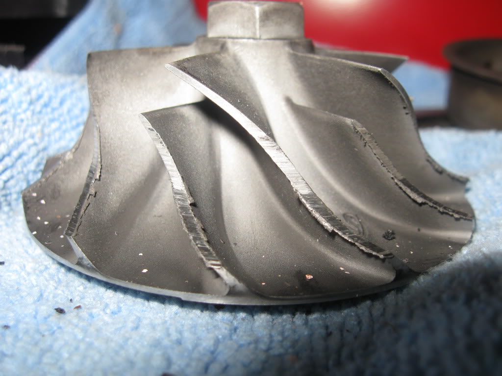

comp wheel
comp housing

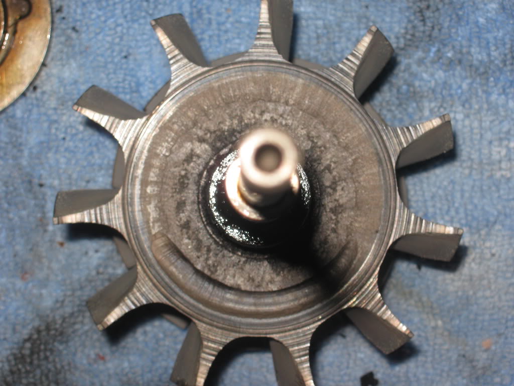

turbine wheel
bearings
On this turbo the bearings were being shaven down by the retaining clips causing excessive "in & out" shaft play. The wheels were being drivin into the housings causing them to grind down.

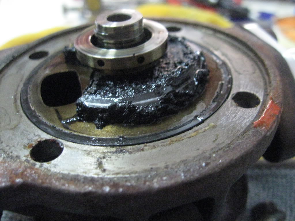

center section w/thust bearing and thrust collar

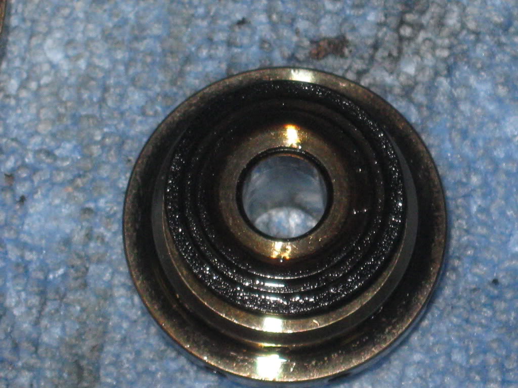

thrust bearing and thrust collar
In this case there was a ton of oil cooking due to insufficient oil or running the turbo hard without allowing proper cool down. Notice the oil turned to carbon build up and clogged the oil passages. There was just enough shaft play that the wheels just made contact with the housings. Bearings were, well toast cause of improper oiling.
