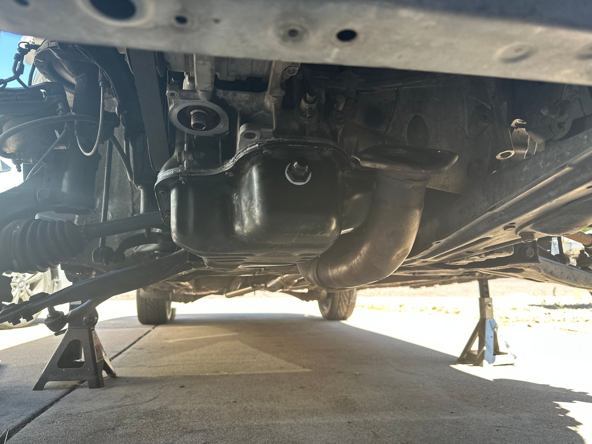

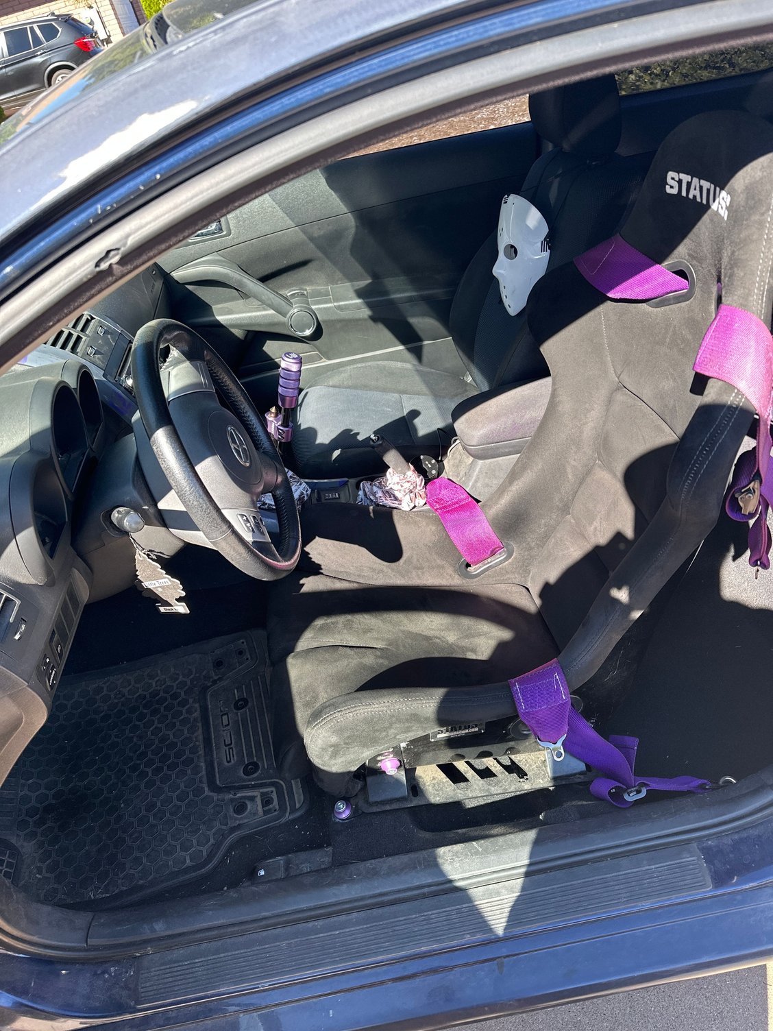

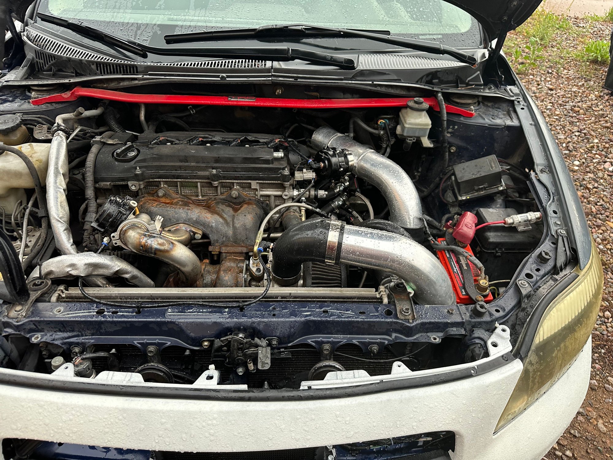

so for what I have built block new trans on the way
gt3076, spa manifold, 44 mm waste gate, goautowerx 38mm-44mm adapter, burgermotorsports filter, 50mm bov, 3 inch to front axle 2.5 exhaust piping back to greddy exhaust waiting on my ecu emu black and all my air to water intercooler part will support up to 600whp, fuel rail line fittings and fpr

sry it’s been slow going this build is my culmination of me being a certified tech and my 3 crx my 1 95 type r which I still have with a cracked head from 800 beans, dsm and ra which was my master piece time attack build and got t boned
so is what it is but starting front wheel drive sourcing parts now for a awd swap down the road cage is on its way oil coooler installed and all water to air stuff should be done Thu as every one knows it’s time and money and I’m a family man so I will send up dates as I can

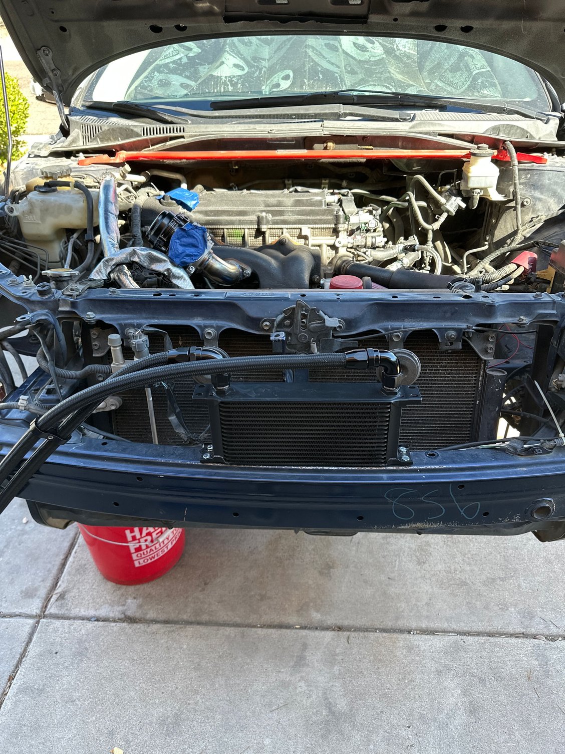

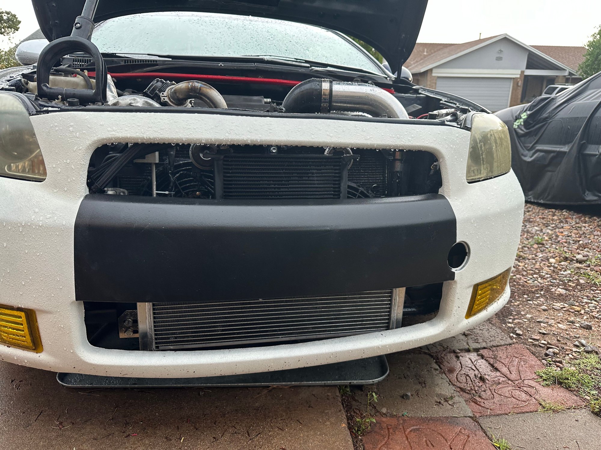

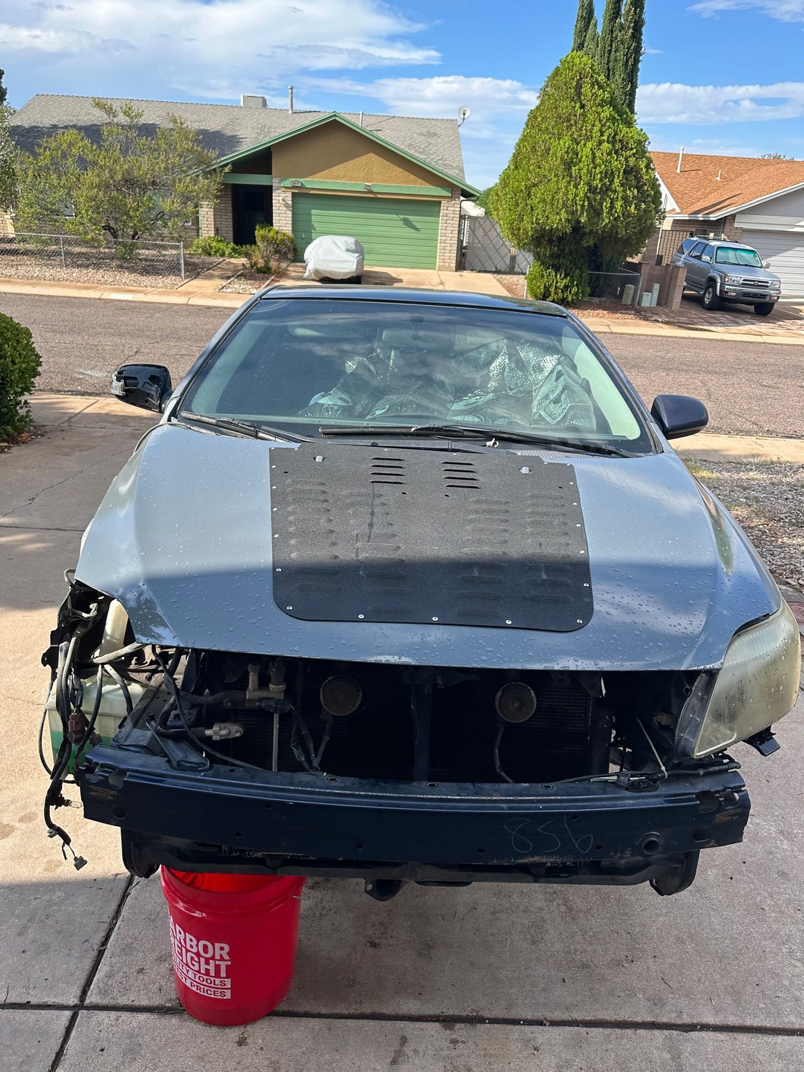

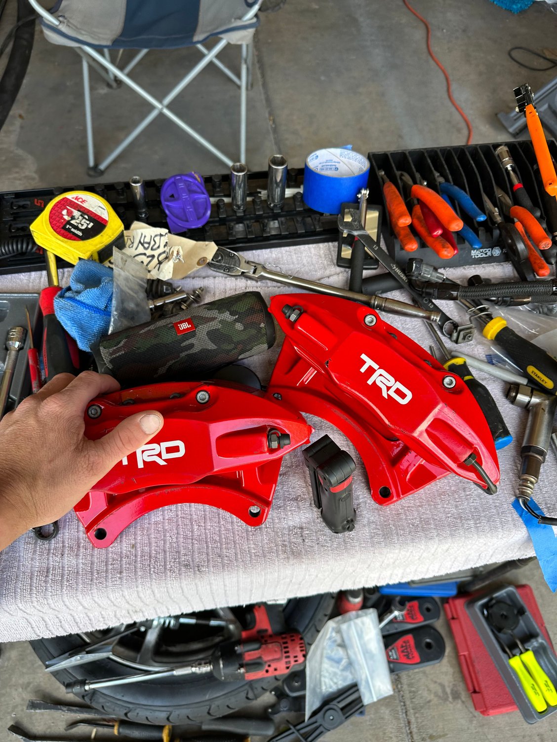

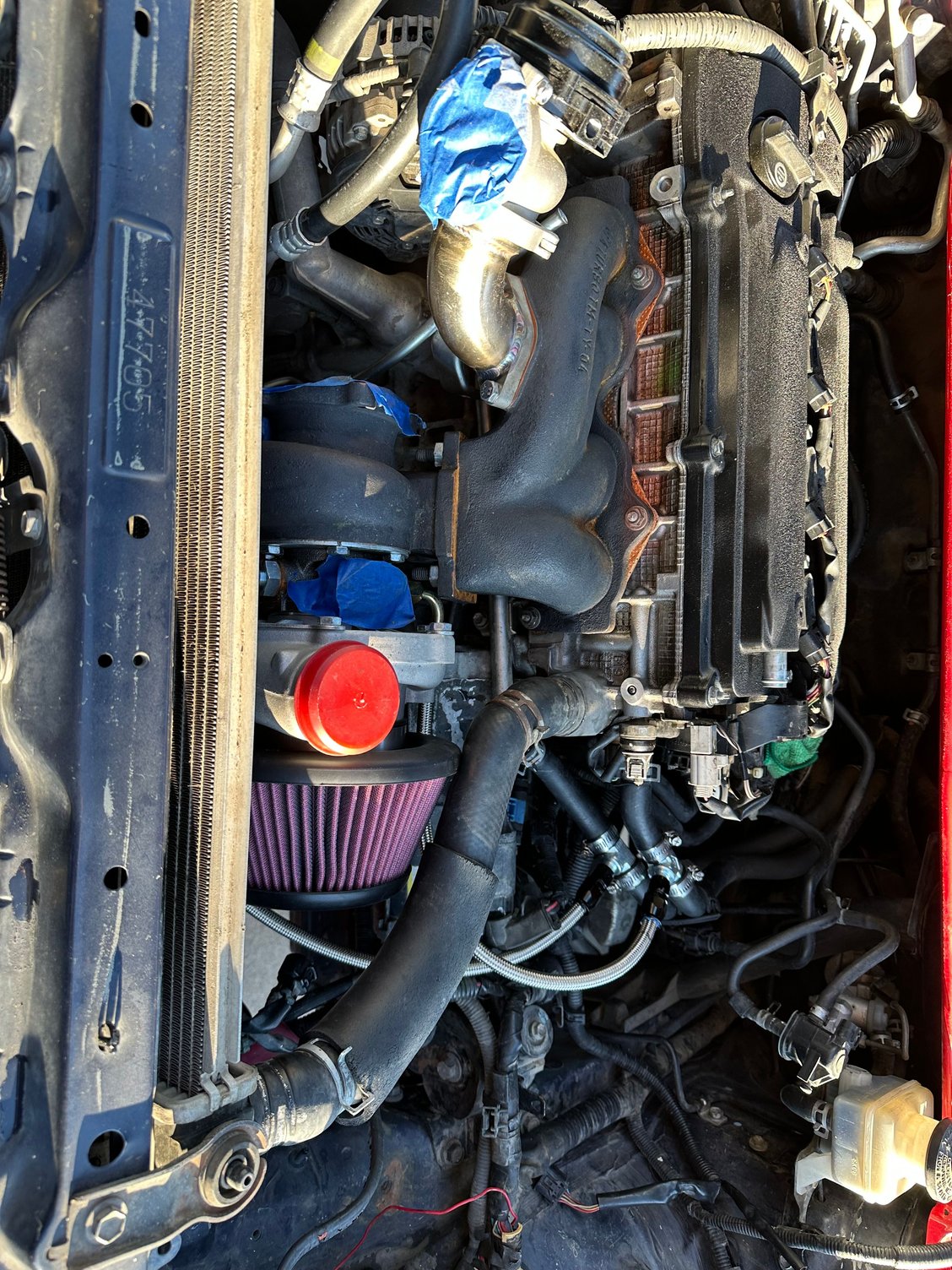

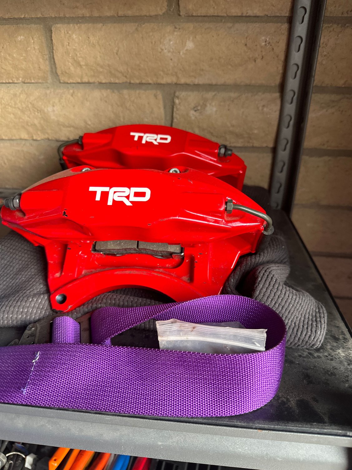

Sry been busy with work but this is the up date as of today oil coolers on 3076 on down pipes on water reservoir mounted water to air intercooler small battery bussman water fuse box front mounted rad water pump and jeep otrattw rocker switches from my jeep I’m parting out
waiting on the new covers to get here for rocker switches fuel pump and return line stuff and id1050x and emu to get here then I will get it tuned and I have a date to get my down pipe manifold and turbo ceramic coated I still have to swap knuckles for tc 2 knuckles and get axles made for my tc2 trd calipers
