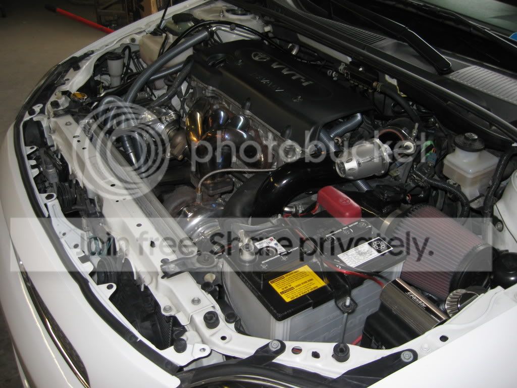

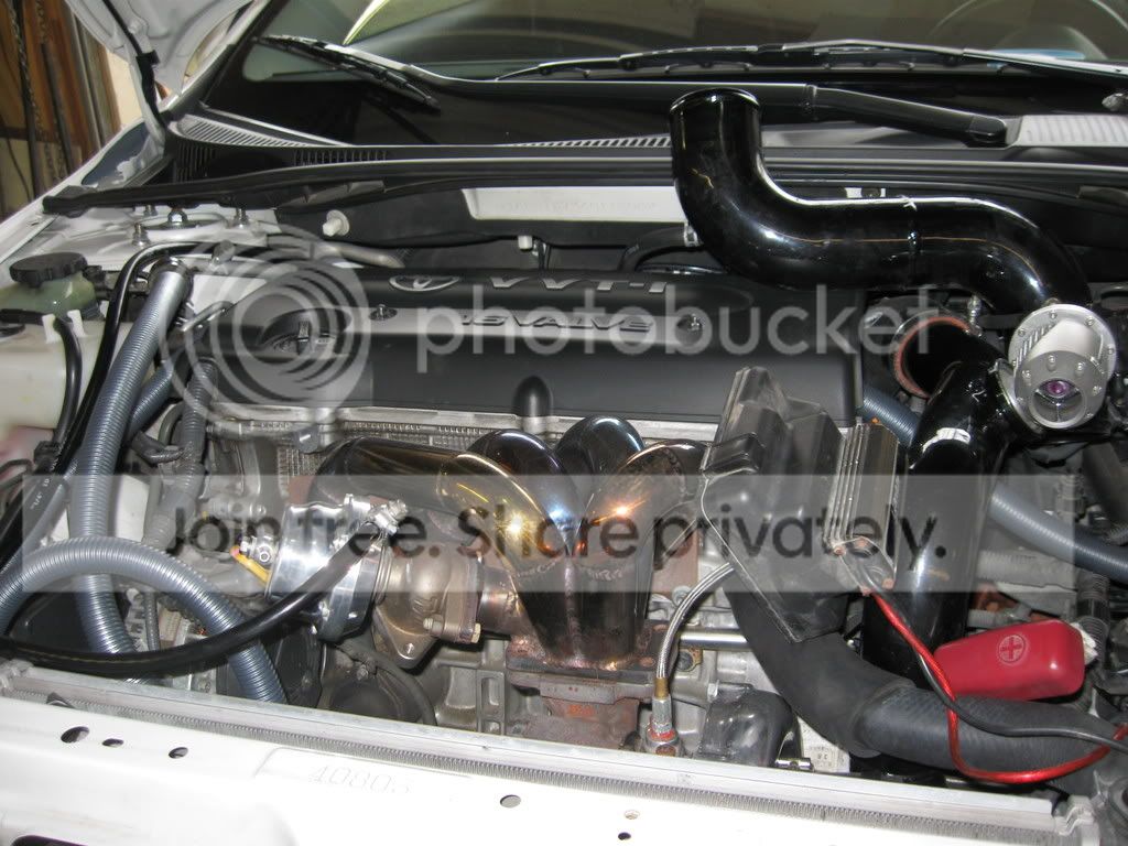

what did polishing your turbo entail?

I didn't have many tools available, but had a dremel. I used the dremel to grind down the turbo to kind of a level surface and started sanding it out progressively with 80, 100, 220, 320, 420, 800, 1500 and 2000. 220 and above u have to wet sand it and wear a good pair of leather gloves. The last two are for the mirror finish btw.
It's kind of hard, ie. I sand it with 220, 320 and 420. By the time ur done with the 420 u will notice there's some deep scars around and u will have to go down to 220 in those areas and work ur way up in numbers again. It's a tedious job, but doable with something like an aluminum turbo housing.

ouch! sounds like a lot of work. i won't have my turbo out long enough to do all that. thanks for the info!! Looks great by the way and happy boosting!!

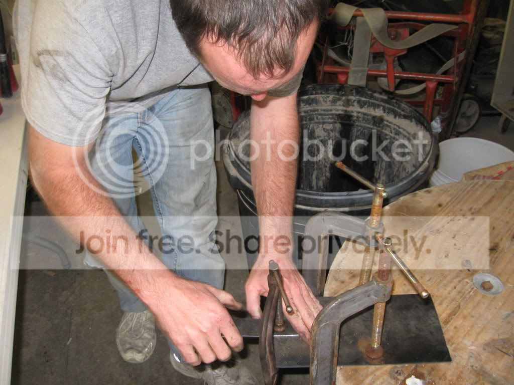

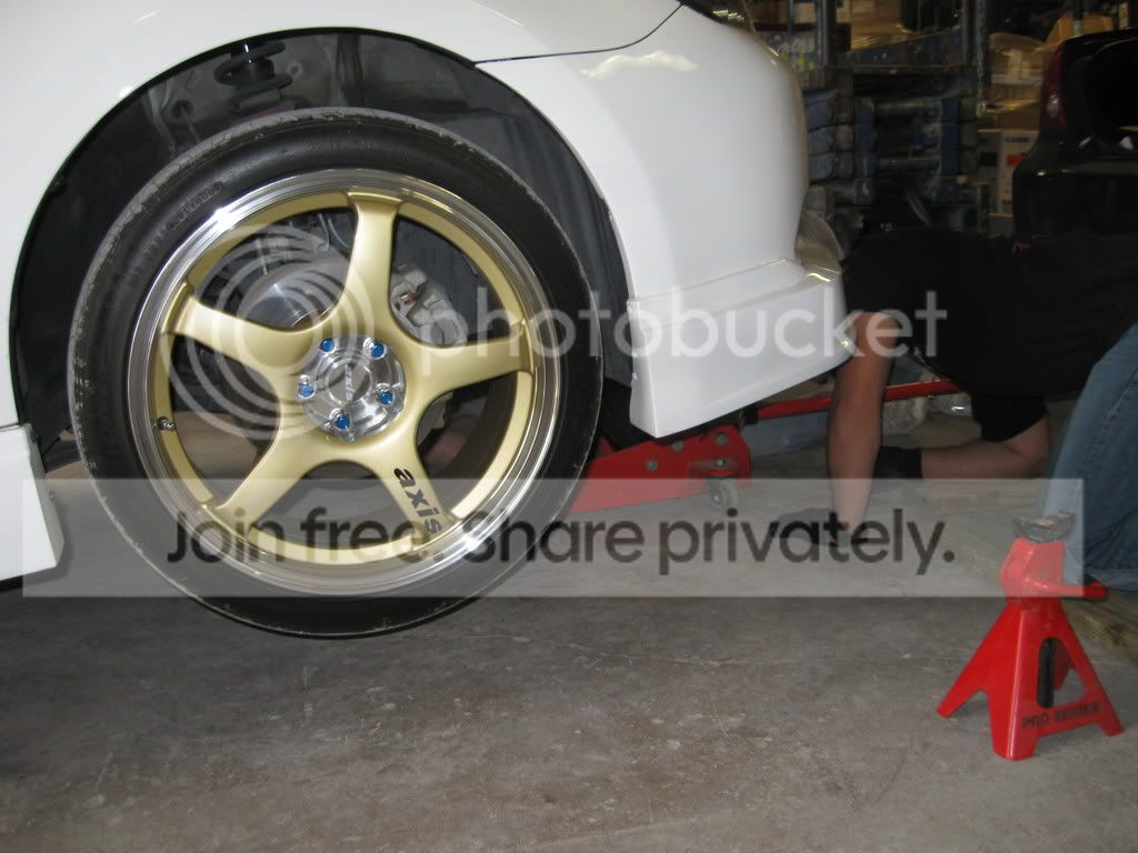

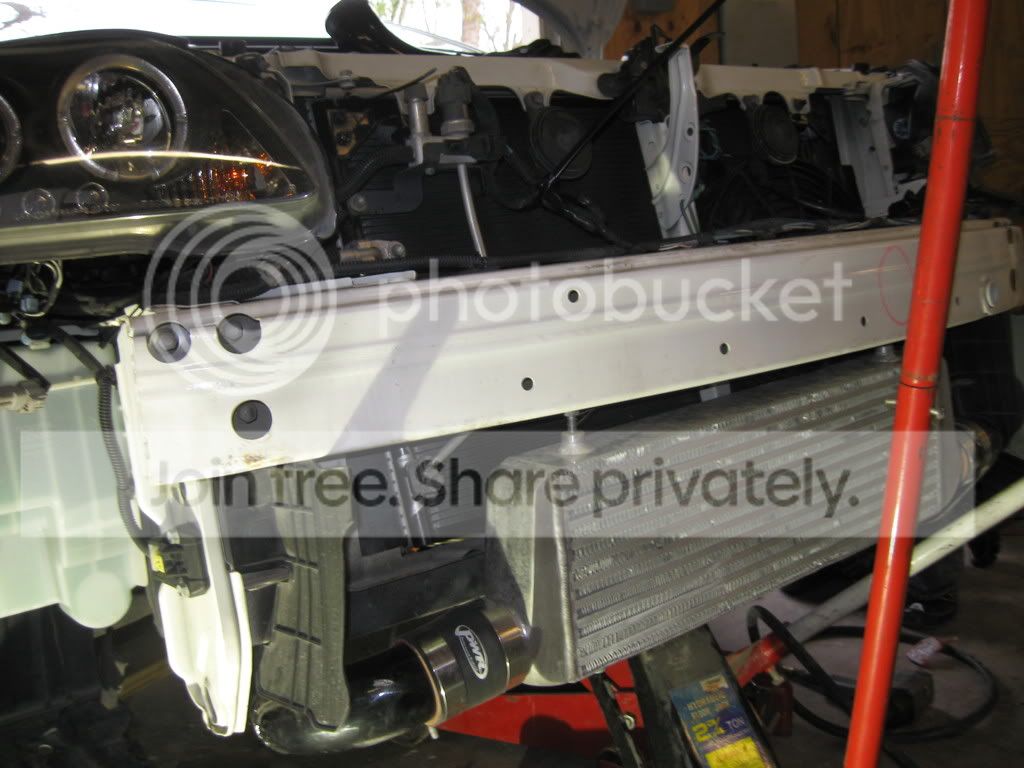

speaking of pics iv got a few carlos of when we installed the motor mounts if you want me to post em

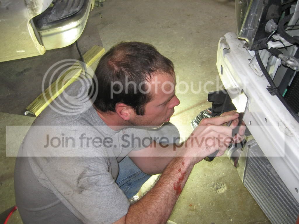

haha bloody hands? or red rtv? lol keep modding, nice turbo kit but i like your coilovers
Old Mar 2, 2009 | 12:05 AM
crush02342002's Avatar
Posts: 11,271
rtv.......yeah we got messy with that crap
