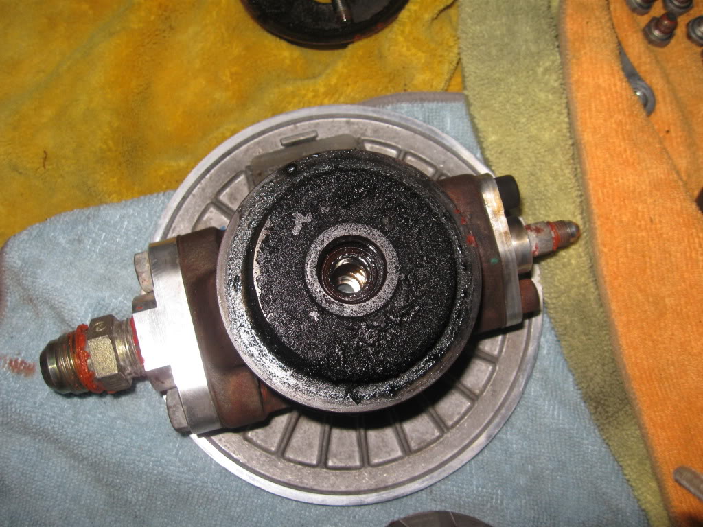

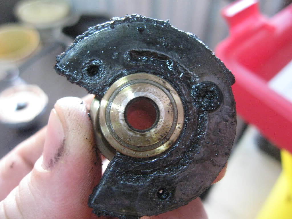

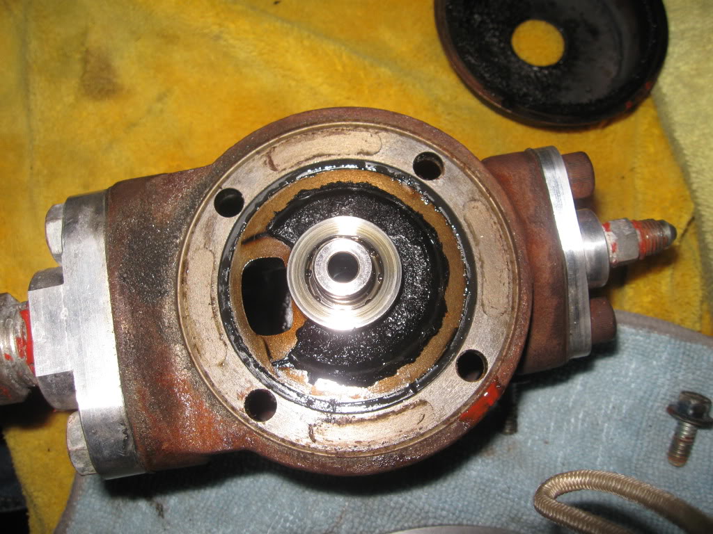

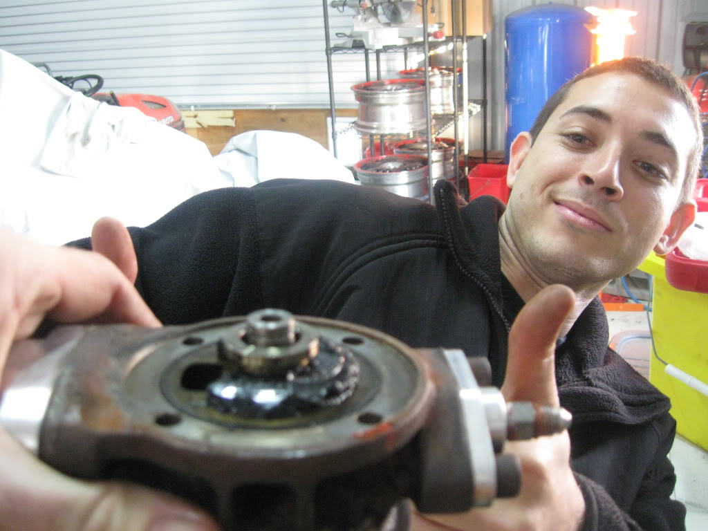

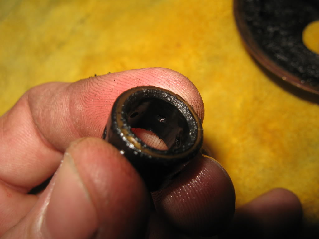

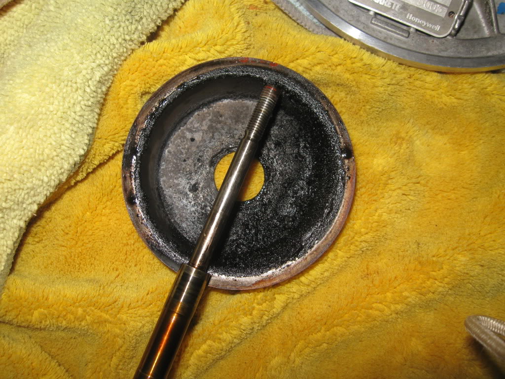

well the Rican got his first tast of rebuilding a turbo....GOOD JOB BRO!!!!!!!!!
(the reason for the rebuild, not for the faint of heart or small children with laces in their shoes...lmao)

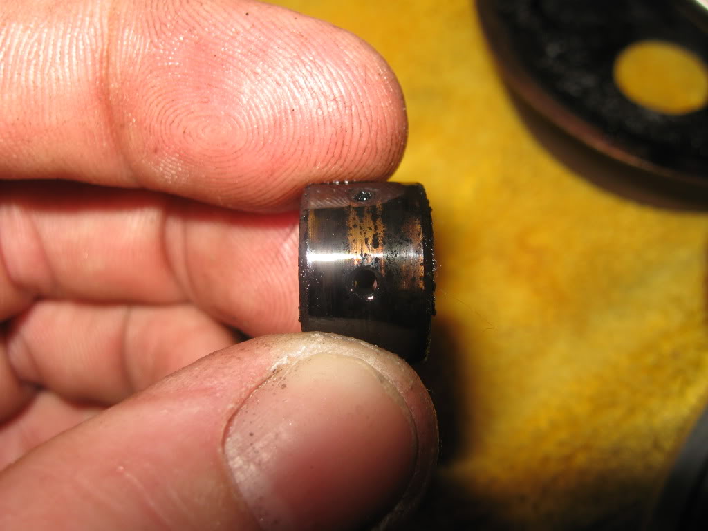

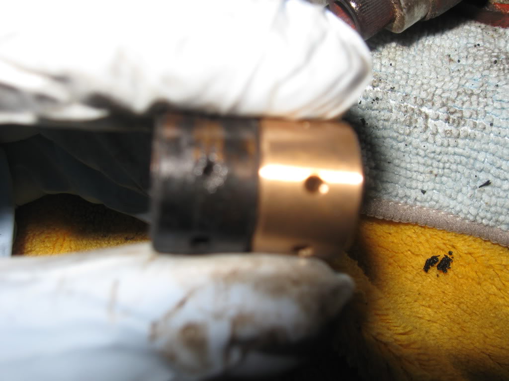

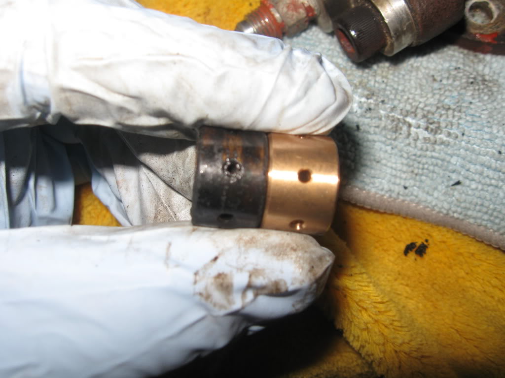

new and old bearing

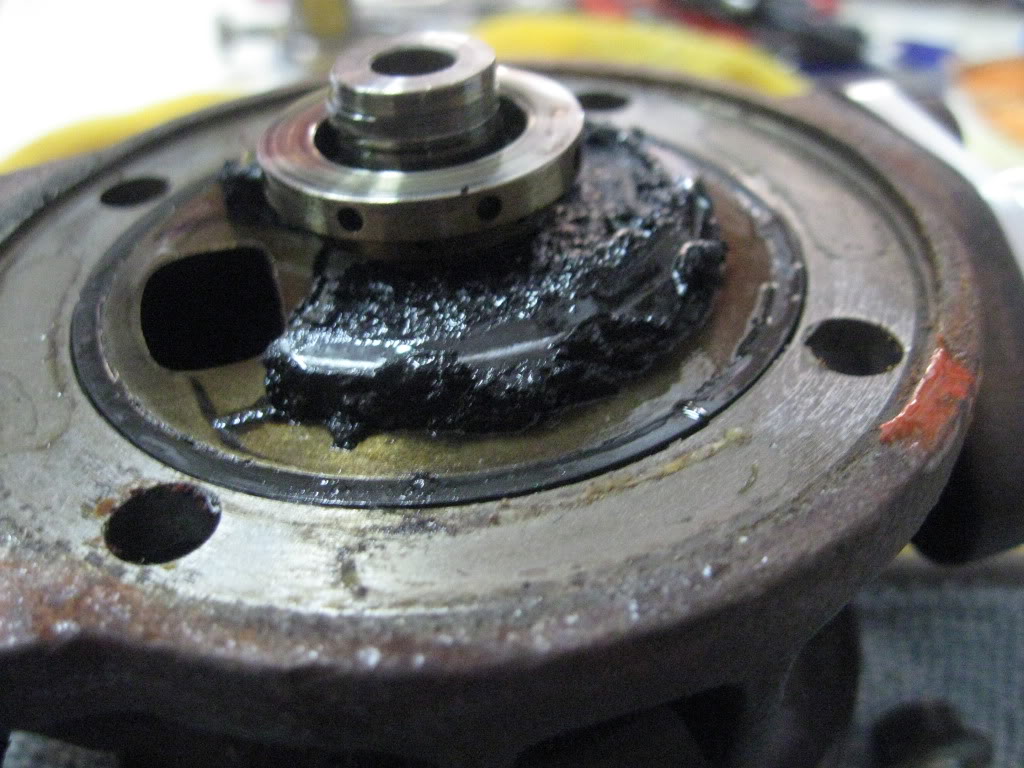

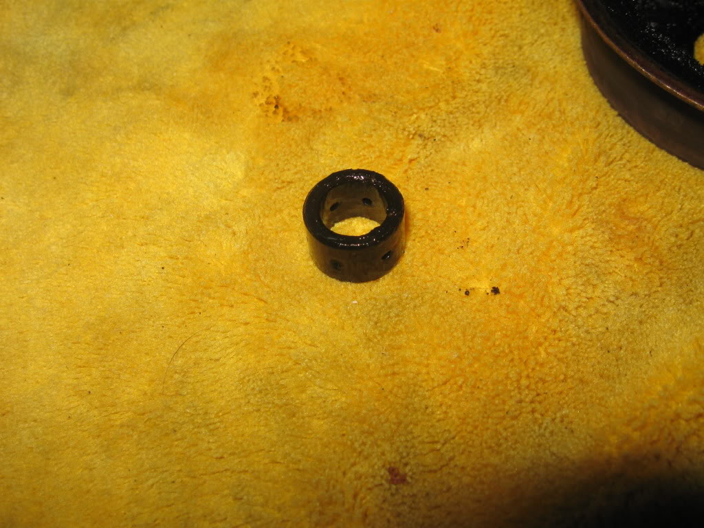

as you can see oil was cooking pretty bad and we were trying to figure out exactly why it was happening, it was a used turbo so could have been done before.
so the possibilities are
1. not enough idle after a hard run
2. clogged oil feed (i wont mention it...lol)
anyone else have any ideas?
