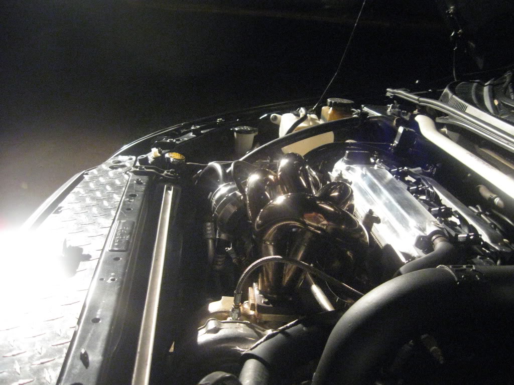

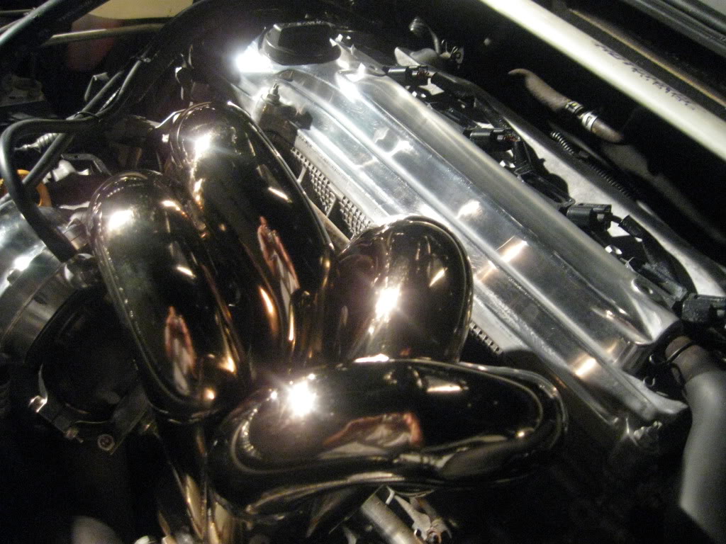

oh nice job chris.. was that a raw finish or it was coated before
Old Nov 25, 2009 | 04:02 AM
  #354
crush02342002's Avatar
Posts: 11,271
it was raw and polished before....i had to reroute some vac hose and ended up putting some finger prints on it so i thought it wouldnt be a bad idea to just polish it up along with the valve cover....dude when i get in one of those moods i polish everything i can..(no homo)...lol

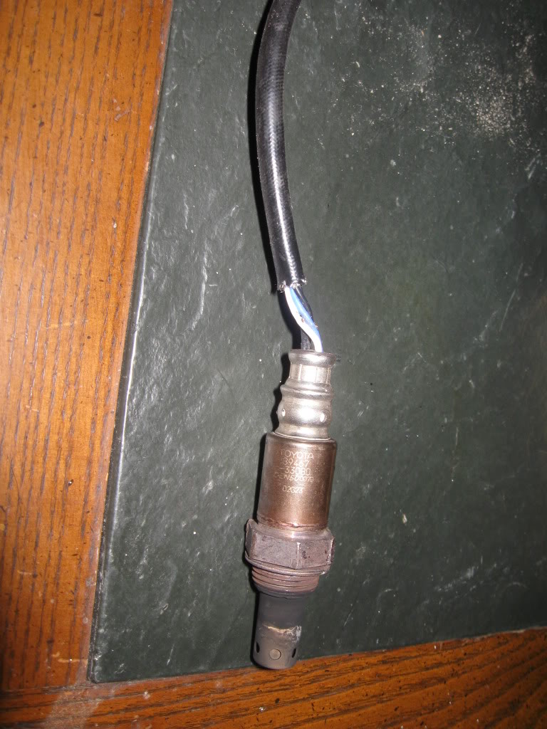

just another turbochargers.com touch.... ohh how fun this was to find out....
Old Dec 8, 2009 | 12:38 AM
  #357
Posts: 11,271
and not very fun to change out in the rain might i add....lol
ill post up my picks of it in a min

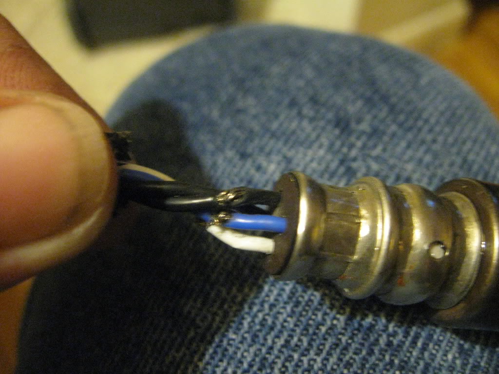

Old Dec 8, 2009 | 12:44 AM
  #358
Posts: 11,271

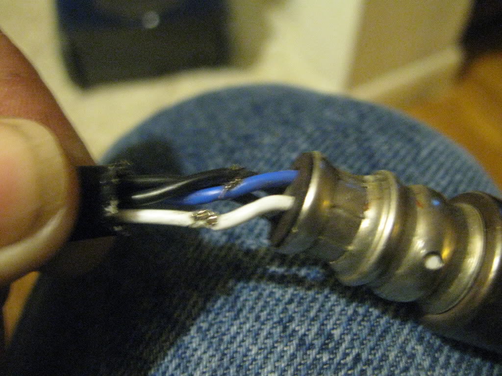

this is exactly how it was on the downpipe (wires twisted pretty bad)

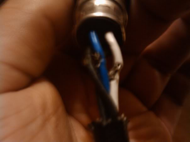

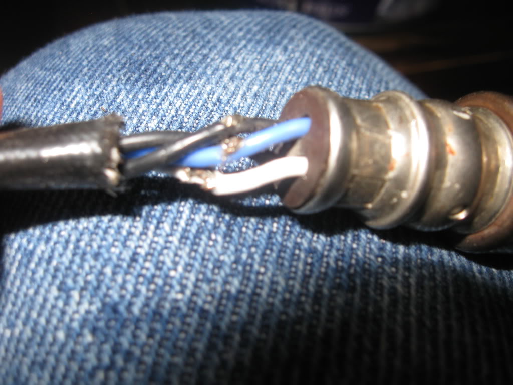

spread apart some
Old Dec 8, 2009 | 12:46 AM
  #359
Posts: 11,271
stupid car would go in and out of open loop just sitting at idle...lulz
Old Dec 8, 2009 | 12:57 AM
  #360
dave2610's Avatar
Posts: 1,938
From: The First State
jesus. how did they d that?
