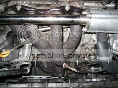

after watching that vid, anyone ever spray the wrap with the high temp silicone sealer spray?
Old Jun 27, 2007 | 07:23 PM
  #42
jwaggz82's Avatar
Posts: 6,259
From: Earth
Ive seen people spray the header w/ that spraypaint kind of stuff then wrap it. Thats another alternative. I think the spray is under $10 - you cant compare that to jethot because its only on the ouside and not both but I would assume its better then doing nothing.
Old Jun 28, 2007 | 06:01 AM
  #43
BlKtC05's Avatar
Posts: 107
From: Boulder City
9 times outta 10 the wrap suggests the use of the spray in conjunction with the wrap itself, but its really just another way to squeeze every last cent outta ya. bottom line, anything silicone wont hold up to the direct heat of the exhaust gas running though header causing it to burn off and you to reapply and reapply and reapply and reapply and...well you get the point

Old Oct 1, 2007 | 11:36 PM
  #52
GammaTNT's Avatar
iTrader: (8)
Posts: 2,592
From: NJ
finally wrap the header today. I sprayed it with black silicone coating.
Old Oct 2, 2007 | 05:49 AM
  #53
Sleep3r's Avatar
Posts: 1,101
From: Bay Area, CA
nice! like that black man
