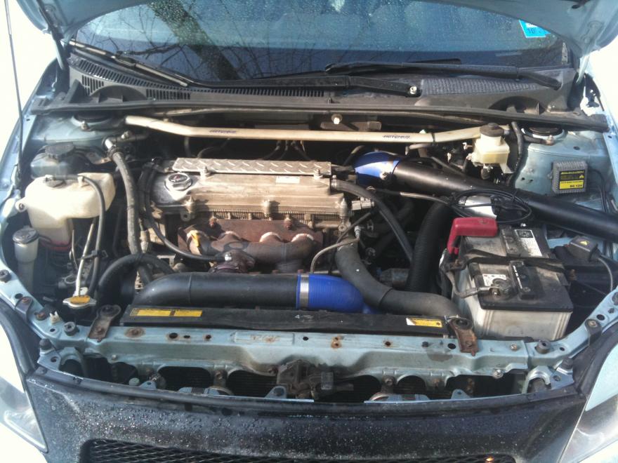

Old Jan 29, 2011 | 03:37 PM
  #100
pdool09's Avatar
Posts: 275
From: North East
Here are some pics of my setup. Not a show car. This is my daily driver weekend warrior(AX). I would recommended a lightweight crank pulley. It seems to help at idle and on launches. I just picked up a TruBoost and plan on going up a few PSI this spring. I am running just under 6 PSI right now.
Engine/Drivetrain Modifications: ZPI Turbo Kit, IC Piping, Synapse BOV, Motor Mounts, Greddy Blue tuned by ESP in Mass, Denso 550 Injectors, Ptuning 3" Axle-back, Light Weight Crank Pulley, Suspension Modifications: Hotchkis front and rear sway bars and braces. TRD Shocks with Votgland Springs, Ingalls Rear Strut Brace, Stainless Steel Brake Lines
