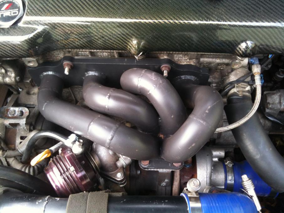

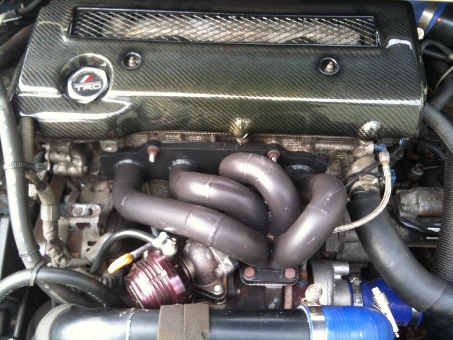

I just finished getting my ZPI kit upgraded with a Turbo Toyotas manifold. What a difference! Had to do some prep work and re-position to turbo assembly and some custom work for the down-pipe and wastegate dump.

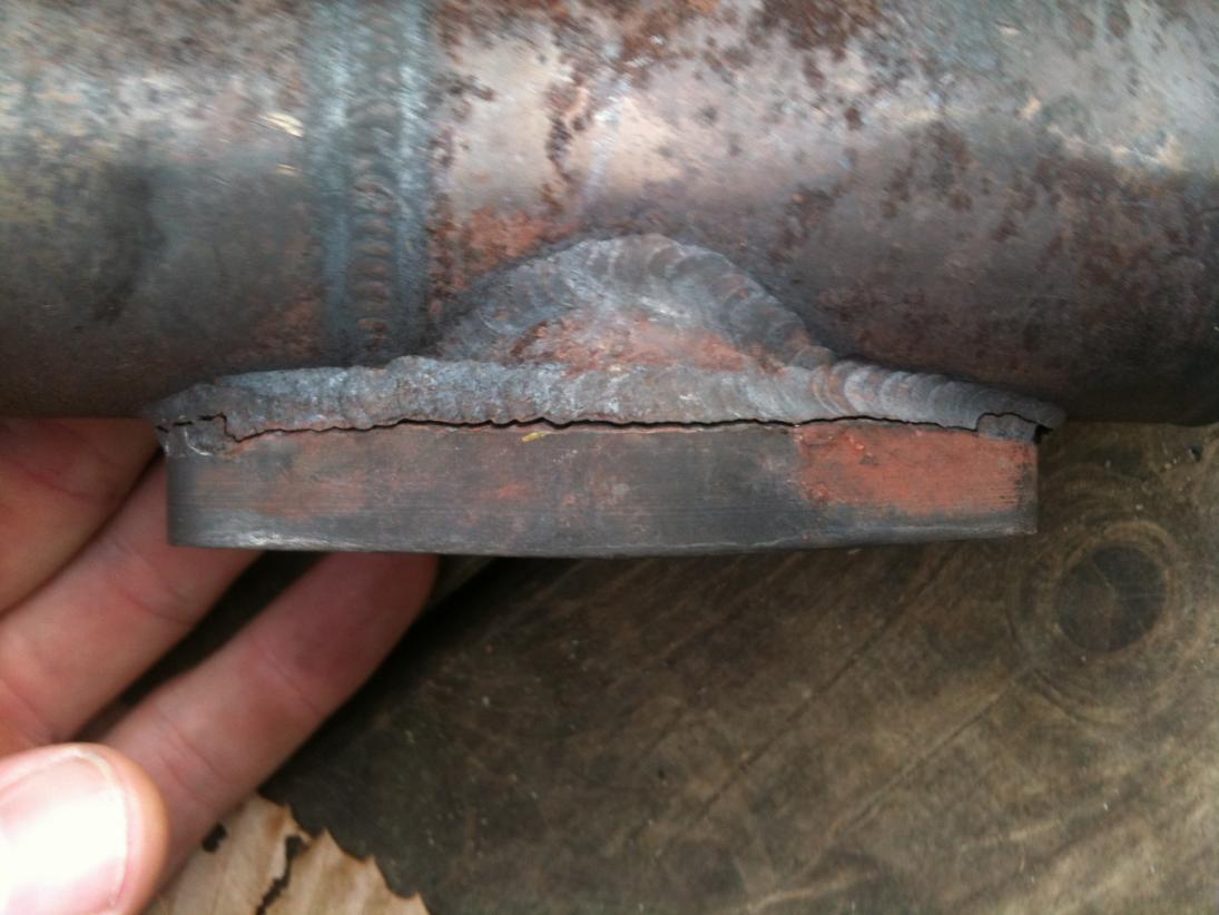

All started because I hit a road hazard with my downpipe and cracked the hell out of my original log-style manifold. See attachments for dents in s-pipe and craks in old mani. lol
Back in business now and wow what an improvement.

Looks good how's the boost response with TT manifold.

I would say boost is a little delayed, maybe 500RPM, compared to the original log mani but it comes in much stronger and lasts longer through the RPMs. The log mani just didn't flow well at higher RPMs. You could see this on the Dyno. The car is my daily driver and seems to respond smoother with this setup. Totally impressed with this mani and I haven't had the tune updated yet.
I will post all three historical Dyno sheets after I go back. The kit has gone through three dev cycles and has been a fun hobby.

Also here is a before and after shot of the ZPI Log mani and the TT mani.
