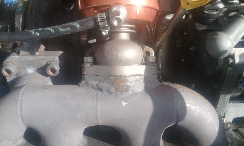

So I'm using a ZPI log Manifold...... The part were the waste gate bolts on is getting warped... I can put a pretty darn big feeler gauge in between it on the car... So I got it all true'd up at a machine shop. but still...
The problem is happening again .. Its still warping.. and the shop cant grind anymore down due to the lack of threads left to bolt the waste gate on.
So I was thinking about cutting the flange off and welding a new one on.
(worst case)
Or
Buy a new ZPI mani that's in good condition, but i doubt i can find one... AND I'm pretty upset with the quality of the manifold.(ugly as hell) so i wish i could run something else even if i have to take it to a pro welder and get it customized to fit with a TDO5

You can always do a through bolt design instead of threading in the flange. In other words, drill out the threads on the flange. Insert a stud or shouldered bolt through both the wastegate and flange and use a nut with lock washer on the other end.
Stopping the warping....that's another battle. Finding out WHY it's occurring would be more advantageous to you. Possible too high of EGTs for material used?

Thats what i did and its still blowing through heres some pics

U can see the brown stuff blowing out

I have studs in them... I need to belt sand the flange to make it flush but if i take anymore off the threads will go inside the manifold.
