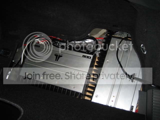

well i installed my system 2 weekends ago and everything went smooth! Everything worked fine. A couple days later i noticed a low buzz and the pitch gets higher as i rev. Guessing its the "Alternator Whine". Ive read the "Ten Commandments of Noise Free Audio Setup". Im thinking of upgrading the battery since my lights flicker also but only when i have the bass high which its normally not.
Today while driving i had the bass kinda high enough to make my nose tickle, all of a sudden my components shut off and i hurry and turn the vol down. Scrared the hell out of me! I dont know why it did that?
Sometimes when i make a right or left turn the components will turn off or the left side will work when i make a right hand turn of vise versa? Freaking weird. All the wires are tight in there and are run correctly. I remember the 1st time the components did that i went to the back when my amps are and put my hand over the amp for my comps and i heard static? It went away after i got some wires from under my amps that were smushing it i guess? I cant think of why these things are happening? it only happened when i put my new system in?
The RCA's are on the opposite side of the power wire. I do have 2 amps hooked up close together like in the pic and i was thinking this was why?
The remote wire is wired like this. from the HU to amp1, then from amp1 to amp2. the ground is from both amps to a distro block, then to the chasis. Power wire is from both amps to the same distro block then to the +battery. My distro block is a Stinger with 4 inputs and 2 outputs. My ground is to the rear strut bolt, nice and sanded down. Should the amps be seperated? I cant think thats the problem for it shutting off when i turn?
My System!
///Alpine CDA-9851 Head Unit
CDT EF-61CFi 6.5" Components
w/ JL 300/2
JL 10w6v2 ported
w/ JL 500/1
ALL STINGER WIRES
where my amps are
they are mounted on a sheet of 3/4" MDF wood. Could the power/ground wires on the distro block be too close? Please help! Thanks

if I was in your shoes I wouldn't run the ground to the distro block, no need to.
Also re-check your connections to the battery and make sure none of the wires have been damaged. I can't really believe you're having power problems with running that much, I've seen higher amperage TC's that didn't have problems. Also if you haven't yet, once you start pushing over 1KW through your car, you might want to upgrade the main 3 power and grounds of the system, AKA "The Big Three"
http://www.the12volt.com/installbay/...TID=73496&PN=1
The stock alternator should be more than sufficient for your system, and capacitors are not necessary if you have a properly designed system. The problem with the system cutting out when you're turning etc sounds like a loose wire somewhere in the system.

Connect the 2 grounds to seperate points, as far away from eachother as feasable (as in run one in one direction as far as it will go, one to the other) and if you're connecting it to a bolt, take some sand paper and scuff the bolt and the chassis like you said you already did.
The grounds could be causing impedence where they are now. To stop the voltage drop on the headlights you need to correct the over-use of the alternator. AT LEAST upgrade the power and ground to the alternator and engine/chassis ground to the battery, but if you do that, you might as well do the 3rd wire.

ok well i fixed the alternator whine which the ground was the problem!
NOW i still have the same with the speakers, although before it was the music going to the opposite side when i make a turn. It now sounds like when the wires are in an amp then removed while music is on and you keep doing it pulling them in and out its kinda like the music is cracking or when you have a bad reception on a radio station. the wires are tightly in the amp but i havent checked the others? I already tightened the xovers but need to check the tweeters. ill do that either tonight or tomorrow? Hopefully this crap stops.
PS- this speaker thing only happens when im first starting to drive as in the morning or when im leaving work? Pretty much like the alternator whine? IDK if that would help? After i drive for a couple of mins it goes back to normal?
Old Jul 22, 2006 | 05:45 PM
Yanki01's Avatar
Posts: 8,776
From: Corpus Christi, TX
im gonna try to re-wire the speakers and maybe the power wires too. Ill update later on. But usually it only happens the 1st time i start the car in the morning of when im leaving work when my car's been parked for 8-9hrs? Ill see...
Old Jul 22, 2006 | 08:48 PM
Yanki01's Avatar
Posts: 8,776
well.......i rechecked the midbass wires and i found something! On the pass side when i took off the speaker the + terminal was already unhooked! Im that this was the problem! I made it tighter on both speaker terminals. Ill find out either later 2day or 2morrow?
Old Jul 30, 2006 | 06:37 PM
Yanki01's Avatar
Posts: 8,776
fixed......bad set of RCA's! I took them back to my local tweeter where i got the things and got a new set! I still love Stinger!
