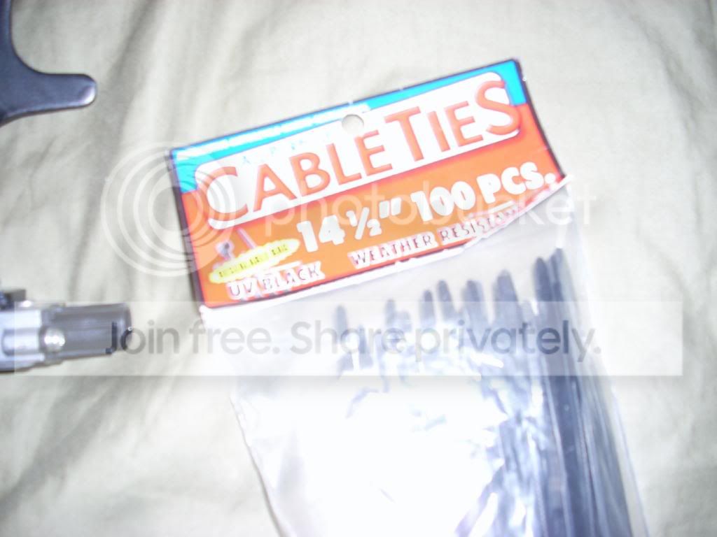

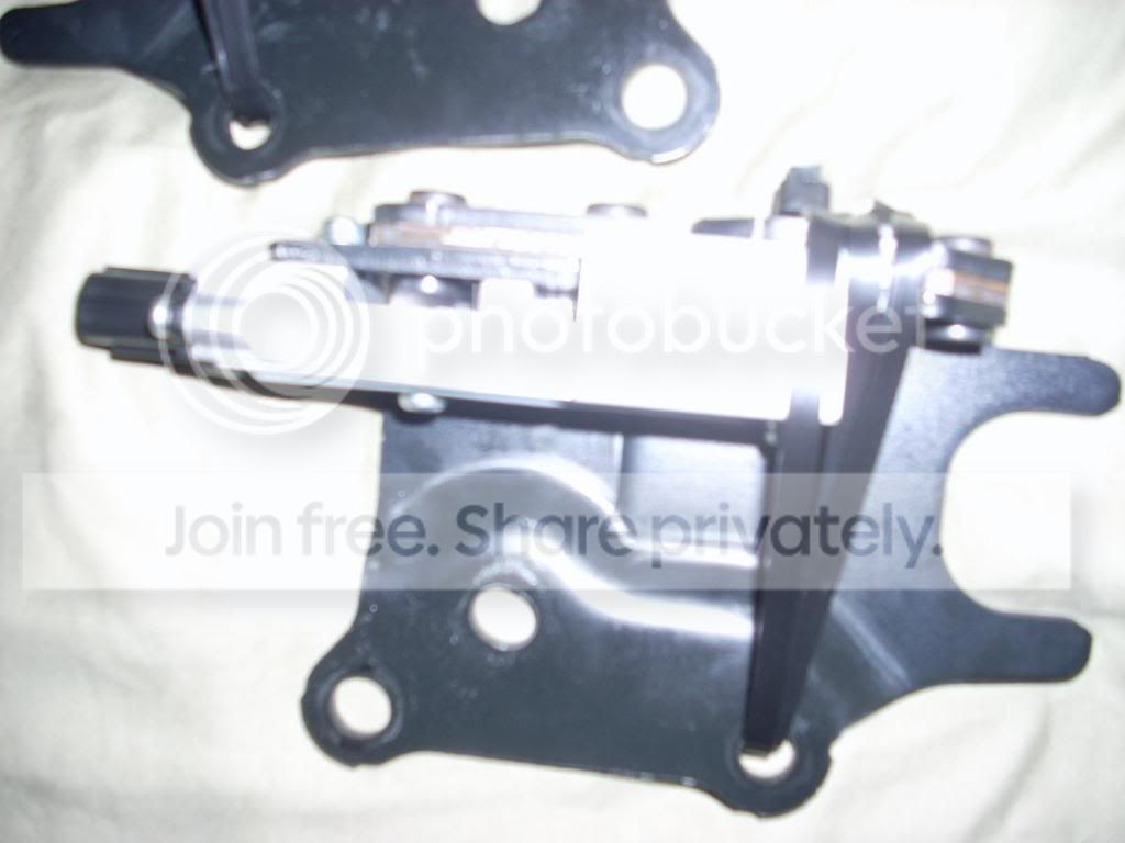

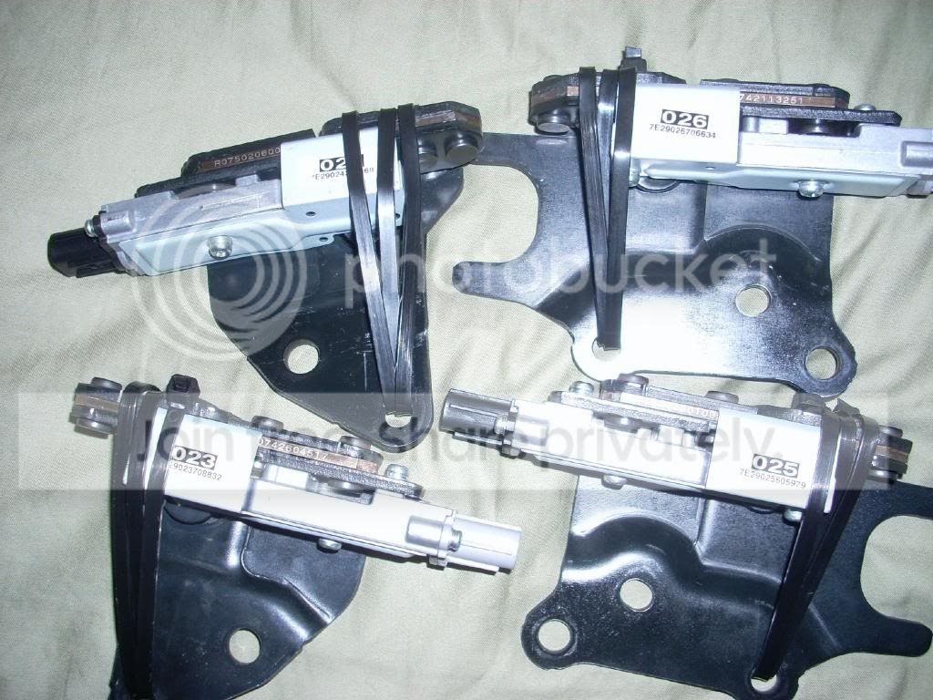

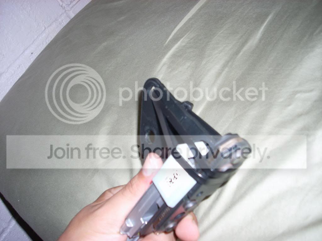

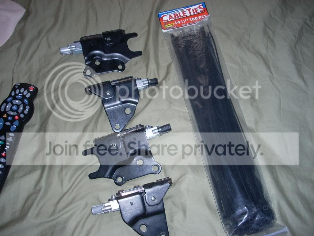

^^yup. I only need to zip tie one sensor or all 4? Imma get this done right after the game.
Old Oct 20, 2008 | 04:03 AM
  #66
java09's Avatar
Posts: 6,187
From: You All Ready Know_..
PASSENGER AIR BAG WORKING!
only thing is now i have to take off the led behind the passenger seat belt indicator because it constantly blinks. better that than no air bags!
3 zip ties per sensor like this:
all 4:
much thanks to jurrasic1! all air bags working!
