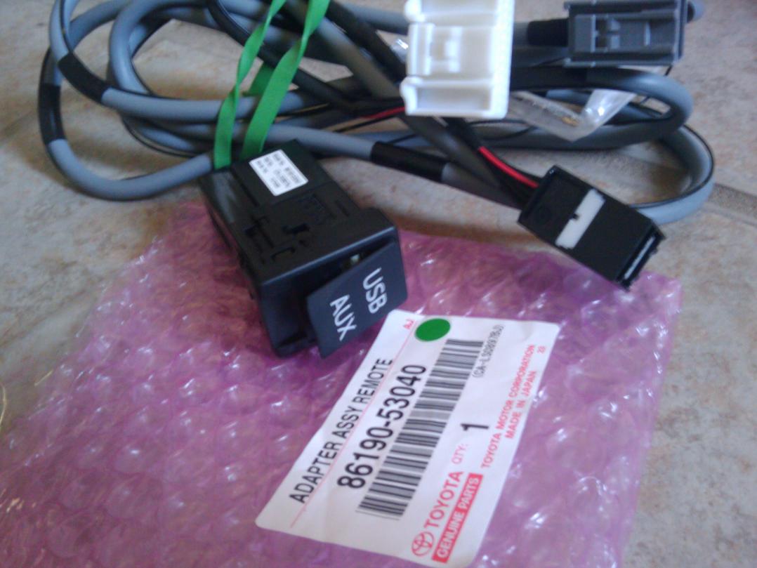

You will need part number 86190-53040 for the iPod and USB to work. Attached is the image.

Great info. If anyone does this, please let me know if it charges the 5v ipods. I hate the Scosche adapter as it picks up some engine whine. And looks tacky as well.

Thank you for the great info! So it looks like I'll be picking up that USB plug and replacing the iPod plug with it in my armrest. Hopefully everything is a direct swap with no modification needed as this is my first time taking out the stereo in the tC. I'll post back once the operation is complete to confirm everything is direct plug and play...

I have the whole setup installed in my TC. To install the USB you have to remove the center console completely to run the wires. Unless you've had expereince removing bezels and panels I would recommend getting an installer to do it for you.
The harness plugs into the back of the head unit and the USB plug will go into one of the existing plugs inside the armrest. You will need to remove one of the existing plugs in the armrest to install the new USB plug. The new one has USB and Aux together in the same plug. I personally prefered to replace the new plug with the old Aux instead of iPod because it seemed easier. But thats your choice.
If you decide to take it to an installer it shouldnt cost you more thant 70-80 bucks at a local place. Avoid BestBuy they will rip u off unless u know someone there who can hook u up.
