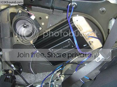

Here's a pic of someone else's install like that. I did the same thing though. You can fit pretty big amps in there on either side of the tC.

Old Jul 24, 2007 | 04:39 PM
mandos's Avatar
Posts: 2,205
From: Newton, IA
MDF plate to attach the amp to. Then either bolted through new holes in the metal or build a spacer to hold it taut. I did both:
Using the bolts to attach.
Attached by just resting on V4 and wedged in.
As for the air circulation, as long as you don't seal up the defrost vents(and I think I'm the only one dumb enough to have done that), the easiest path for air to travel through the vehicle when it's not on reciruclate = into the rear speaker grills and through the back to the vent openings in the very back of the car.

Old Jul 24, 2007 | 05:48 PM
mandos's Avatar
Posts: 2,205
From: Newton, IA
Nine.1 is 14.7x10x2.25
Nine.2 is 12x10x2.25
That's the reason for no bolts in the Nine.1...they'd be through the amp case.
