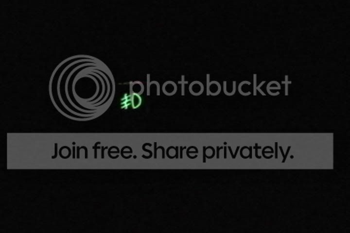

Here is the green color at night

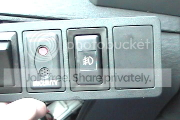

Daytime

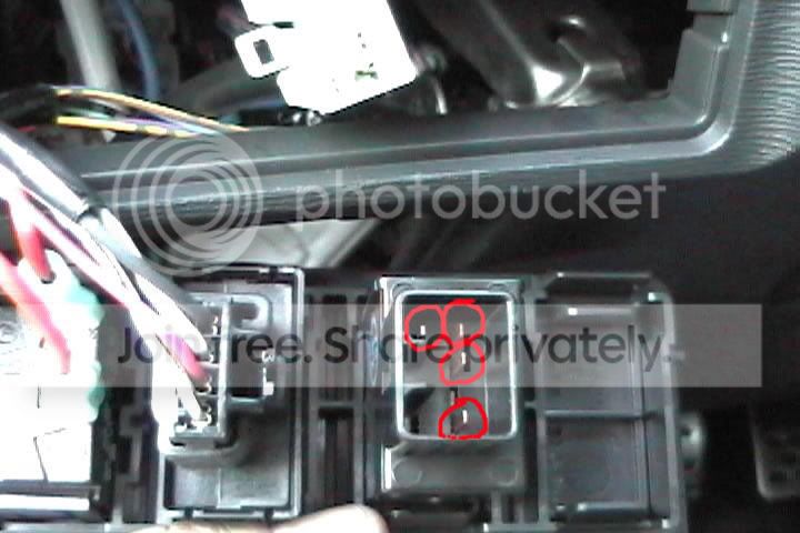

This is the back of the switch. I circled the 4 pins

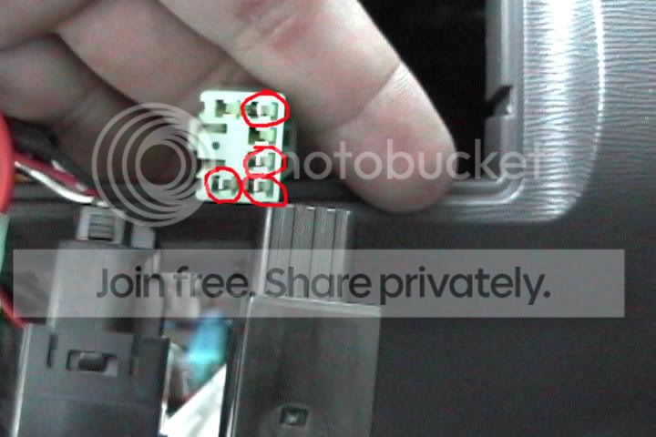

This is the connector that plugs into the switch. I circled the 4 pins
So if I get a new switch I don't know if I will be able to connect it. I would like to know wich of the 4 pins makes it light up.

Last switch like that I took apart had a green "condom" on a light bulb inside, and the actual graphic was just white. If you're thinking about changing the switch anyway, you should be able to "peel" that foglight graphic out of the switch (exacto / small screwdriver under a corner?) and see the light bulb or LED inside. It should be sticky enough to stick back down afterwards. As for the pinout, that would be tricky without a circuit diagram or disassembling the switch... (should be able to be done by pushing in on that tab you see in the last picture / prying the sides apart, then the one on the opposite side. The whole back part of the switch should slide out. Just watch out for small parts. )
