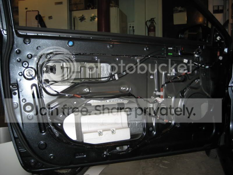

well i ordered some v1se from Chris(Mandos) over at Elemental Designs. he was very very helpful, i got 30 sq ft of the v1se and also got 1 sq ft of the V4. i did the passenger side first then when i got to the drivers side i figured i'd take some pics to show you guys. so the pics explain the rest....
ok first a pic of the door without the door skin or plastic liner(you can kinda see the deadener on the outer panel in this pic).

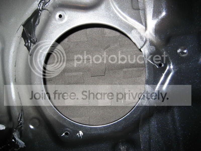

used the 1 sq ft of V4 for behind the speakers in sort of a checker board design(thanks chris)

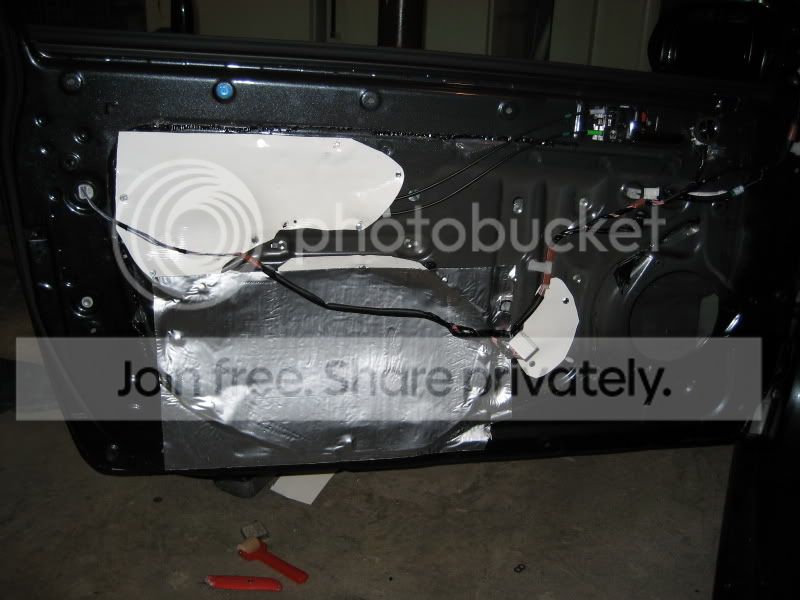

with the giant holes covered up(one with just the sheetmetal and the other covered with the deadener.
with some more deadener applied(almost done)

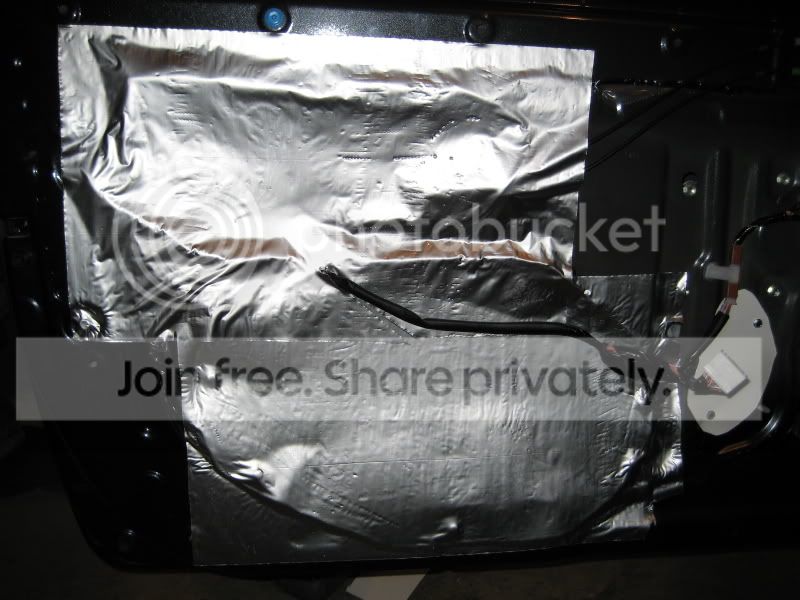

a final shot before putting the door skin back on
i used some deadener on the outer skin not a lot but tried to cover as much as possible(not a whole lot should be needed on the outer panel. then i covered all the gaping holes in the door panel with some sheetmetal and self tapping screws. then applied a good layer of deadener to the inner panels covering up the panel and the sheetmetal that i added. then went back and covered some areas with a second layer where i thought could use it. i still have a small amount left so i am going to go back to the passenger side and add a little more.
