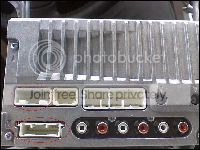

Here's a pic of the two connections I'm missing...
Anyone know where to get a harness for the other two? I'll even take suggestions on another way to do this...

i think one is for the stock subwoofer and the other is for xm. i don't believe you need those two. maybe i'm wrong.

I was told most likely they were for the steering wheel controls and ipod and aux in the center console. Either way it's looking like I'm gonna have to cut and extend. Not to much of a big deal but you can't pull the harness out to solder it so that means working in the car with no a/c and/or getting rained on.

there's one long narrow plug for the ipod,
and the other one is for the steering wheel controls, the aux, and the vss input
there isn't any way to extend those wires that i know of without cutting them.
look at the electrical manuals and it'll tell you everything though.. what each wire does.. what plug.. etc..
