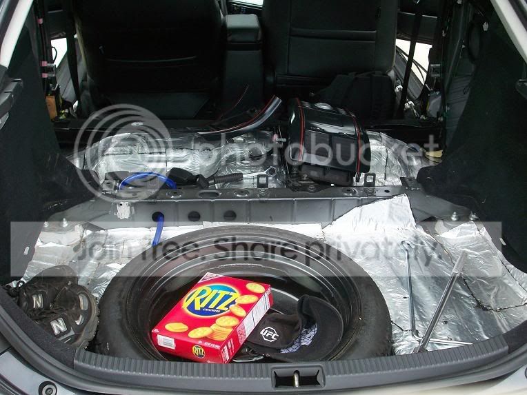

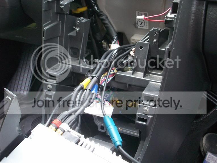

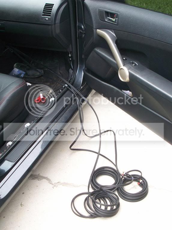

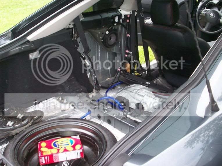

made a little progress, installed/ran my rca's and installed the 9887, completely forgot to grab my roll of remote wire, so ima have to pull it back out and hook that up, otherwise got the rca's/ipod cable hooked up... took a few pix of the coming progress. also pulled the back seat for ease of installation.
for those who didnt see the original post... heres the project
Headunit: Alpine CDA-9887, running active on imprint
Amps: 2 x Cadence TXA-600.4 (150x4 @ 4 ohm for mids/tweets, 600x2 @ 4 for subs)
Midwoofers: 2 x Mach 5 MLI-65
Tweeters: 2 x Seas Neo 27TFFNC/G
Subs: 2 x Dayton RS HO 10's
Deadening: eDead V1SE²
Enclosure: .7 net per sub @ 30hz using 3" aero ports
the victim...
