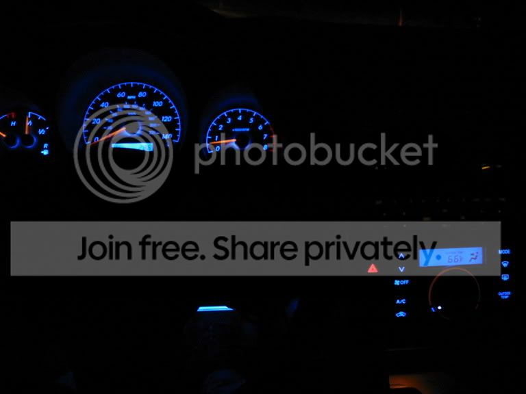

Here are pics of how they turn out once the center console circuit mod is performed:
I have not thought of the key light yet... that may be a cool one to look into

Guys here is a pic of my HU before my LCD Leds died on me.....sorry its a little shaky but you can see that the gauges and buttons on the head unit match up perfect..... THE PROBLEM is the Lcd Leds and those ebay ones arent cheap quality either....i have had them in there for 2 weeks now with no problems....of course at night i cant see my LCD screen but thats a different issue
