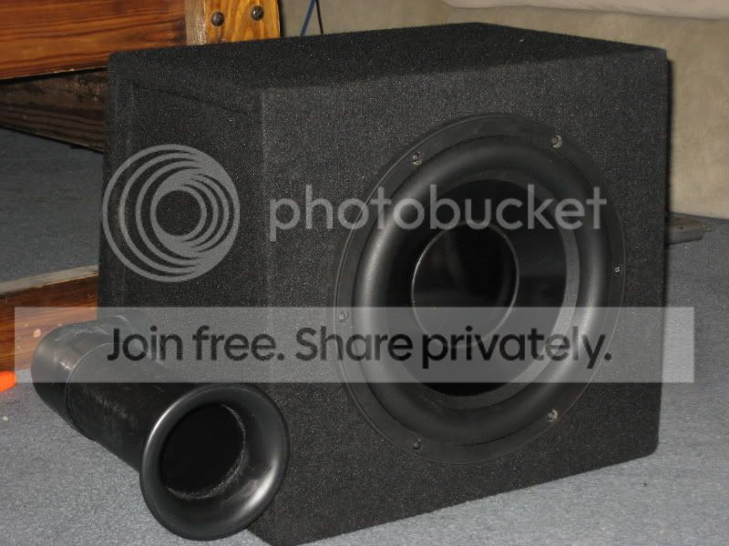

or you could do it like it did...
it might not look the best but it was really inexpensive, i think it looks unique, and it sure does sound good.
half of the 24" long port is inside the other half is outside(as you can see)
this was my quick inexpensive way to get exactly what you are looking for. same size, same sub, and tuning and everything.
the box was a sealed box that i got off of ebay(it is a good quality 3/4mdf box).
then i bought the port tubing, flared ends, connectors, and elbows.
then i cut a hole out with a jigsaw and stuck the port in and measured it out and BAM!
i know it might look odd but i'm not the first and only person to use a partially external port.

the box was on ebay $30 and the port tubing and end and all was from partsexpress.com, same place i got the sub. all i cared at first was how it sounded. but after getting it all done i don't mind the look at all.
this is the end result...

Hmm... if I ended up going that route... could you help me out by telling me the lengths of port tubing I'd need to make it 30Hz? Cuz I have NO idea how to tune it by my own methods lol.
Old Dec 31, 2007 | 10:34 PM
Tcguy85's Avatar
Posts: 2,434
From: Hyde Park, NY
if you can get the exact same box then yes, or even if it's slightly different i should be able to. mine is exactly 24 inches from end to end.
i'll have no problem helpin ya out at all man. if ya wanna go the exact same route i'll have no problem letting you use my design. :-)

you'll need to buy one or two pieces of the 3 inch port tubing, 2 flared ends, 1 connector and 2 90 degree elbows.
