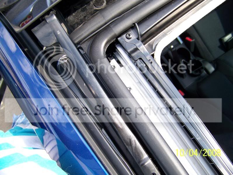

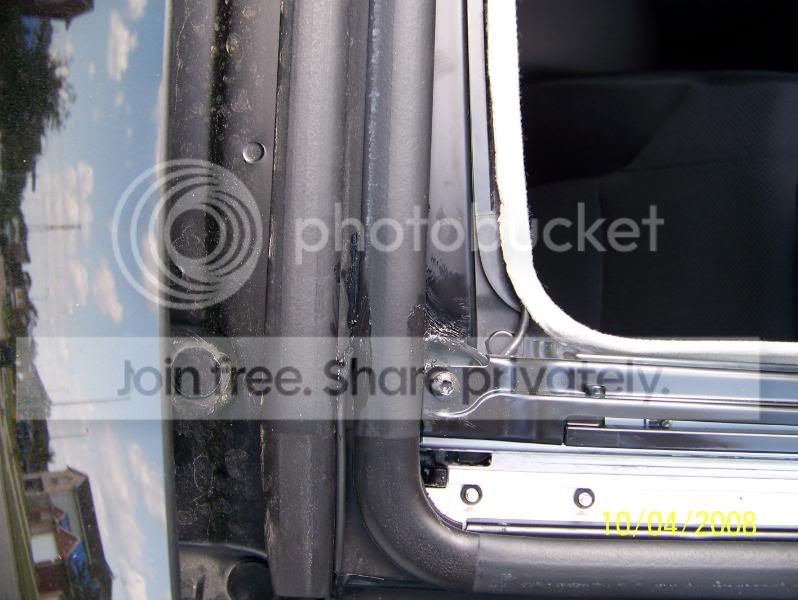

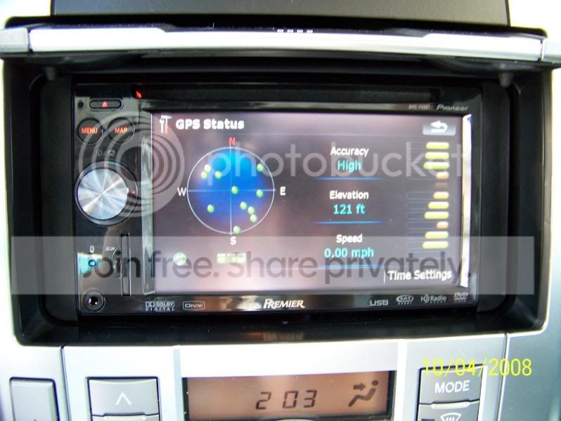

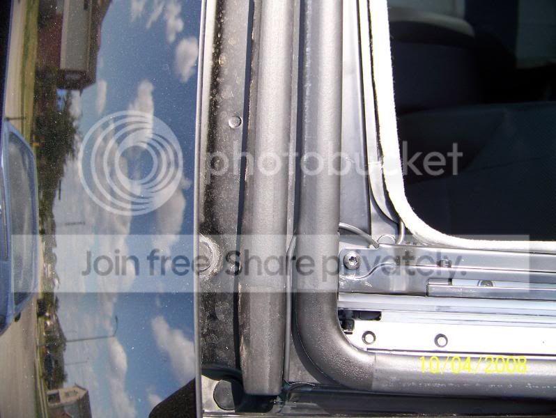

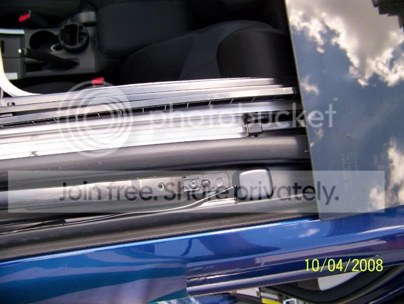

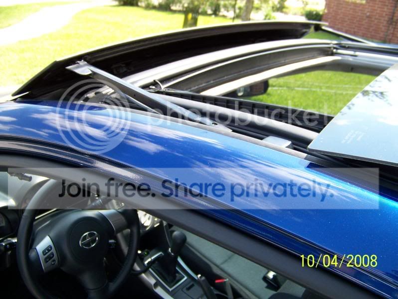

I know... it's been long. I got lazy lol. Here are the installed pics! Probably the hardest part was routing the wire thru the headliner and down the A Piller. That was a PITA. Thanks for the instructions, SquallLHeart!
I put some silicon where the hole was pierced. It's a little messy but barely looks noticeable after some clearn up. Been in rain and car wash and have gotten no leaks at all!
