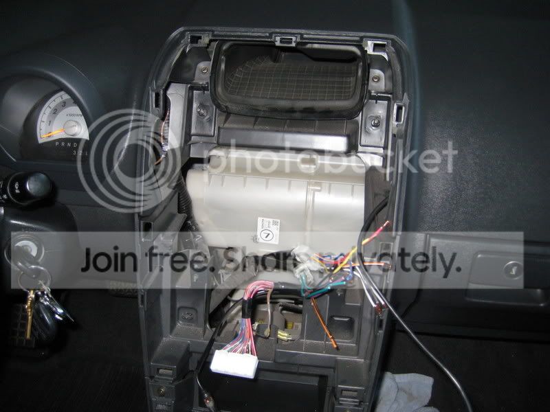

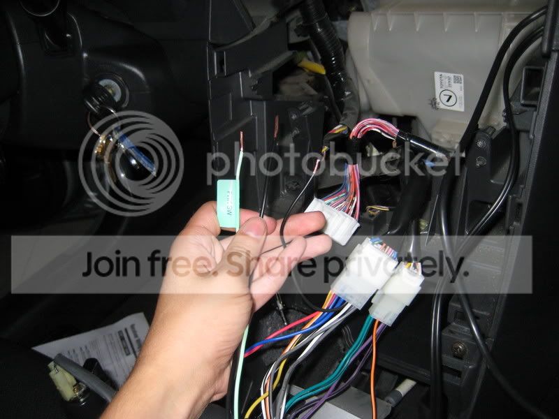

I have no clue were to ground the cables.. I got 2 black ends that are supposed to be grounded. So can I ground them in the same place!?
Here is so pictures please indicate where to ground the cables, Its supposed to be all metal surface right???

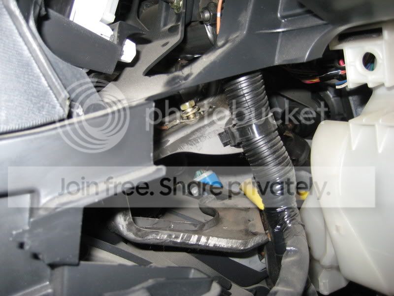

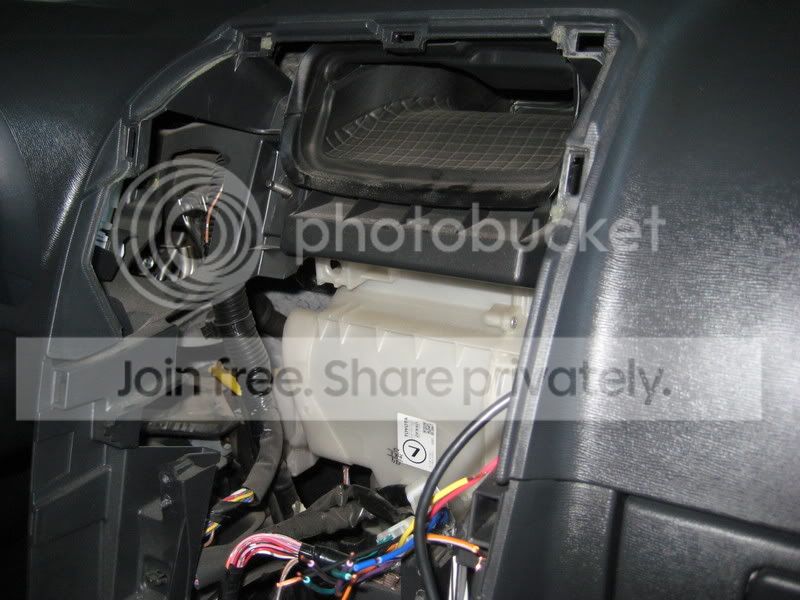

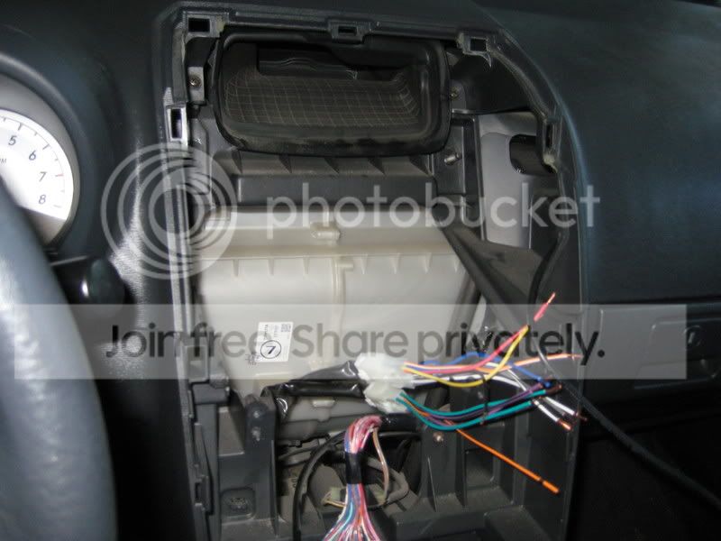

Im uploading pictures! Of the threee wires and the spot I think I could ground it on?? This is my first stereo intall BTW.

Ok I wanna ground the parking brake so I can watch movies while moving. Also I got two black wire ends, (one of the wiring harness from crutchfield and one from the wiring harness that came with the Double din!
Oh and that gold screw that I loosen that has a metal surface is that the ground spot. And if so.... Can I ground the three wires there? Or do I have to put together the two black wires and just ground the lime-green(parking brake)?
Another picture of install just put the wires together and used electrical tape to secure them.

You should connect those three wires together and everything will be grounded. The black wire coming from the crutchfield harness is connected to the ground that was the ground of the factory radio.
On a side note, only putting wires together with electrical tape will eventually give you problems. As the temperature goes up and down in your car, it cause the adhesive in the tape to wear out. I only trust soldering and heat shrink, but crimp connectors are also acceptable if used properly.

To answer your question Nexus...just connect those three wires together in a crimp cap and you're done. Like someone else said..the black wire coming out of the harness from crutchfield is connected to the factory harness which has a ground so that wire IS a ground. Connecting the Kenwood's ground and parking brake wire to that wire will get you what you need.

Oh..and don't leave the power harness plugged in like that with the bare wires just dangling there...that yellow wire is constant 12v and if it jumps over and touches the black wire or any metal, you're going to blow fuse(s). Be smart..do all your connections at a work bench and use proper connectors (NOT TAPE) and zip ties to keep the wiring clean. Match color to color...and don't hook up any orange wires (dimmer/illumination) as it could potentially harm your gauge/dome lights.

that gold screw is where is ground my parking brake wire for my AVn5100. works fine. I am freaking lazy, i just use tape to connect my wire.. But i twisted them pretty good , They are not going to fall apart. I work one other cars. They are fine for over 4 years.

do NOT use that screw it is not a good ground at all :<
