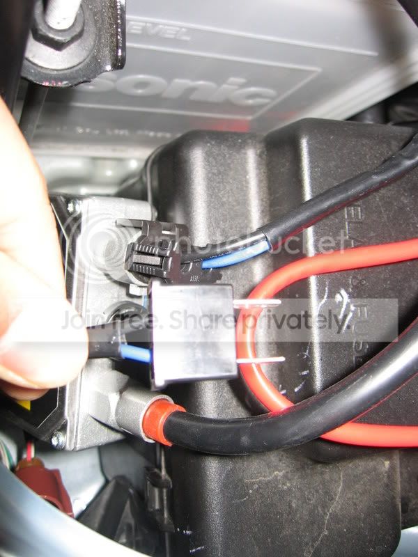

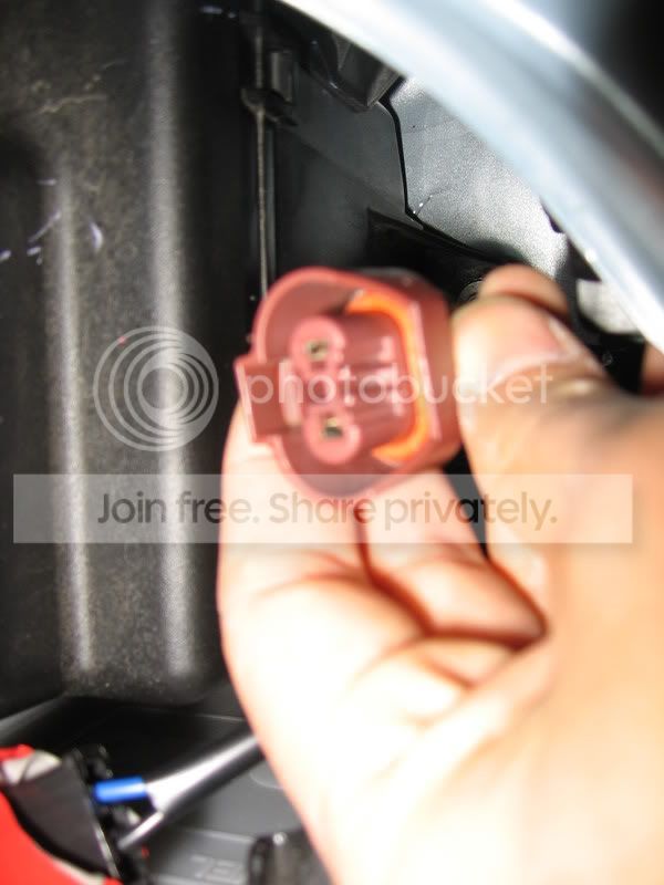

Hey guys, i have a 2007 scion tc and purchased a HID kit and i got everything set up except this one plug. It's the last black wire that connects to the stock wire harness. I can't get it to fit in.. or am i doing soemthing wrong? here are a couple pics.
[img]
[/img]
Do you put stick the 1st picture into the second picture?

i got this off another post on here. Just make sure you have all these hooked up and you should be ok.
If you find that all those connections are made, try turning them on. If it works, great.
I don't know which ones you got, but you might have a harness for the bi-xenon kit. If this is the case, the extra wiring won't be needed.
Good luck!

hey anybody notice that the stock harness wires look different from my picture and the other guys picture

It looks like you got the wrong wiring harness with your kit.

yeah you have the wrong wire harness. usually the 9006 kit comes with a connector that fits with the stock wire harness
